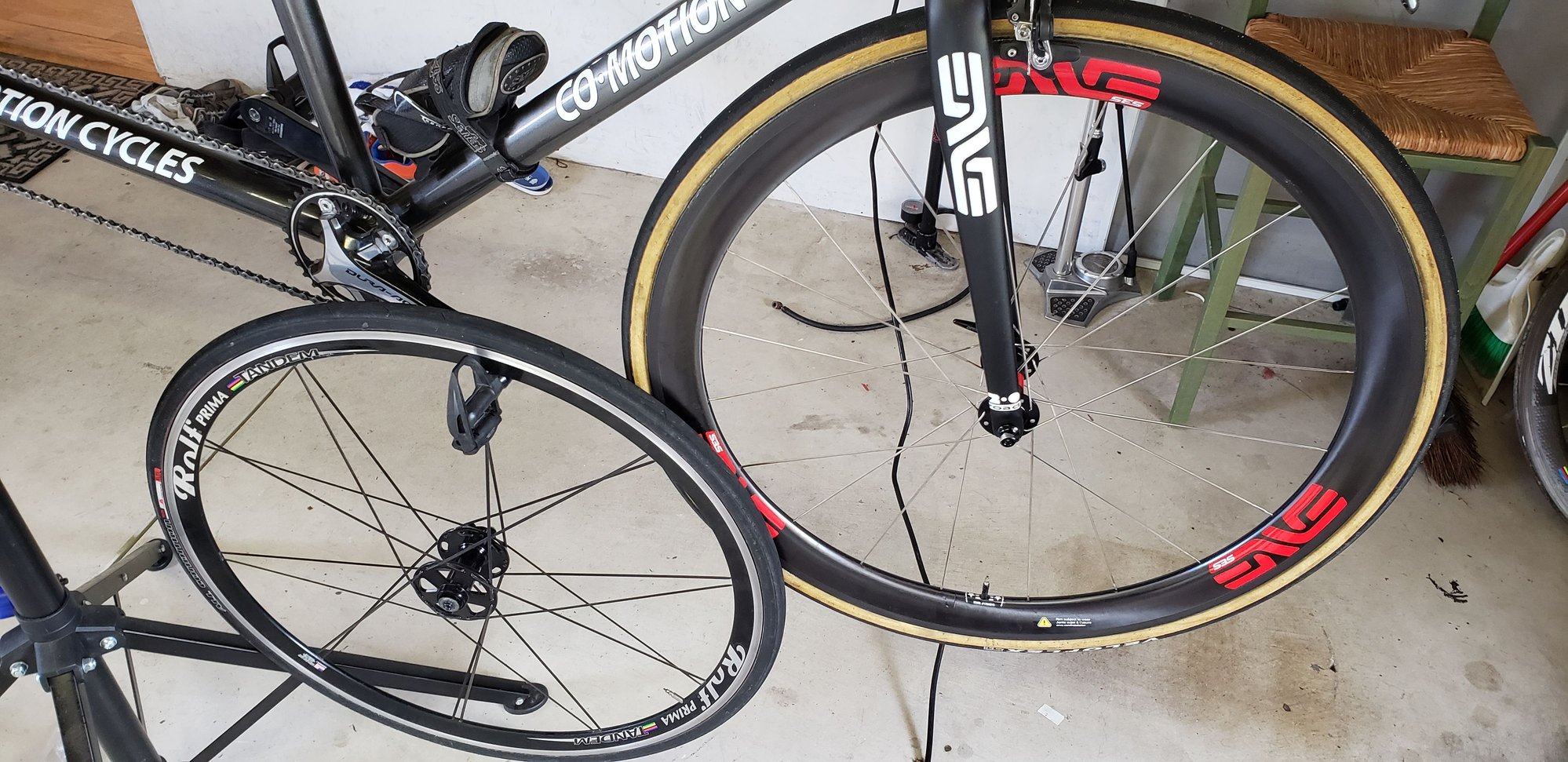

Remember these?

Obviously they worked well for your son, but I still wouldn't recommend them for the ham-and-eggers on this forum.

I ride similar, a bit heavier 20 hole Sapim cx-ray on 360# tandem.
