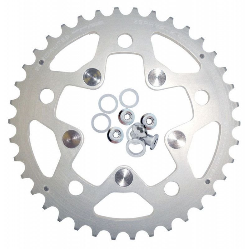

I have only seen a standard 110 bcd as low as 33T. It's not physically possible to get 30T on a standard 110bcd without hitting the chainring bolt or bolt flange. But the bikinGreen 46/30 110 bcd double set seems to connect the inner ring to the outer ring by a small tab without a chainring bolt, and the outer ring seems to have threaded holes to be mounted on the middle position of a triple crank, or on the inner side of the crank flange. But the photos don't show a closeup, so I'm not sure exactly how it works. You would also have to bring out the crank to compensate for the chainline.
How are you mounting it on your crank?
https://www.ebay.com/itm/bikinGreen-...-/123706511747
You can see a list of minimum teeth for common sizes of BCD here:
https://www.harriscyclery.net/articl...uide-pg157.htm
If you only have 110 or 130 BCD holes, you could also use the TA Zephyr K adapter (triplizer) for 110 BCD or Alize K adapter for 130 BCD to allow you to attach a 74 BCD inner ring, down to 24T. However, you'll have to mount this on the inner side of the flange. But I've only seen the 110 Zephyr in 36, 38, and 40, and the 130 Alize in 38, 39, 40, and 42.
https://specialites-ta.com/triple/19...denture,38-dts
https://specialites-ta.com/triple/20...denture,38-dts
Stronglight also makes something similar for 130 bcd, for 38,39, 40, 42, 44T, but strangely, the photo of the silver version doesn't show any pins while the black version does show pins.
Stronglight - Road Type 7075 "S" 130/74 mm
https://www.spacycles.co.uk/m2b0s149...D-Adaptor-ring
I don't know whether or not the bolts on the TA are permanently attached. But the Stronglight seems not to be.
