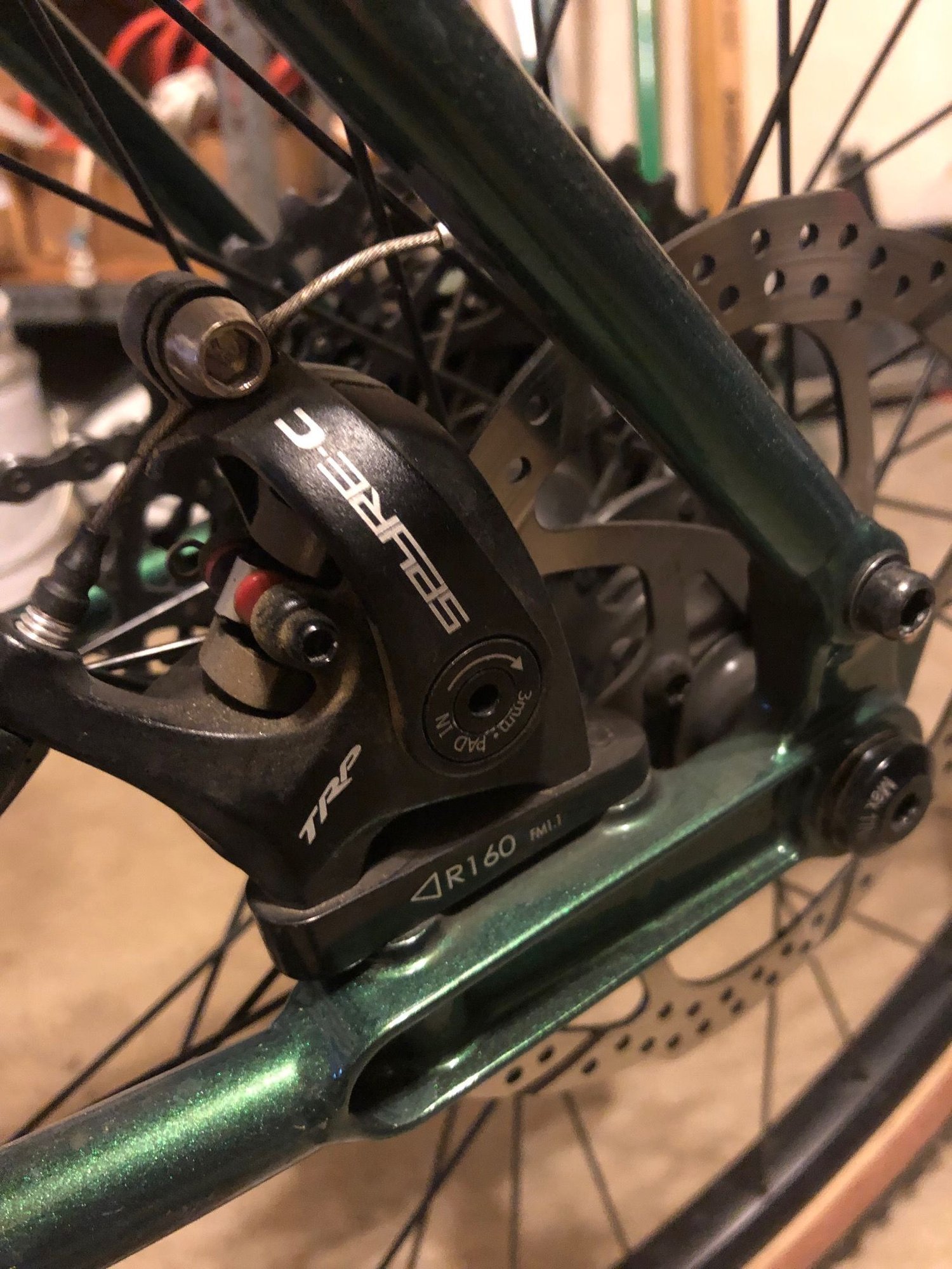

Just the frame. I am transferring all the parts from my other gravel bike which is rival 1. Hopefully I can use my post mount rival hrd caliper on the rear with the adapter. Not sure if the Rove is one of those frames where the flat mount holes are way too close to the chainstay triangle.

Here's a pic of mine if that's helpful.

Ohh that's plenty of clearance, thanks for the pic. On my old Slate the flat mount holes were right up on the chainstay triangle so you were screwed trying to use the post mount adapter. I dig that Kona includes threaded thru bolts for the axle vs the quick release thru axle.
