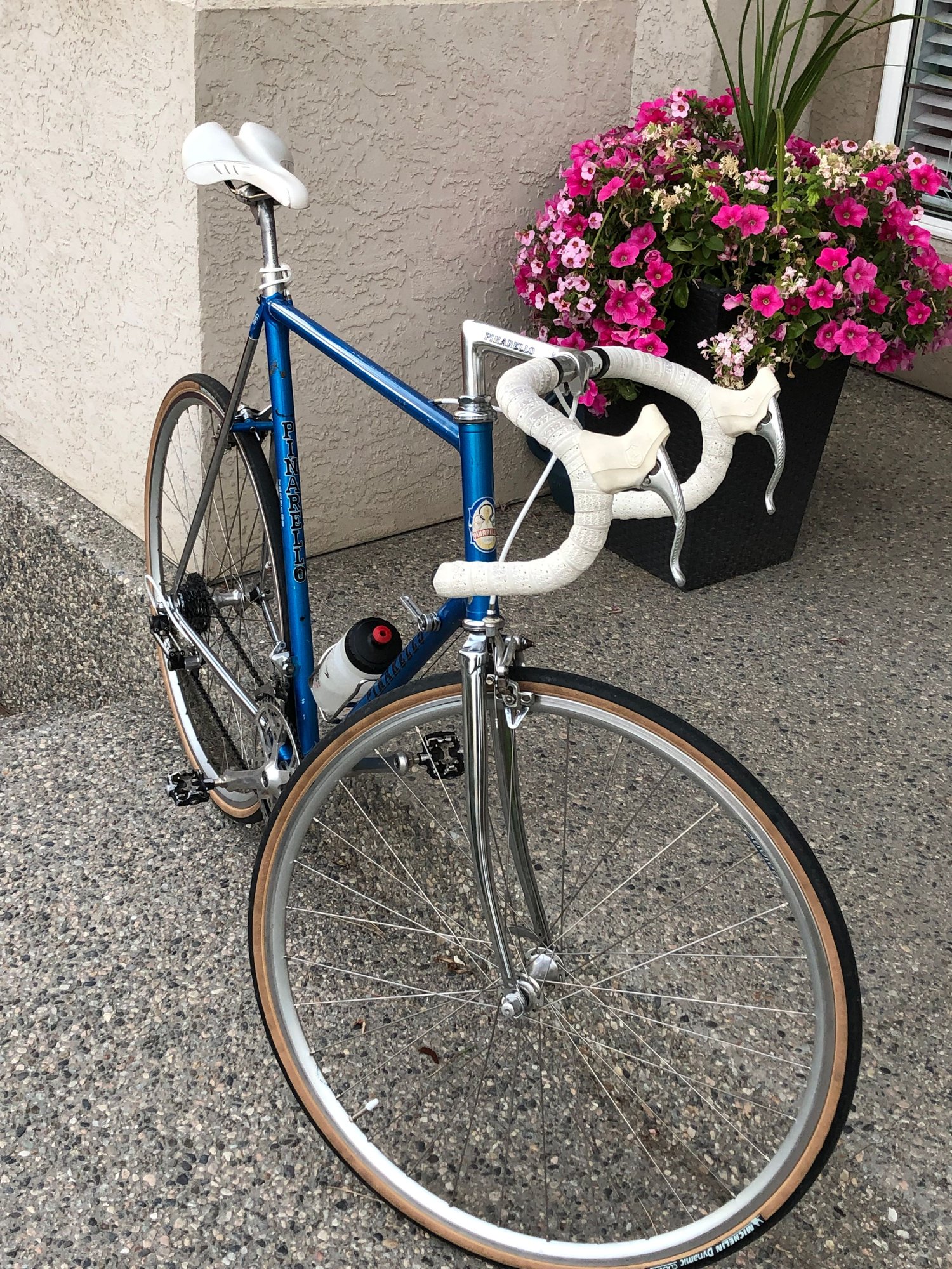

1. When I restored this I did not touch the original paint or decals. There is a fair bit of flaking on the decals. any ideas on how to preserve these best?
2. Looking for a recommendation on a vintage style frame pump?
3. Just curious if anyone knows why the head tube was so long on this bike?
4. Aside from the pedals and seat would this bike qualify for a l’Eroica event? Have any of you done one and was it worth it?

I don't think they're original, to be honest. The give away is the seat tube bottle mounts - when these were employed the seat tube decal was split in two with 'Pinarello' on either side of the tube. Like this:
(I've also never seen black decals on a blue frame come out of the Pinarello factory, but perhaps they're out there.)
Do you know where the original fork went?

I dont understand the question regarding the length of the head tube. It doesnt look long to me- its quite traditional in length, given the frame size. There is very little length above and below the adjoining tubes. Nowadays, you can get lugs with more room above the top tube to reduce the number of spacers needed on a threadless stem. Having one such bike, its quite obvious when that style lug is used.
If you want a shorter head tube...you need a smaller bike.

I am not sure where the original fork went. It may have been used on another bike. I would actually like to replace this with an original. I have not been able to find one with a steerer that is long enough. Besides ebay, any idea where to look?

Ebay is your best bet, but try the European vintage bike shops - I did find one in Germany, but it wasn't quite period correct and their asking price was astronomical. Also search ebay.it for Italian only items - you'll just have to convince them to post.

That is one huge bike. (says me who's only 5'6")

That frame is huge. Enjoy the bike. Here's mine (bought used in 1992) in size 54 (ie smallish). Your decals are definitely not original. Mine were flaking when I bought it and only got worse. I remember picking up the bike back then by the seat tube and ending up with a hand covered in black flakes

I am about 6'1" with very long legs and arms! The bike fits remarkably. I appreciate the advice on brake cables. My apologies on the newbie question but do "non-aero" levers basically mean the cables are not routed underneath the bar tape?
Also, I live in the mountains so the 52/42 with an 8 speed means I don't ride it as often as I would like. What are the options for better gearing while still keeping this vintage?

Regarding the gearing, your crankset has a 116mm bolt circle diameter (BCD), which means you can thoeretically go down to a 36t inner ring. Finding such an item may be a challenge, see this thread for that discussion.
Edit: A quick Google search shows a 37t ring in stock here. No idea about the seller.
If this is your first vintage bike, then I am guessing the head tube looks tall because you are used to oversize tubing found on a lot of modern bikes. Oversize tubing gives the illusion of a shorter head tube. I am 6'-4" so I am a bit sensitive to it. Sometimes the taller headtube can take away from the proportions of the bike. My opinion of course.
Regarding the fork, I think what you have looks great and finding an original that doesn't have finish or pitting issues, well, sometimes you just have to pick your battles. Be thankful the chrome on yours looks great, and do what you can to keep it that way because there is no easy (cheap) fix

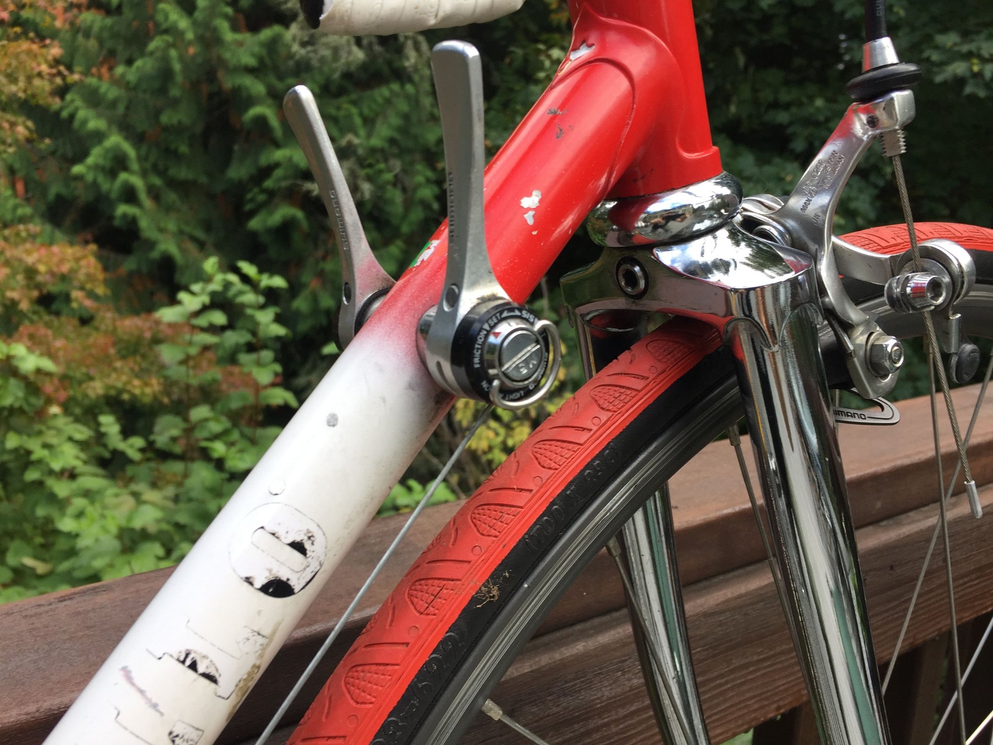

I have an '85 SL framed bike with fully chromed rear triangle. Measures 58X57 (ctc) with a 16cm head tube.
Mine has practically zero decals. It's a proof of authenticity for il cognoscenti.
If you find a source for replacements forks , PM me, the Tange on mine must be a track-like fork = very twitchy. But the bike tracks well no-hands with no counter-balance input.
As purchased, still a project without clear direction.

This bike has had front end damage, but rides straight. Replacement fork has too little rake, bike needs a longer front-center - not sure if a re-rake of Tange fork will be the best solution.
Tires, when I get a round tuit, will be black, already plenty of color going on. Longer term, if the front end can be modified to deliver the ride I want then tubulars and silver Italian components. No red tubulars, to my knowledge. My only frame that is full SL; thus the desire for an SL, even if not Pini, fork.
