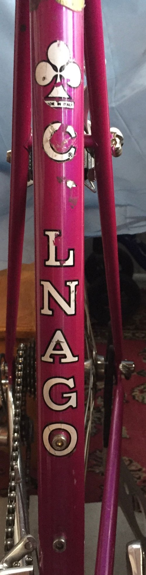

My 1983 Colnago Super with all the traditional symptoms of frames from the same era as the OP's. Also I didn't get into depth on seat stay tops because Colnago used a number of different styles on those frames:
Rear stays to dropout treatment
My Colnago Technos with the same rear stays to dropout treatment as on my Super.
This Technos has the same rounded seat stay tops as the OP's but with a logo an the fancy lugs. Note the fluted/crimped oversize top tub with a bulge in the middle.
There is a slim possibility that the frames are Colnago Sport which were farmed out products. EDIT (except for the crimped tubes per @CliffordK post)

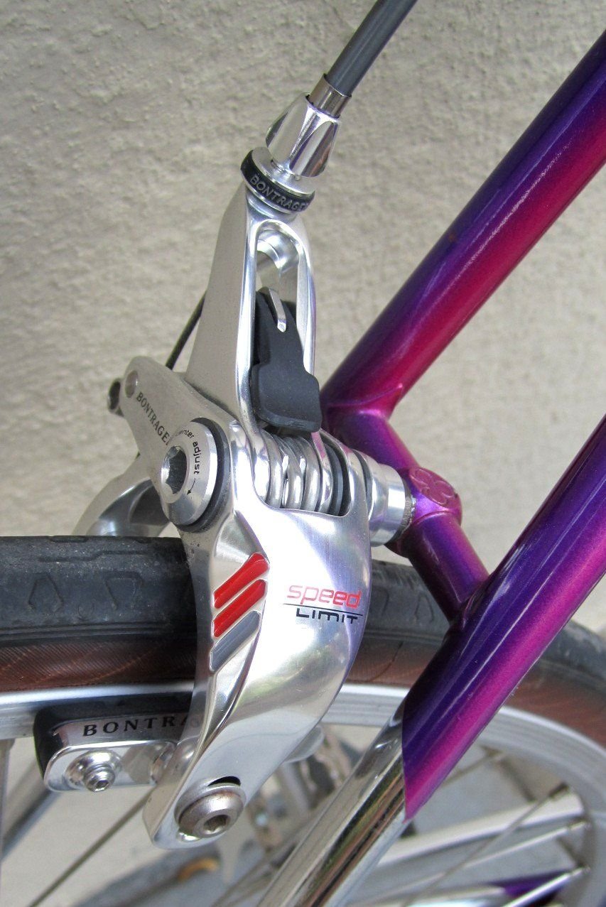

verktyg That is a hefty brake caliper! is the brake bridge strong enough to support it? Bontrager version of a Monoplaner?
SJX426 is offline
Old 11-11-19, 07:38 AM
verktyg
verktyg
verktyg's Avatar
Posts: 3,406
Mentioned: 166 Post(s)
Quoted: 744 Post(s)
Liked 403 Times in 269 Posts
Bontrager Speed Limit Brakes
I got this prototype set of Bontrager Speed Limit brakes to evaluate. I found a "little" problem with the QRs... They could come open in use. As I said they were final prototypes and I'd heard the problem was corrected when they went into production.
Whenever I have to "lock em up", I like to start to feel some retinal detachment - the Big Daddy Don Garlits effect!
These are the most powerful brakes I've ever used.
I bought the frame from Ed Litton. He took it in for a trade on a custom frame and had it boxed up for years.
I'd never seen a bike like this one so I went full tilt weird on the build with mostly Shimano Deore XT MTB components. It's super light and climbs like a goat.
