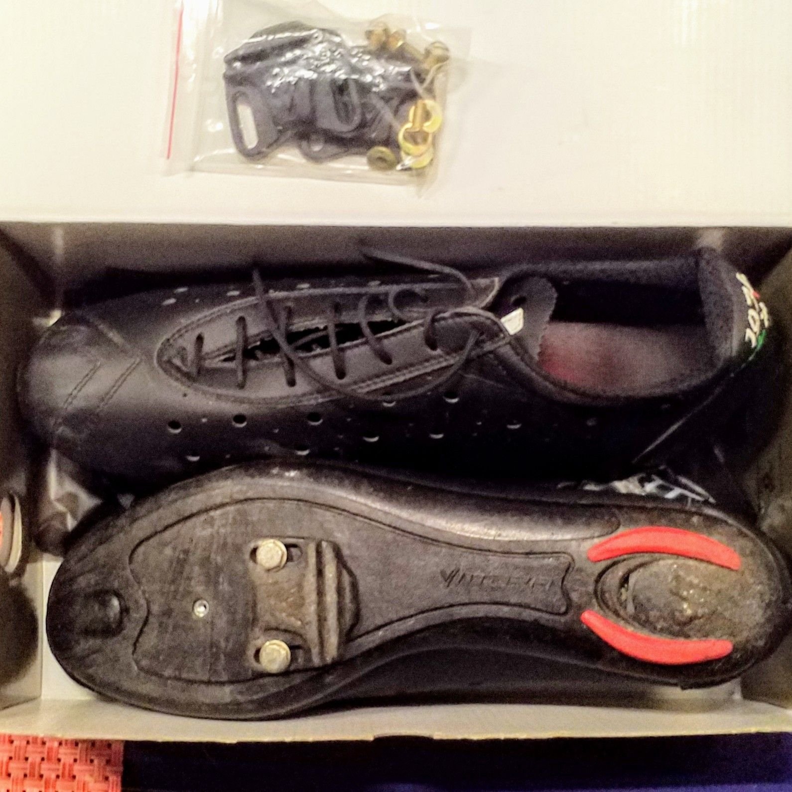

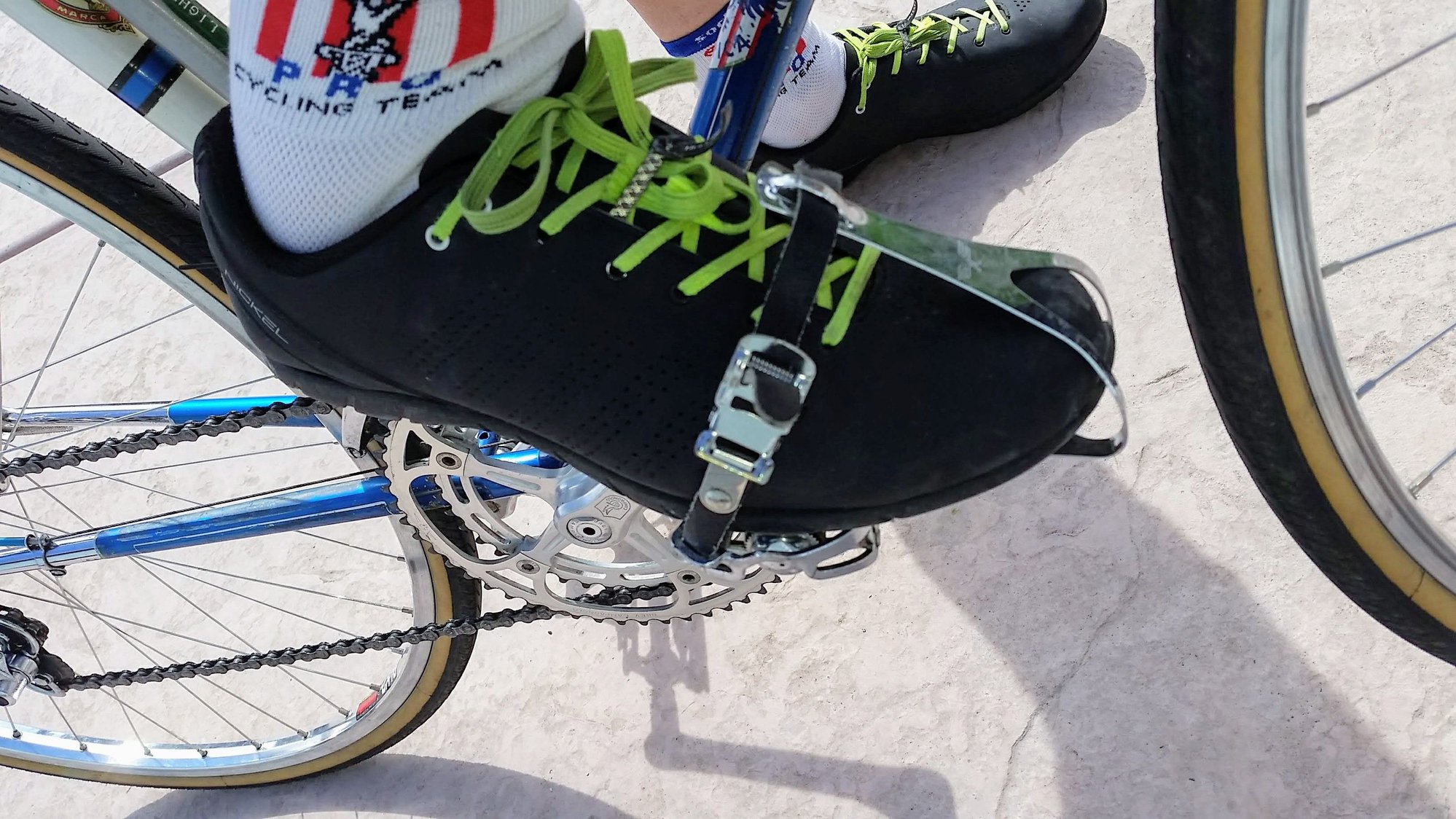

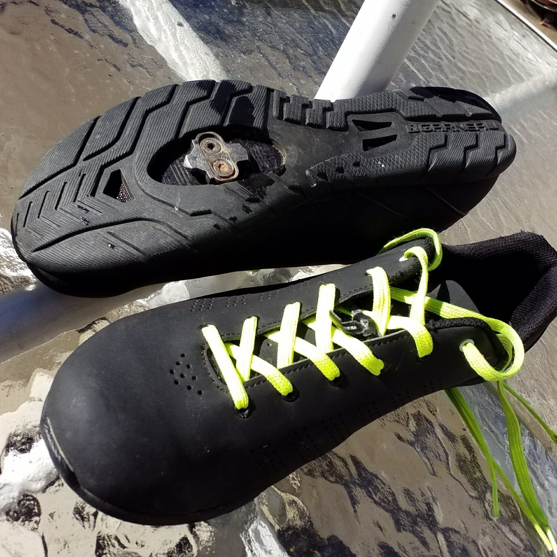

I used plastic cleats on my first Eroica ride. I think it was 2016, a drizzly day with lots of muddy trails. I stopped and used a screw driver to clean the cleats several times, because they would not engage. Twice, I fell on the same knee (still hurts) when they wouldn't disengage, even with loose straps. Conversely, on a washboard, dirt section, my feet actually came out of the pedals, even with cleats and straps. BITD, I used to race with metal cleats, straps and clips, but our races never included repeated stops and starts, walking or riding on mud or gravel. I did spend some time filing the plastic cleat slot into a bit of a "V" by beveling the sharp edges of the slot, but couldn't tell much difference. I tried half clips from VO, and even ugly black plastic mtn bike type toe clips. The shoes I was using are Vittoria 1976, with three hole cleat mounts, and very slick soles, not good for walking. Unless you are some kind of Superman, you Will be walking at some point. I now use Louis Garneau Nickel SPD shoes, where the cleat location is recessed, giving a flat, rubberized sole, good for walking, and not bad for pedaling with toe clips and straps. I have considered going to a shoe shop and having ribbed rubber soles put on the Vittorias, but so far the LG Nickels are working (without cleats). On an all pavement club ride today, 40 miles, with a couple of nasty, steep, but shortish hills, I had 4 Strava PRs and a 16 mph average. I even had one best PR segment over a bunch of pretty good riders on modern carbon, with "real" pedals, so I guess this setup is working, even with a 70 year old rider. Good luck with your cleats, but they just didn't work for me.
My current set-up, with washers between pedal and toe clip to get more toe room.
The Vittorias I started with
The LG Nickels, not as pretty as the Vittorias, but work for SPDs 11 months a year, and dreaded toe clips and straps 1 month a year for Eroica. They are half the cost of Vittoria, but infinitely more useful.

Looks like those fit well on a NR pedal. Do you mind my asking what size they are? I bought some 510 cycling shoes in size 9 and they are wider than the pedal reminding why they are quill pedals. Then some 30 yo Avocets in 9 and they are right for length and fit on the pedal but narrow on my feet but might work out depending on how they change to accomodate my feet -- they seem to be pretty flexible, so might work.
The LG Nickels are Euro 47s (US 11) as are the Vittorias. I had to space the clips forward with a few washers to get toe room in the clips. There might be larger clips available, but these were on sale at the Performance close out sale, and I only use them once a year.
Slightspeed is offline
Thank you, that's good information. My size is probably 43 - 43.5 so these shoes would probably work for me. I have some 17 yo Shimano mtb shoes which are only slightly too wide but they are starting to pain me where the cleat goes, which I don't use. Also, the tread is a lot nubbier than what your LG shows. Back in the 80s, there were comfortable "touring" shoes with rubber soles -- Cateye and Avocet are two brands we used, but it's not easy to find somethiing comparable these days. Recent threads indicate that the Italians and Spaniards and Belgians are making really nice stylish products but jeez, I'm a simple guy.
edit: and spacing the toe clips forward, I never would have thought of that. I'd just bend them and hope the didn't break.
I just noticed something highly significant about that photo...you have some kind of spacer between the crank and the pedal that apparently makes it so that the quill doesn't dig into your sole. Where did you get those? I've never seen them before.
Edit: I just found them on amazon as "pedal extenders". Apparently they're quite common. Think I might get some since the quill always digs into my foot.
These are called "Knee Savers". I have a gimpy knee, and these give the knee a better angle as you pedal thru. I have them on several bikes. Some don't need it if the BB axle is long enough. As for quill pedals, I can't see how they would help you with a foot comfort issue with the pedal, but it does keep the inside edge of the leather strap from rubbing on the crank arms. They come in various lengths. There are also cheaper knockoffs available on Ebay, as well as Amazon. One complication is that the male threaded end is closed at the end, so you can't access a hex screw if your pedal has that kind of attachment on the axle. These old pedals have wrench flats, but not all pedals do.

Originally Posted by daviddavieboy
I have a bum knee and a little float is a must, as well as the ball of my foot ahead of the pedal axle.
If you need the ball of your foot ahead of the pedal spindle, it is likely you will need to space out your toe clip away from the pedal cage with washers. See Slightspeed's pics for the example. The conventional fit places the ball of your foot directly over the spindle, and toe clips are sized accordingly.
FWIW, muddy roads and slot cleats really don't get along that well. BITD whenever we'd ride a fire road or someting, I'd carry a small screwdriver or something in a jersey pocket. This was used and used often for digging mud and gravel out of the cleat slots. It boggles my mind to think people used to cyclocross with slot cleats, albeit special ones.
Salamandrine is offline
I have already sorted out the toe clip with a larger one. There is now about 1/8" clearance at then toe. I think a wise option if the ride is going to be muddy is remove the cleat altogether or bail on the heroic route and stick to the pavement.
Thank you, I just ordered some. Q-factor is quite important and this is something I may have too look into. The longest ride I have done with this bike is only ~50 mi and have less than 500 mi total riding on it. For thne next few weeks I will be doing trainer rides on it and will have a week or so of outdoor riding as I drive across the country.
Also, thanks ALL for the great information. As some mentioned my knees, I will add that my peddling form is good and experience no swing in my knees and neither any harsh pulling or pushing on the pedal but fluid on the stroke. I think the cleats I was using might have been walked on a little too much and closed the gap as I swapped them for a brand new set and they engage/disengage quite nicely.
