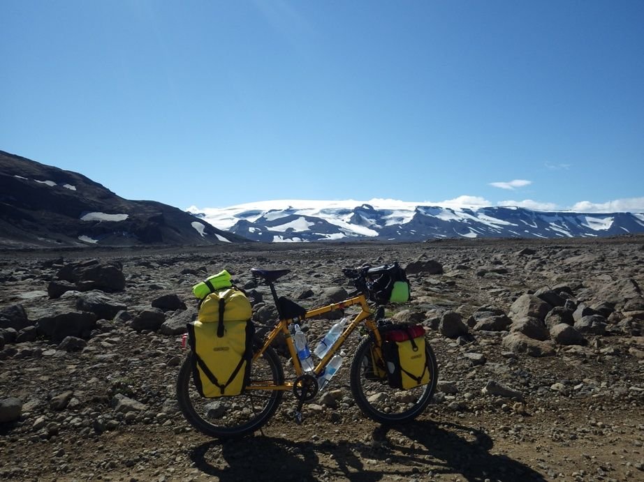

This is my current road touring bike. At the moment it has 700x32 Gatorskins.

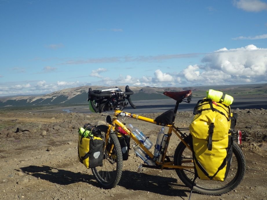

This was my loaded tour bike for a while. A 90's era rigid mtb that was repurposed for loaded road touring. It had 26x1.75 Schwalbe Marathons
On this trip I saw the limits of that size of tire as I couldn't ride the sand at that width. I also had problems in another swampy area.
