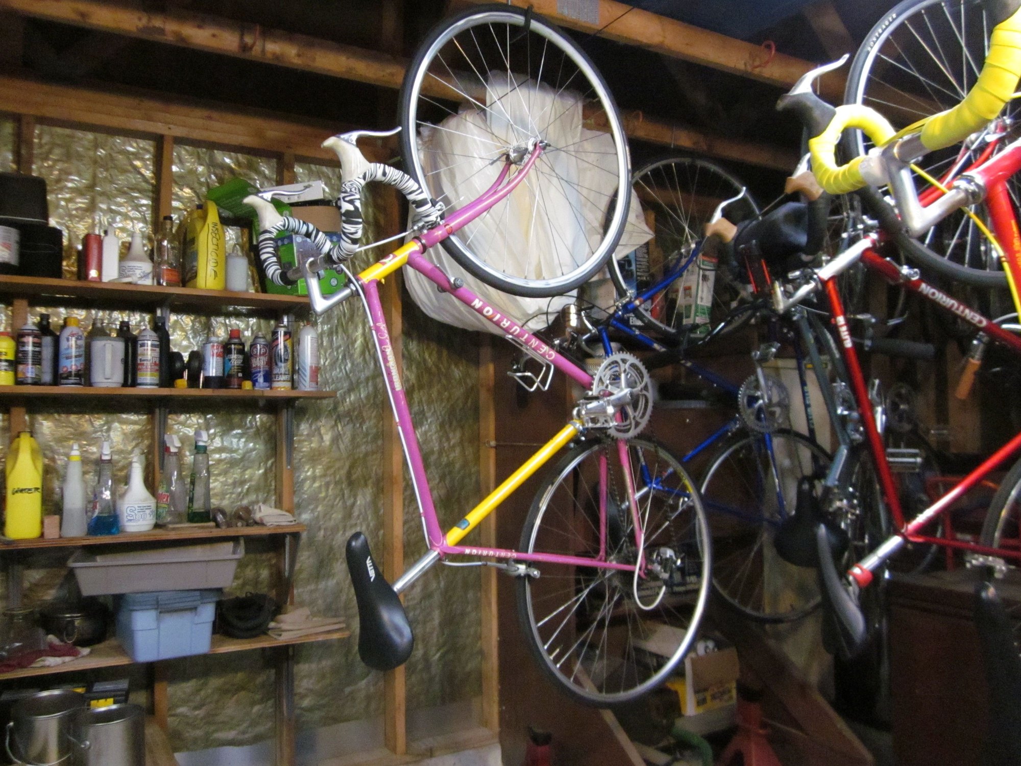

I put a set of new Vuelta XRP 130mm racing wheels on this 1987 Ironman. I put a 7 speed freewheel with a spoke protector spacer & a set of cheapie 2X7 Microshift brifters on it. Dropped it's weight down to about 21-1/2 lbs. Rides like a dream.
edit: Also upgraded to a 9 speed Shimano Deore M-591 RD and, extended range 32 tooth Sram cog set.

I'm official! Pictures...
last pic are the problem child wheels

This one is all original. Completely restored w/new tires & everything.
the white seat and handlebar really works on this bike. Easily my favorite colorway, but I'm bias

This is what it looked like to begin with.

what it looks like now.
