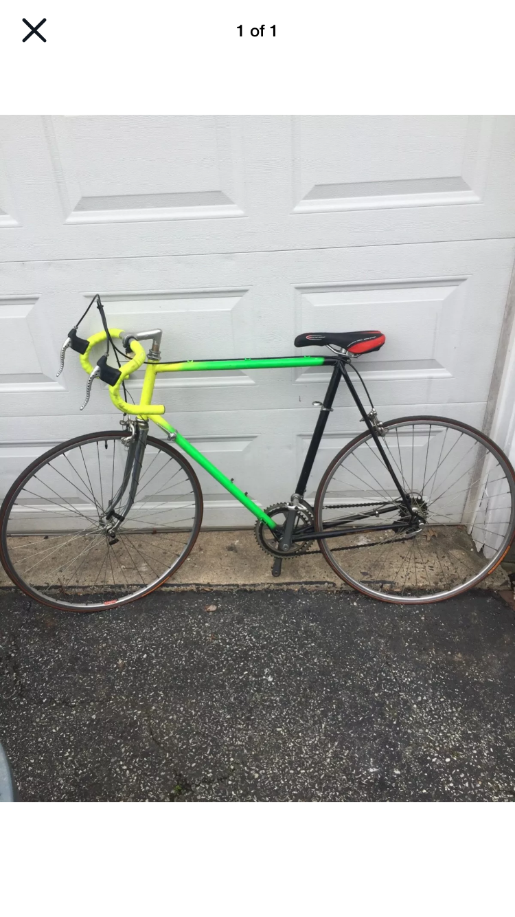

Hello,
I recently picked up this bicycle for less than $100.00; however I am not well versed in road bicycles. I'm a long time Mountain Bike guy, who typically goes after the Fat Chance, Klein, etc 80s-90s bikes. Anyway, this had an interesting paint scheme similar to the bikes I just mentioned would typically had, and I knew that Campagnolo was generally a top end component group. That said, this bike has no branding or logos that would inform me of what I purchased. I've been googling and searching on how I could identify what this bike is, but have come up with nothing. Any help would be GREATLY appreciated!
Fork: Tange "TF"
Wheels: Araya rims
Hubs: Joytech
Headset: unmarked, I believe a Tange headset
Brake calipers: Modolo Corsa
Brake levers: Mafac
Handlebars: 3ttt
Stem: quill, SR Forged
Crank: Campagnolo, I believe "Victory" in a graphite finish
FD: Campagnolo
RD: Campagnolo
Seat appears to be new.
I think one of the interesting parts, or could be help in identifying, of the bike is the cable routing for the FD on the non-drive side (picture below).
Serial number starts with M2.
The bottom bracket lug/shell has a little more detail than the other lugs.
The seat stays seem like there wasn't much thought put into them.
Any thoghts? Thanks!

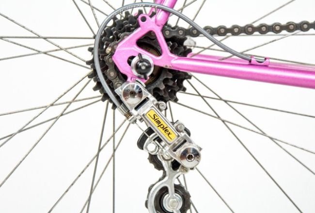

That's a Vitus rear dropout, so my initial reaction is French origin or a neighbouring country. I don't believe these dropouts were available earlier than the very late 1970s and they were used into at least the early 1980s.. It's probably no newer than that based on the cables routed over the BB shell. Workmanship is mass production level. Depending on the exact era, this could be upper entry level to lower mid-range. Seat post diameter? Seat tube outer diameter? Threading of BB cups?

It looks like a respray with a mix of parts, agree with T-Mar about "mass production".... also I am wondering what that line on the TT is near the seat lug, tape or?

Looks like a mishmash frankenbike rather than a production model. Rattlecan paint job... there appears to be some heat caused paint damage under the black on the top tube at the seat lug???
The frame was probably a mid range model. The Tange fork is probably a replacement???.
Have you ridden it yet? The seat is way to low for that size frame usually indicating that it was too big for someone who was riding it.

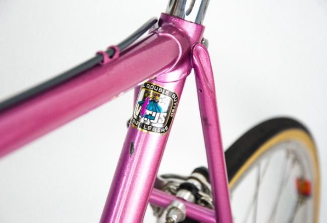

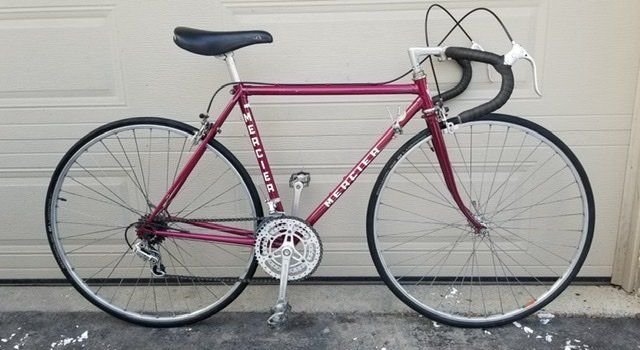

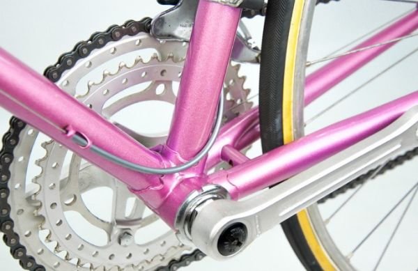

This is a almost perfect match for a Mercier. Same dropouts, crimped stay caps, lugs, BB shell, cable stop for front derailleur on down tube, lack of shift lever bosses, etc. I've seen this configuration with various tubesets. Serial number?
T-Mar is offline
Woah, best match I've seen so far!!!! thank you

Looking at the crimped stay caps, they are different.
Note that the rings are unique to the crank BCD (not anywhere near standard).
SJX426 is offline
Old 03-26-20, 11:59 AM
T-Mar
Posts: 19,462
Mentioned: 507 Post(s)
Quoted: 3131 Post(s)
Liked 550 Times in 445 Posts
The length of the crimp is different but that's variable depending on the set-up of the tooling.

The M-prefix is consistent with Mercier manufacture. I believe the first numeral is the year of manufacture. However, take the tubing decal in the photo from my previous post with caution. Like I said, this frame design was manufactured with various tubesets. Here's one with with hi-tensile tubing.
The diameter of a proper fitting seat post will be the best indicator of the tubing grade. The post appears undersize because the ears are pressed together. This could just be deformation of the ears, as there appears to be a much wider gap in the cinch slot of the tube itself. For a proper sized post, the cinch slot in the seat tube will be about 0.6mm narrower at the top, than at the bottom.

The BB shell has the rear derailleur cable tunnel on top of the BB shell, so any drewed chainstay cable stop would also have been on the top.
