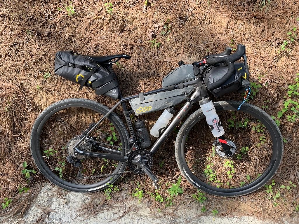

I'm running Absolute Black 46/30 chainrings on Ultegra cranks. Oval rings feel quite different to me and I'm not sure why others can't feel a difference. I love them.
The rear has an RX-805 GS derailleur and an 11-42 XT mountain bike cassette. A 1.85 mm spacer was used behind the cassette and the B screw was reversed.
Sizing the chain is easy as it uses all 116 links.
Low gear is 19.5 inches.
The photo below gives an idea of how it looks in the lowest gear as well as why it was done.
-Tim-
