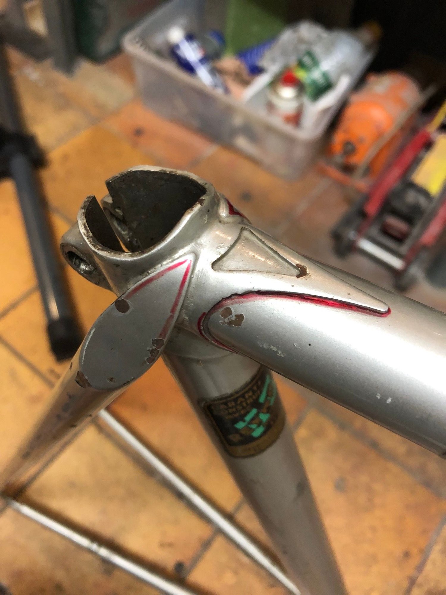

I found a nice old French frame from late 70's built in Reynolds 531 tubes.
very light : frame and fork 2,3kg
(sorry I don't know the weight in pounds , I'm French ^_^)

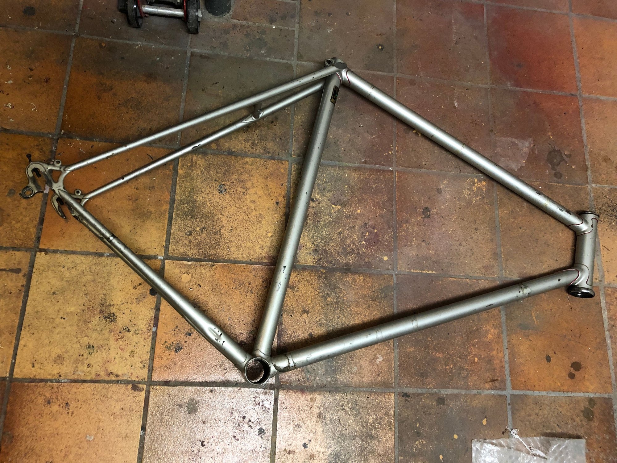

I striped down the paint and applied a rust converter from Fertan inside and outside to protect it
(great product)
some pics before
Frame is 3,5 lb

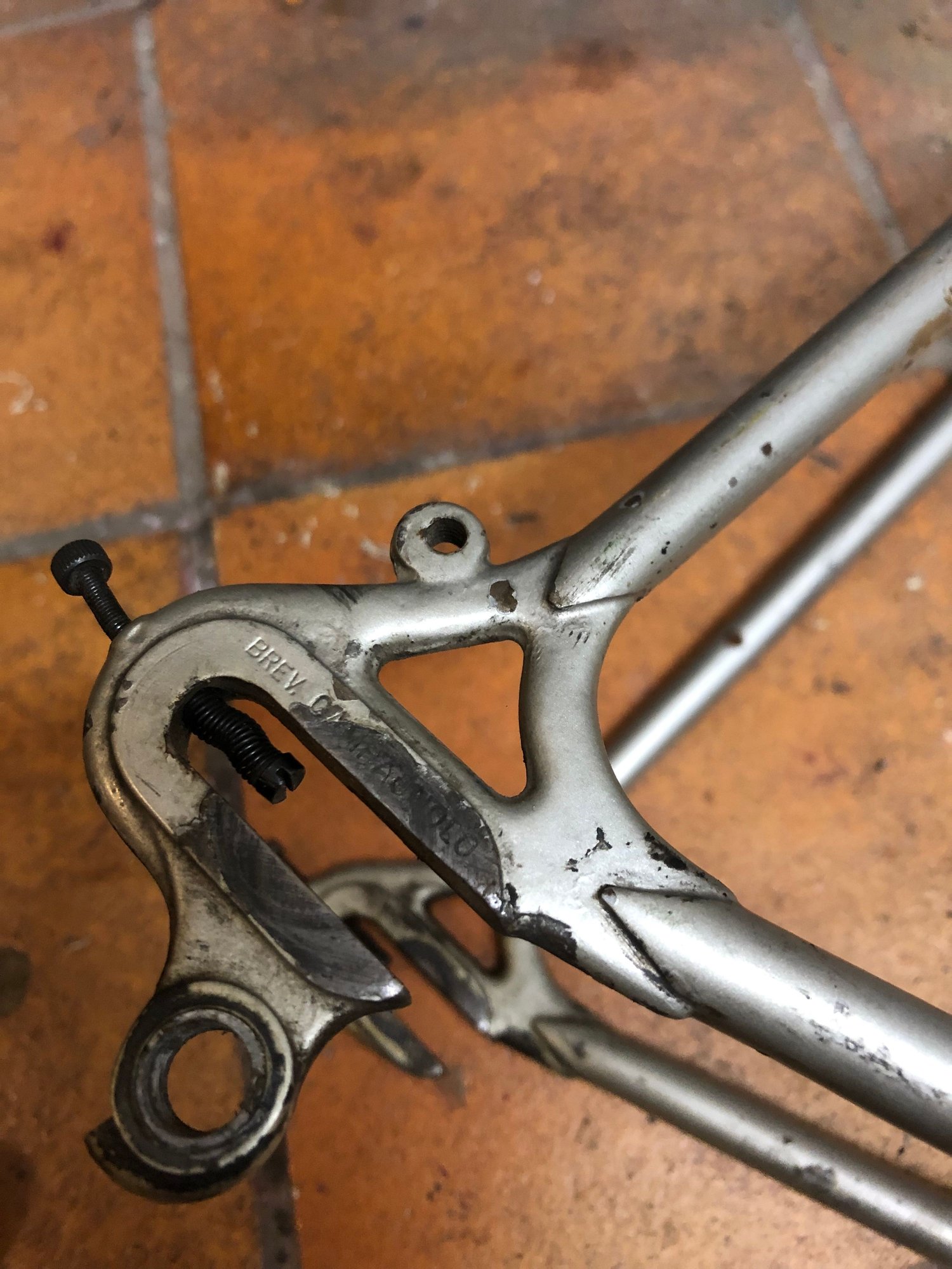

Campagnolo dropouts
I painted myself with spray cans (2k painting and lacquer)
Wet sanding to 1500 and 2000 then polishing with meguis compound paste.
result is great but not as resistant as epoxy coating

After stripping the paint

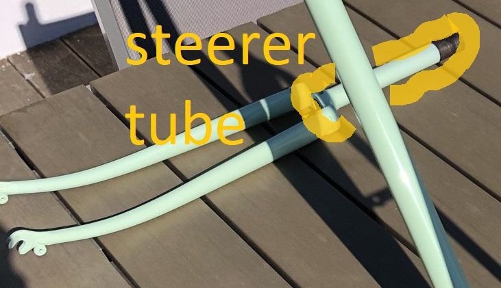

Is steerer Reynolds or NERVOR?
What was rear spacing at intake; was it necessary to cold set for present drive train?

Not sure I understand correctly ; what do you mean for steerer ?
do you talking about the headset ?
sorry I'm French
GeoffroyFromLux is offline

It is a beautiful bike Geoffroy! The steerer is the part of the fork that passes thru the headset.

Ok
thx!
cannot tell you for sure, but like the original stickers mentioned
I guess only scabbards are made in Reynolds steel
