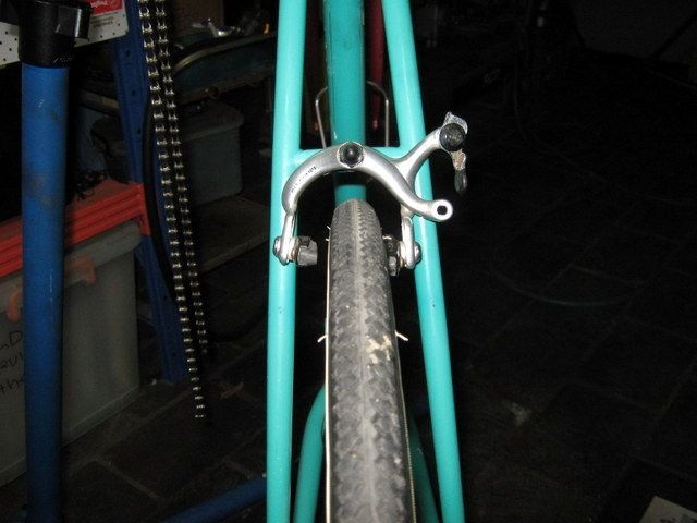

Maybe a 26" old bike, this one got given to me & accepts 700c wheels, & shorter reach brakes meant for those wheels...no problemo
28mm tyres, but you could of course go way wider

OK, What's the matter with centre pull brakes? They came with my GP, but i haven't restored the bike yet to try em out.
le mans is offline

I've done this with 80's lugged steel Schwinn frames, which seem to be plentiful and similar to the other Japanese / Taiwanese frames of the day. My 1982 "Traveler" easily accommodates 700c x 35 mm tires, though I didn't check for fender clearance. My "World Tourist" has 27" x 32 mm tires, and fenders, so I see no reason why it wouldn't also clear the slightly smaller diameter of 700c.
The cost picture depends entirely on how many "keeper" parts are on the used bike. I look for bikes that have a square taper crank with bolt-on chainrings, and horizontal dropouts per my preference for IGH and single speed builds. Some Schwinn frames have a derailler mount, others require the "claw" mount which limits your drivetrain options. There's about a 50% chance the bottom bracket will have been neglected to its detriment.
If the bike has good 27" wheels, I'd at least ride them until the tires wear out. I have a rule never to replace a tire until I've used up the rubber that I paid for.
Maybe nothing is wrong with good ones. I don't know. Just all of the ones I've tried were terrible compared to the dual-pivots on my road bike. From what I've read online the dual pivots are a newer technology and are stronger brakes. It matched with my (limited) experience and so I assumed that i was the case.
Center pulls do have a bit more clearance it seems. Maybe not more than the Tektros that I mentioned.
