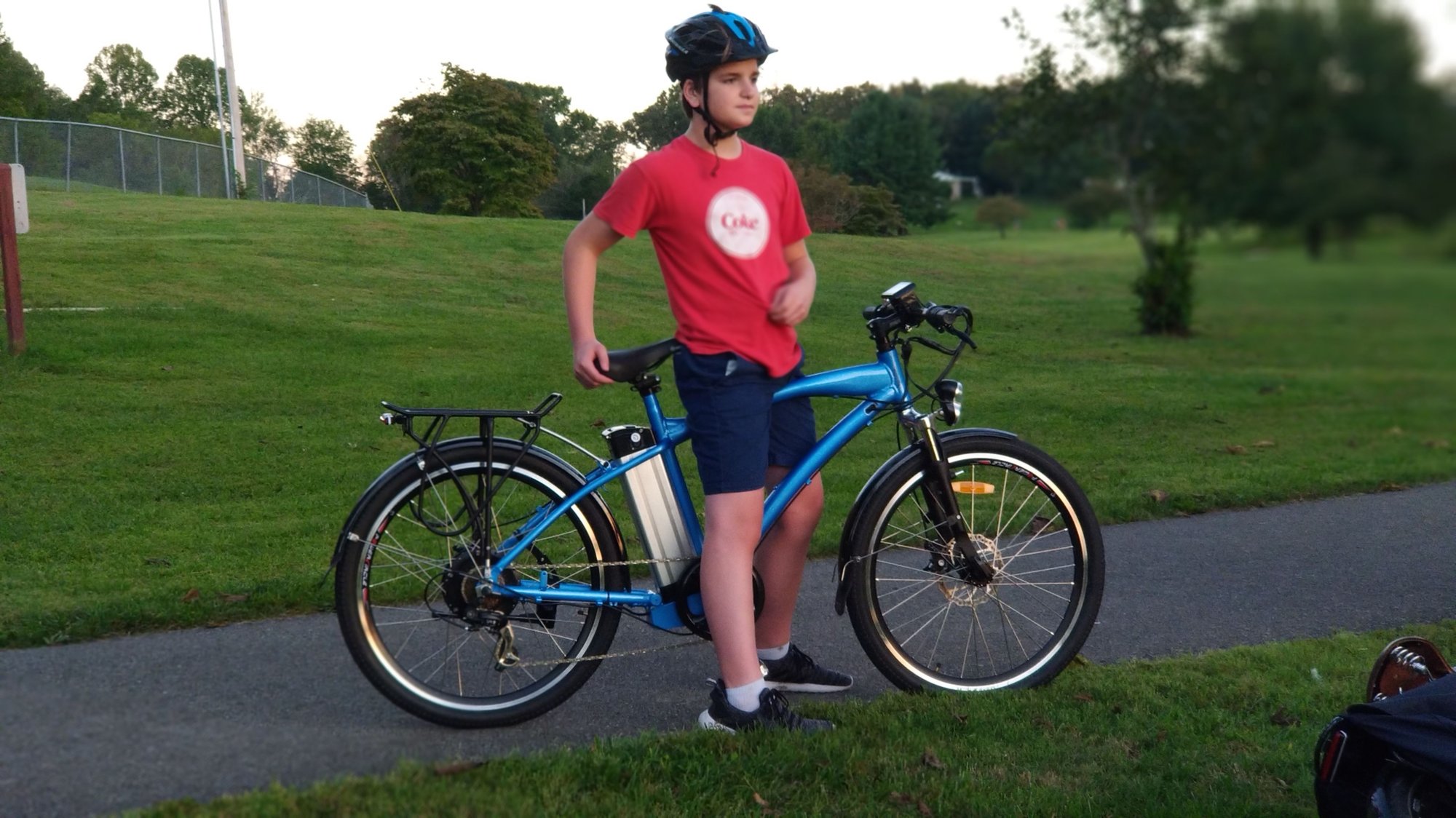

That is the one i bought from Jueshai. $1200. 48V/500W We added the fenders and rack. Swapped out the handlebars for something more comfortable from Origin8.

Very nice.
