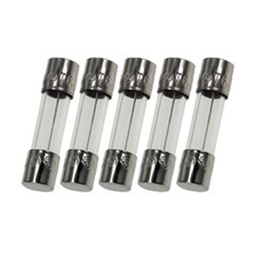

40 Amp fuses for the RMB battery packs - 5 for $1 & shipping
Big shipping discount on multiple purchases!

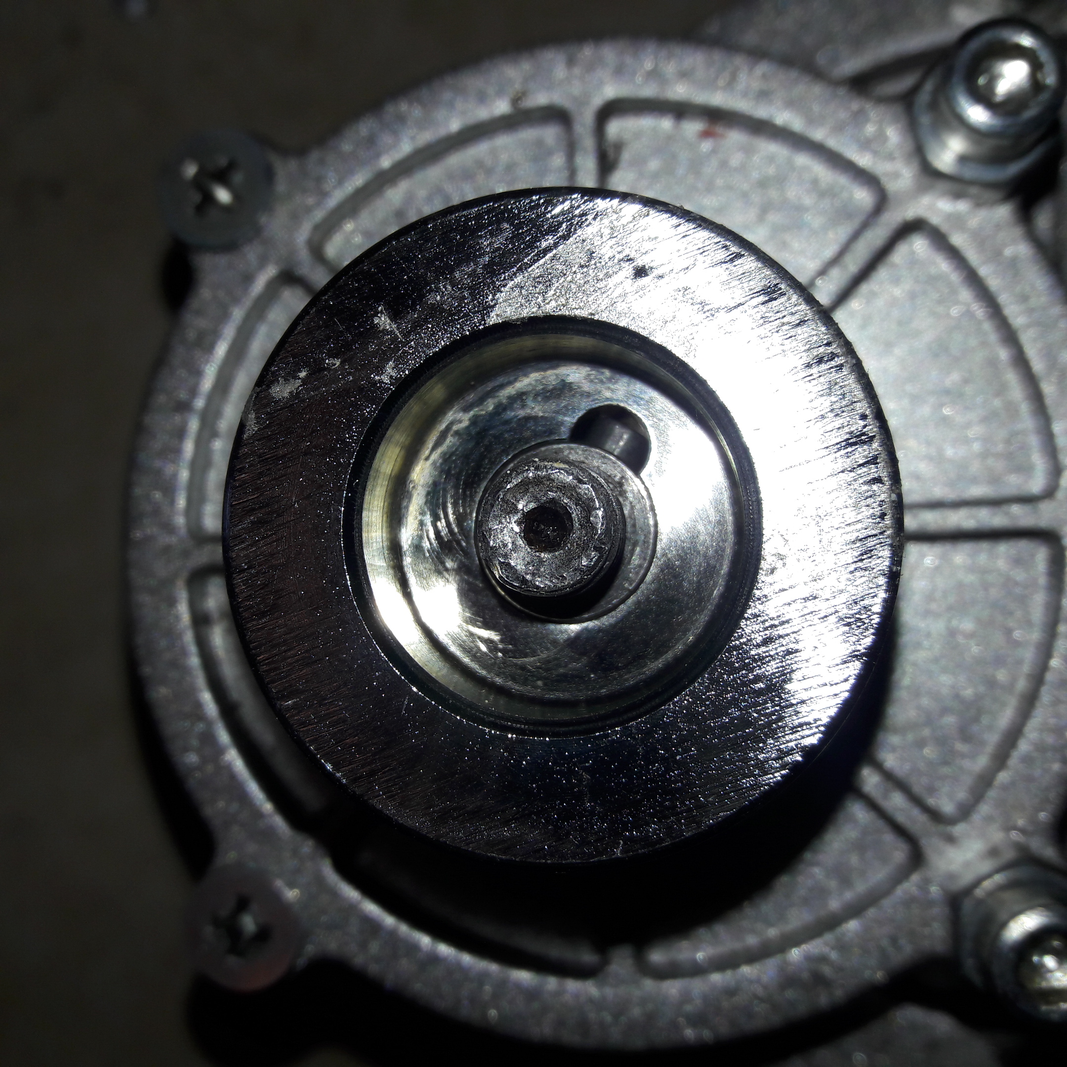

Motor Freewheel Adapter
Freewheel adapters for the Currie gear reduction motors are now available!
13, 14 an 15T freewheel compatible!
11mm ID w/4mm keyway ... Less than $17 ! - New Link
