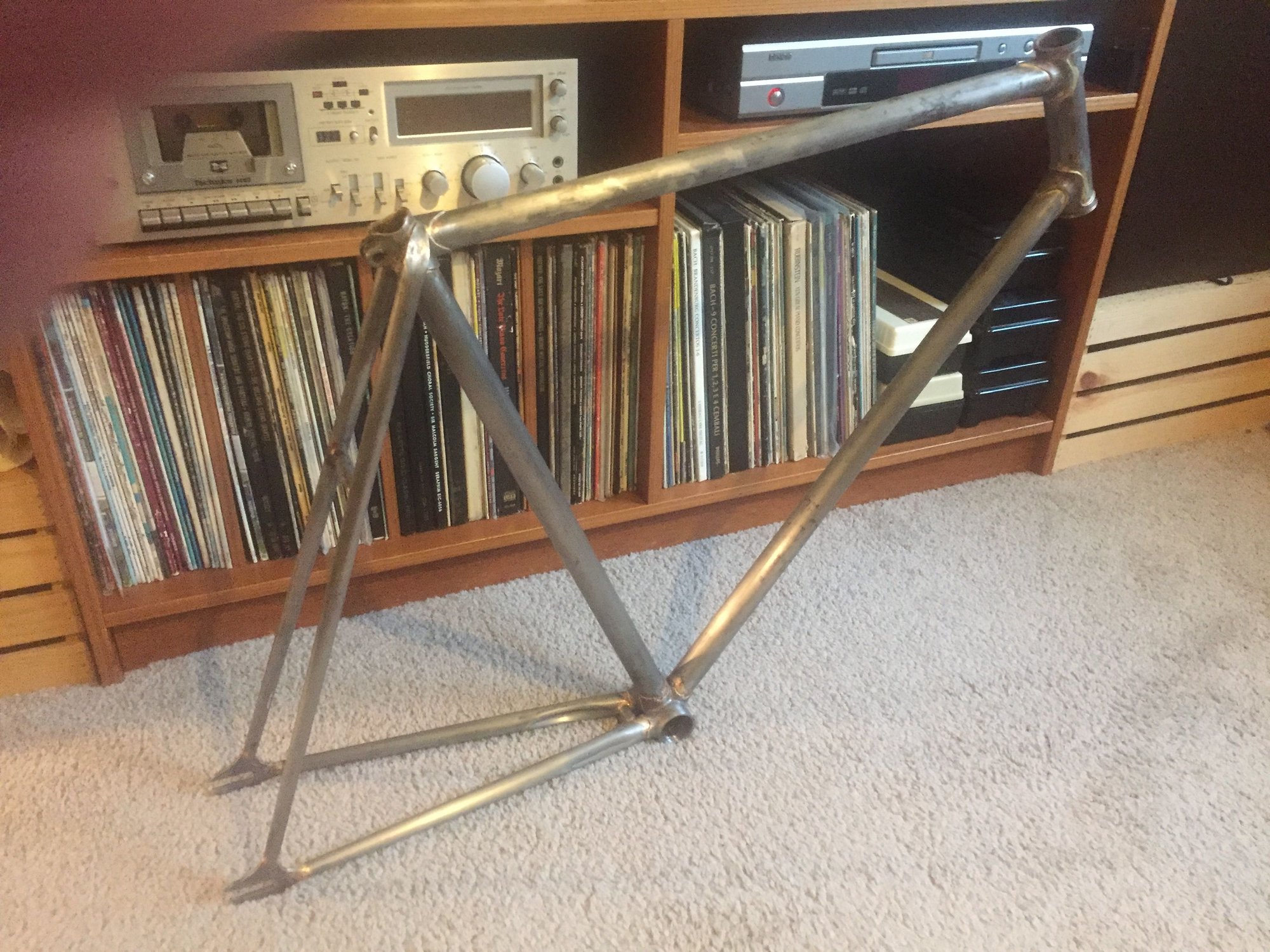

Would this be weird?
I got to thinking and I thought it would be cool to leave the frame as is. The epitome of the industrial look. Right, no paint. However I am thinking it should have a clear coat of course. Am I crazy?!?!
Thoughts?

It would look awesome with silver components. A couple of brand, or tubing decals, would look cool under the clear coat.

Thats what I have, all silver components 'cept for the seat.. Yeah get the decals and apply those, clear coat and assemble.

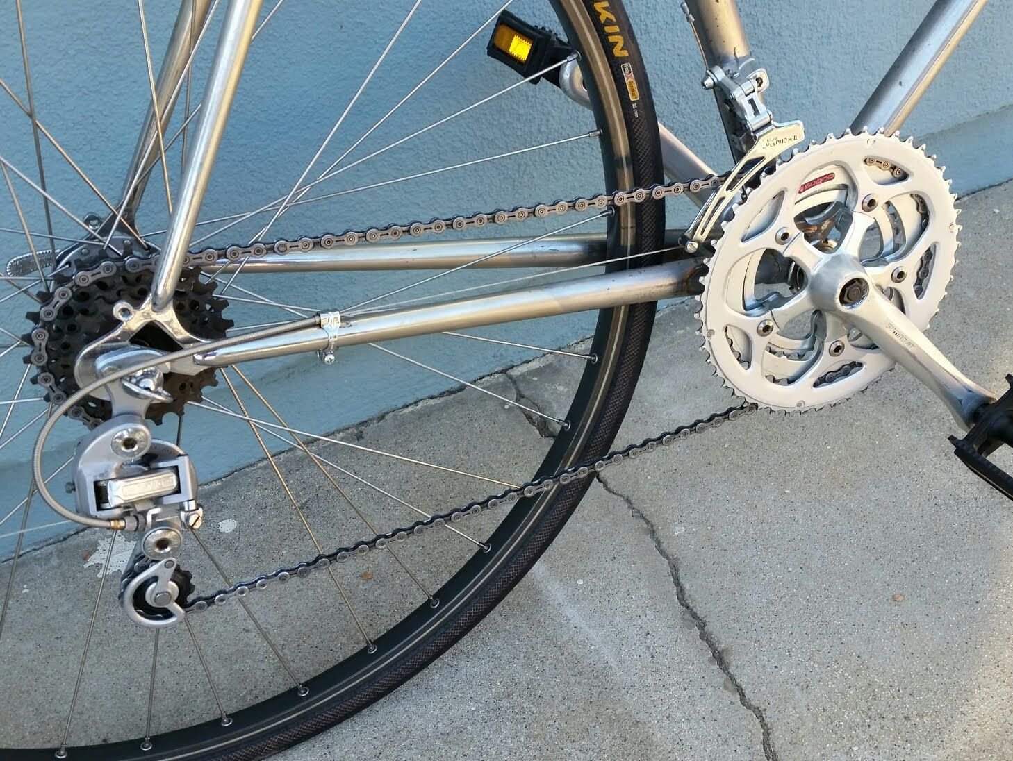

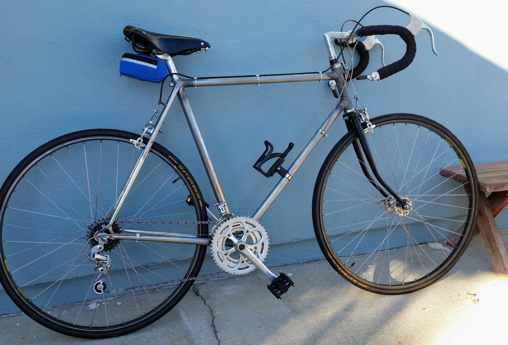

I don't think you're crazy. I've done it before - twice:
DD
Mine doesn't look as clean as yours, its kinda rough, which I still like...

There are all sorts of ways you can prep the frame in bare metal to make it look the way you want. The Colnago was brushed out to a fairly high degree while I left a matte finish on the Casati by using fairly coarse Scotchbrite pads to give it a uniform look, then clear-coated with matte, too. The Colnago has no clear whatsoever, but it also hangs indoors

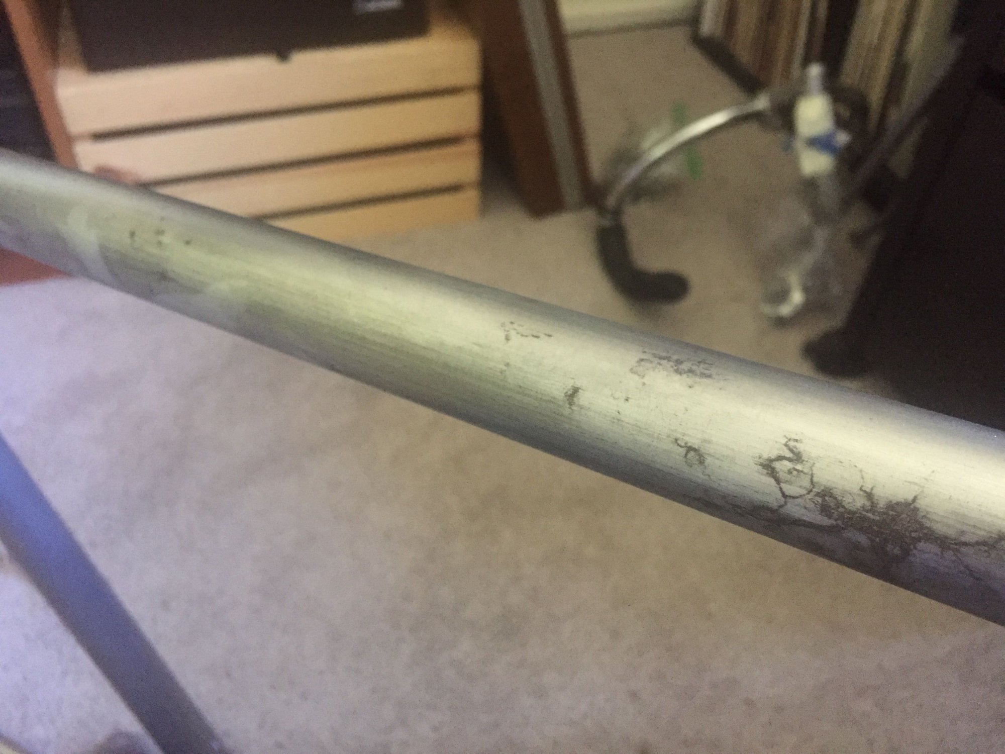

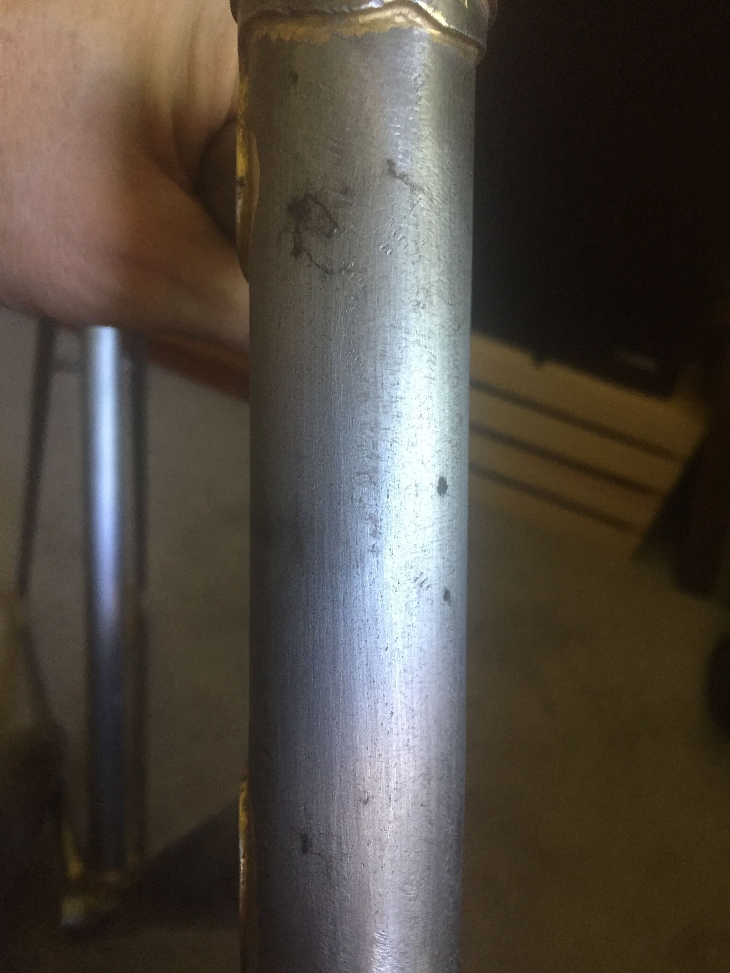

So I can buff these out? a lot of this finish throughout. I kinda like the look.

What you have there is "filiform corrosion". It won't buff out easily. I think it looks alien and organic, akin to mycelium, and is aesthetic to my tastes. I wonder if gun blue would stain it?

Probably best to clean oils & salts off the frame first, so you don't get any little rust spots showing through the clear coat.

for some reason (I have a theory) there's nearly always some "rust bloom" that grows underneath the clear. Often it's the infamous "spiderweb" variety but upshot is if you live in any climate other than "mojave desert' you will probably only have the "clean look" of raw steel under the clear for a limited time. My theory is this is always happening underneath virtually any repaint, especially when amateurs like me did the prep, it's just that you see it clear as day when the "paint" is clear! So for my money I would take this to a powder-coat shop that would go from bead-blast cabinet straight to coating and pay them for a good clear PC job, hopefully applied over a dead-spotless and bone-dry frame!

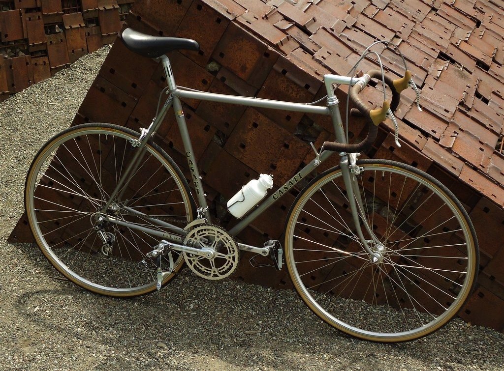

If you want a truly durable surface, a clear powdercoat done within a short time after the frame has been final-prepped (sanding, Scotchbrite brushing, polishing wheel or media-blasting are all possibilities depending on the look you're after) would be the best option.
However, I had the Casati media-blasted, then I went over it a bit with some 00 Scotchbrite pads. Finally, I shot Krylon matte (flat) clear and it gives a nice, even finish. It's not anywhere near as durable as PC, or even a urethane clear, but since you're not planning on it seeing rain and keeping it indoors, well, it should be fine. I have a couple rust blooms after over the past year (refinished last summer), but they are small - not much bigger than the small blemishes you posted in your pics - the same aesthetic you like.
