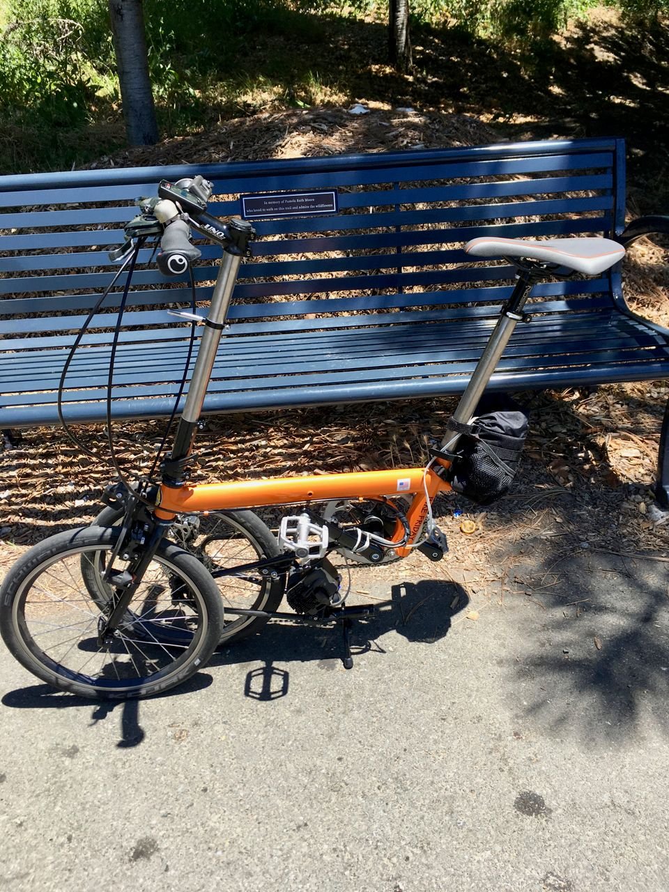

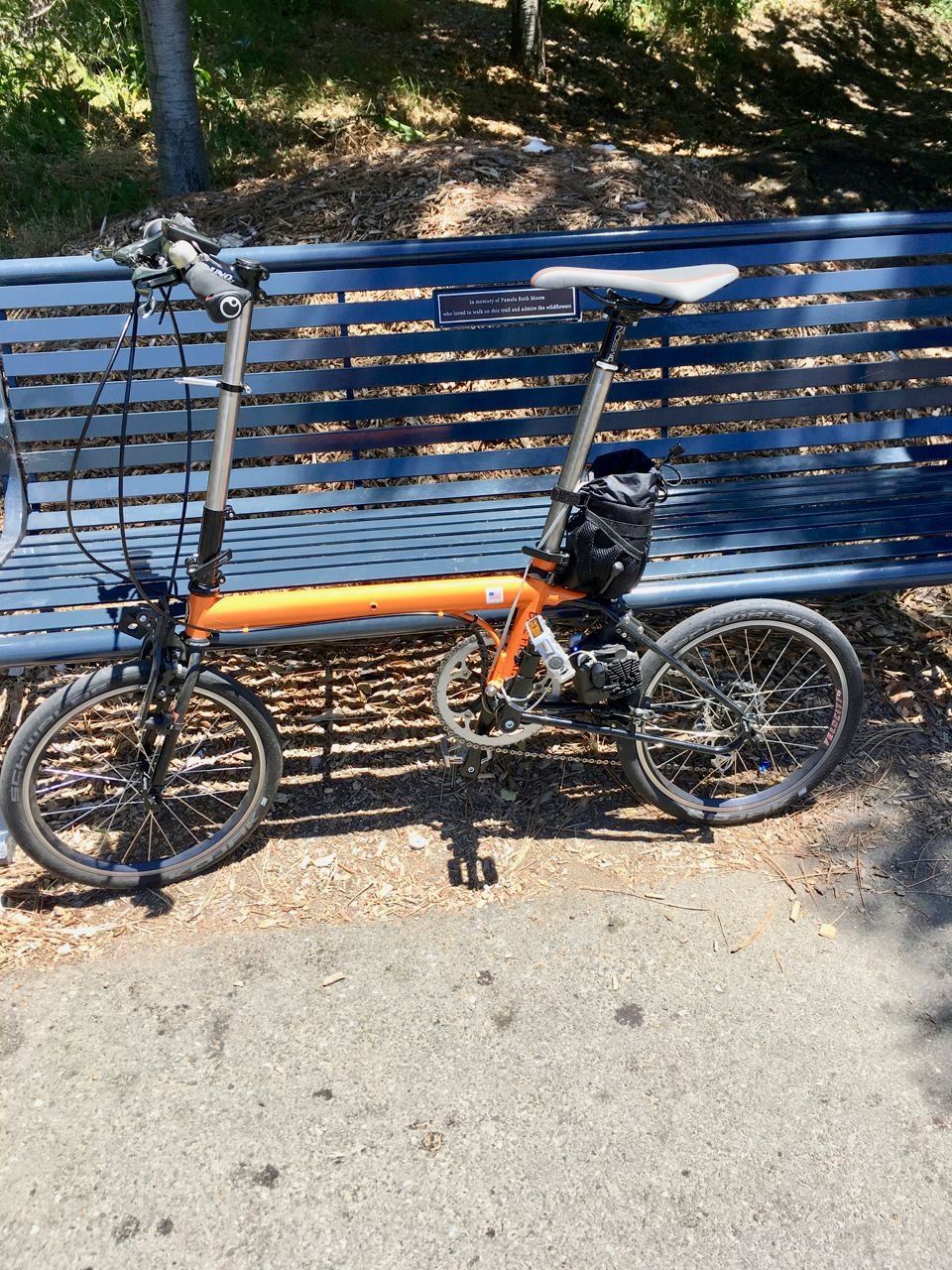

Rear stealth mount on a Bike Friday pakiT.

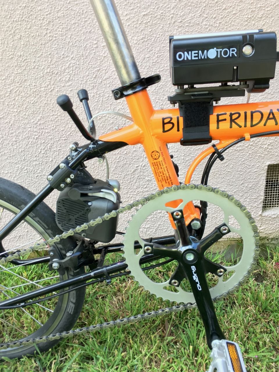

Front mount on a Bike Friday pakiT.

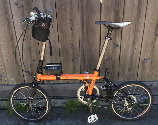

Easily carried off the bike by the built in handle or put into a bag. For size reference, that is a Bern size small helmet. The One Motor battery and motor connect together and the PAS and controller are magnetically connected on top.

Some more detailed pics of the rear and front mount. Video (of motor in use) - https://youtu.be/N_OJhOvTHDo using the PAS system. Video of motor in use using only throttle: https://youtu.be/WYnyK3WIORs
nts .
