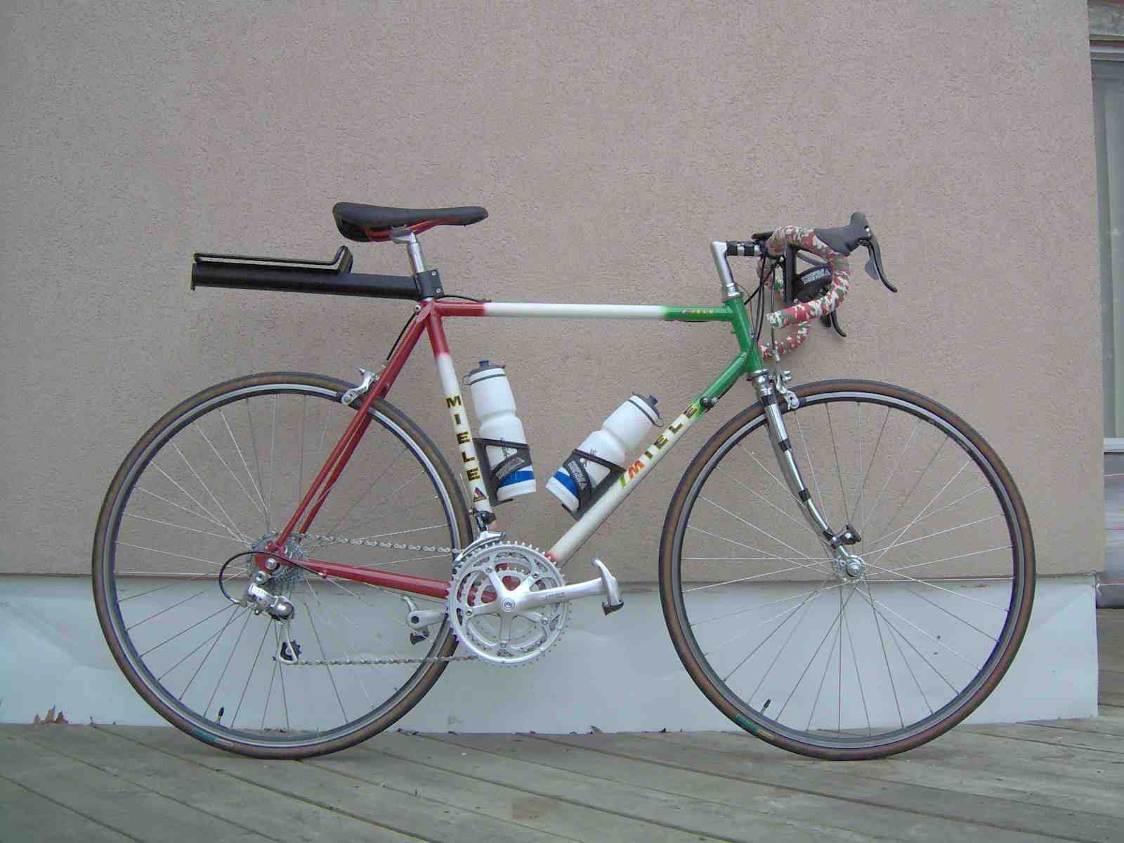

Miele Man
Location: Ontario, Canada
Posts: 2,177
Bikes: Miele Latina, Miele Suprema, Miele Uno SL, Miele MTB, Bianchi Model Unknown, Fiori Venezia, VeloSport Adamas AX
Quoted: 351 Post(s)
Liked 54 Times in 42 Posts
I painted this Tange Infinity MIELE frameset with KRYLON spray paints back in 2005. The image might give a recent date because I had to transfer all my files to this new computer when my other one died. It seems to be holding up well.
Cheers
