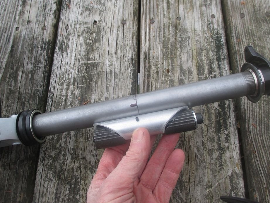

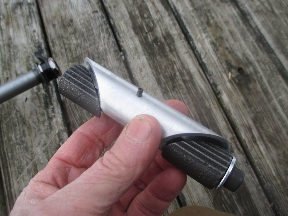

But I have a radical--and possibly foolhardy--solution in mind: the plan is to cut the steerer with a tubing cutter about six inches above the base of the fork crown, then face the cut ends so they're smooth and perfectly parallel. The upper part of the steerer with the adjustable cup, lockring, etc. can then be packed with the pedals when the bike is packed up. When the bike is reassembled, the upper part of the steerer is reattached by means of double-ended expansion fitting I made from a section of 25.4 seatpost, an M8 socket-head bolt, and two stem wedges:
The bolt threads into the wedge at left. The threading in the wedge at right has been drilled out so the bolt is a slip fit. The unit is 5" long.
I ran a brake-cylinder hone through the steerer and took off a couple of thousandths so the insert is a nice smooth fit, about like a properly-fitted seatpost. You can see that there's a little tension pin protruding from the side of the insert. That will fit into a little notch in lower section of the steerer wall, and accomplishes two things: it keeps the insert centered, with half of its length below the joint and half above, and it restrains the insert from any tendency to rotate as the expander bolt is tightened or loosened. I used a sharpie to mark the cut line and the notch for the pin in the photo below:
The marking for the notch is a little longer than it really needs to be--it only has to extend a tad higher that the 1/8" diameter of the pin .The base of the insert is over an inch uphill of the butted section at the base of the steerer--no problem there. The top is about 4 1/2 inches below the top of the steerer. It's easy to tighten the insert with a long M6 allen wrench, and there's plenty of room above for the quill portion of the stem.
Does this seem nuts to anyone? It sort of did to me when I started thinking about it, but as I thought it over I couldn't come up with a good reason why it wouldn't be safe and functional. I tried to think of all the possible failure modes.
Can the insert break as a result of bending force? I don't think so. The actual bending force a steerer is subjected to has got to be slight--certainly it's a small fraction force applied to a seatpost where it emerges from a frame's seat tube.
Could the insert be broken by twisting force, like the head of an overtightened bolt? No. There's almost no twisting force applied to a steerer in normal use, right? Just enough to overcome the friction in the headset bearings? Admittedly, there's more force in a crash or a fall, when the front wheel somehow remains stationary and the handlebars are shoved over hard, but in that case the stem quill--and in this case the wedge insert--can relieve the strain by slipping a little. That's a good thing, not a bad thing.
Could the joint in the steerer be yanked apart by some massive and unexpected force that pulled the front wheel down and the stem upward? I don't think so. Has anyone ever heard of a properly--tightened quill stem getting yanked out like a loose tooth? I haven't.
Could compressive forces cause the butted ends of the upper and lower steerer to hammer together, and maybe get peened over like the end of a cold chisel where it's impacted by a hammer? I doubt it. The actual compressive force on a steerer must be slight--all the force gets absorbed by the fork-crown race, bearings, fixed cup, and head tube.
What coul go wrong, it seems to me, is that the insert could be insufficiently tightened, or tightened too much. The same, of course, is true of quill stems, and yet most of us have learned to avoid disaster by doing it correctly. The same caution would apply here.
Two issues that do concern me a little:
First, because the fixing bolt is applying force to two wedges, rather than just one (as on a conventional quill stem, or one of those crazy expansion seatposts that Peugeot made for at one time), there's twice as much tension on the bolt as there would if a single wedge were involved, even though the force on each individual wedge is about what you'd find on a quill stem. But that's still not much force--certainly nowhere near the safe working limited of a hardened M8 bolt.
Second, the steerer tube itself is being asked to handle the outward force generated by three wedges--one at the quill stem and one at each end of the insert--rather than the usual one. But again, that's not all that much force, and the individual wedges are spaced several inches apart. The insert wedges will also be oriented at 180 degrees to the stem wedge. To me, it seems unlikely that this could overstress the steerer tubing.
And yet...and yet...I'm still a little uneasy, as evidenced by the fact that I haven't yet cut the steerer. Part of my brain keeps saying, "Hey, c'mon, you can't just cut your steerer in half and kludge it back together with something you've knocked together from a piece of seatpost! What kind of idiot are you, anyway?" That part of my brain has no confidence in the problem-solving part of my brain.And in truth (I point this out myself so others won't have to), this is sort of a solution in search of a problem. I could probably sneak the bike onto Amtrak just as it is. But just like the idea of making it as small as possible.
So back to the title of this overly-long post: Is this stupid and dangerous? Or just stupid? Are there possible failure modes that I'm overlooking? Am I misunderstanding the possible failure modes that I have considered? I really should have gone to engineering school..

Clever but foolhardy and yes, dangerous. Steer tubes are under a lot of stress. Watch your front hub move back and forth on a bumpy road sometime. The fork constantly wiggles and flexes, and it transmits its load to the diamond frame through the steer tube, and the frame also flexes and distorts. It takes a lot of force to do that, and it all goes through the steer tube.
I think the solution is n+1. You need a folding touring bike. Preferably Moulton, but Bike Friday's are kind of cool. IME it's not worth the effort to go against bureaucracy. Logic doesn't matter. If the rules say folding bike, The Amtrak employees are going to insist it's got to be folding bike. Not rinky dinko or whatever crazy thing you're telling them that they don't understand. OTOH if the rinko is in a case, isn't it just luggage? What's the problem with that?
Or you could write to your congressman and try to make a case that Amtrak needs to get with the rinko program.
But you're probably right about the whole thing being a bad idea on general principles.
