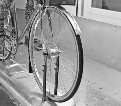

So, I read that Jan Hein did wind tunnel aerodynamic testing to prove that "the overall effect of the full fender and (small) mudflap neither increases nor decreases the wind resistance of the bike."
But I notice his picture show he use very skinny fenders that seem to barely cover the tire's width.
So, the question is how much does wide fenders slow you down? Lets discuss.

I think part of his argument is that fenders increase drag in some areas, but the part of the front fender that covers the top part of the front of the front tire reduces drag, so the net effect is negligible. That makes sense to me, but my front fender hardly goes down the front at all, so I doubt I get any advantage there.

The wind tunnel testing was mostly nonsense. I've never seen anyone run a fender like the one in the test and the results would most likely not replicate with any off the shelf fenders. It's the same as how a rear saddlebag that was wider than the rider's hips was used as proof that front handlebar bags have less drag than rear saddlebags. Nonsense.
Like wide tires and handlebar bags, I believe there is additional aero drag due to fenders but over most distances it's negligible. Would I run a fender in a time trial or a race? No. For a 300k+? I debate quite a bit as I know from experience having fenders adds anywhere from 15-25 minutes over 200k. Usually I take fenders but if it's going to be completely dry I have foregone them in the past.
But for most of my everyday riding bikes the difference is small enough that it's just noise. On particularly windy days I do notice the difference in the effect of gusty headwinds when using fenders on the same bike vs when fenders aren't installed. If a 10-15-20mph cross wind is obviously affecting the bike more with fenders does it not stand to reason that wind directly from the front has an effect as well

If I recall, Heine also was claiming that the long forward extension reduced water being thrown upward by the tire. Upward into the rider's face - one of Heine's goals for a good fender setup was to not throw water into the face, because road water could be contaminated by some really nasty and disgusting stuff. Of course it was also about protecting the drivetrain against dirt thrown back by the front wheel's rooster-tail, and other matters of foot and frame contamination.
