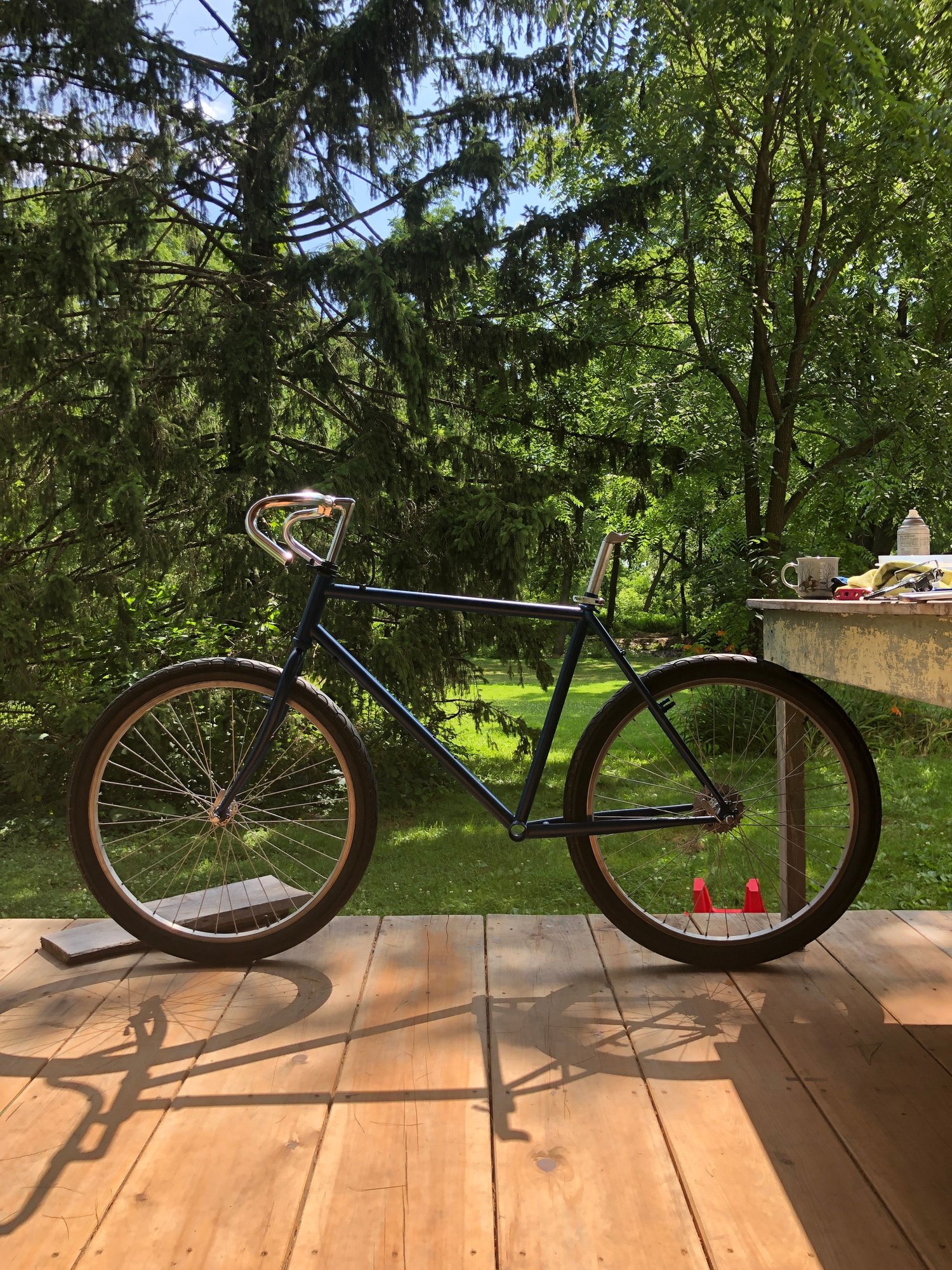

Is the stock fork threadless, or are you using an adapter?

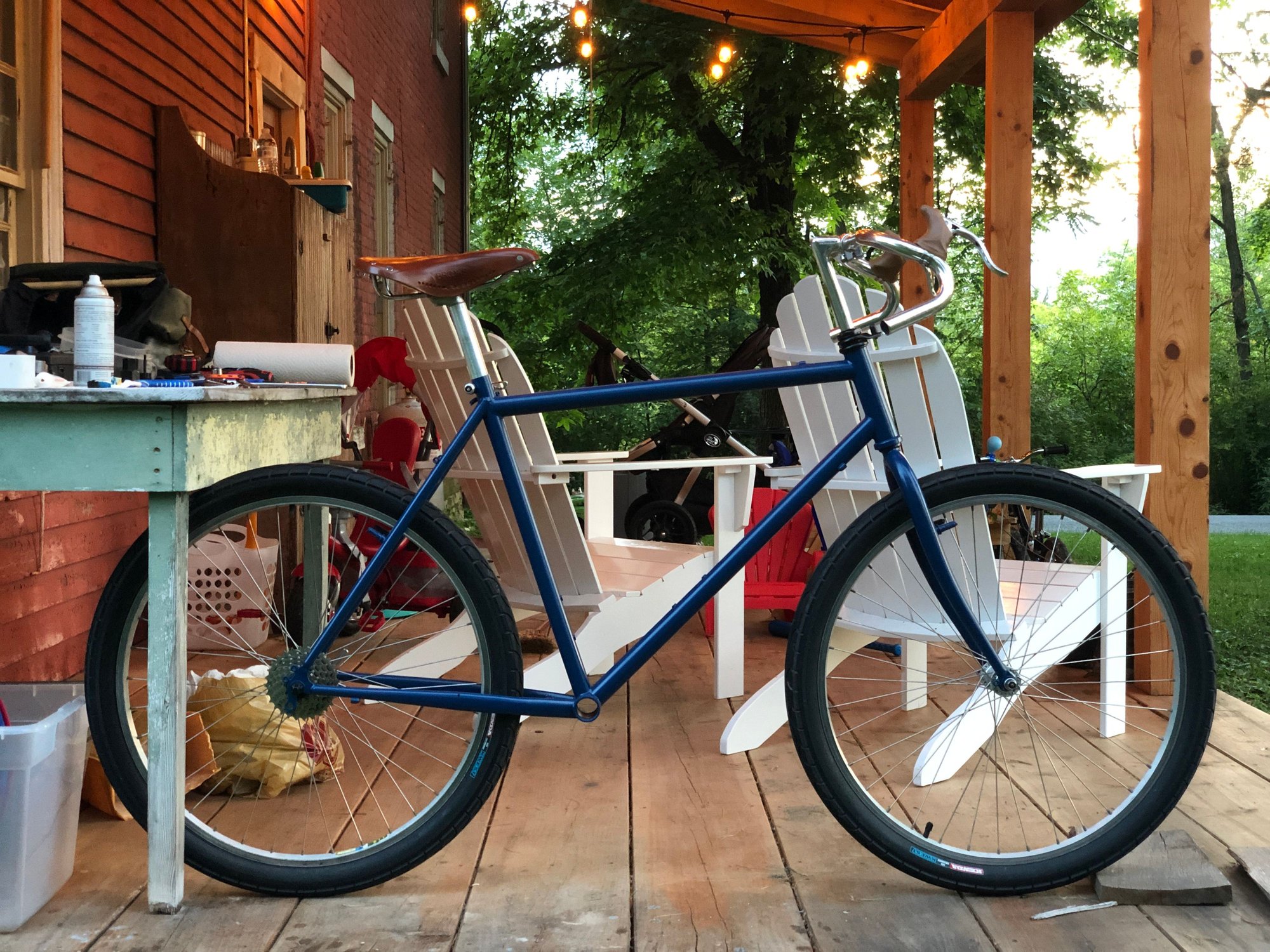

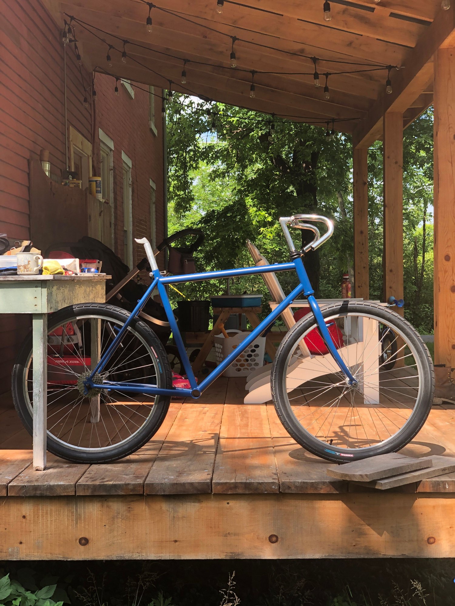

stock is 1" threadless!
also, the Dimension forks I'm looking at have 26 cm steerer, which seems like it would give me about 5cm of additional rise over what I've got now. Maybe something with even longer steerer might be available?
Could you have the original fork steerer threaded and use a quill stem?

I hadn't thought of this--thanks for the idea. My initial thought is I wouldn't want to try installing a new headset in my garage if I could avoid it, and the new threadless forks run about $80, so it would be hard to beat the economy and simplicity of swapping.
belacqua is offline
