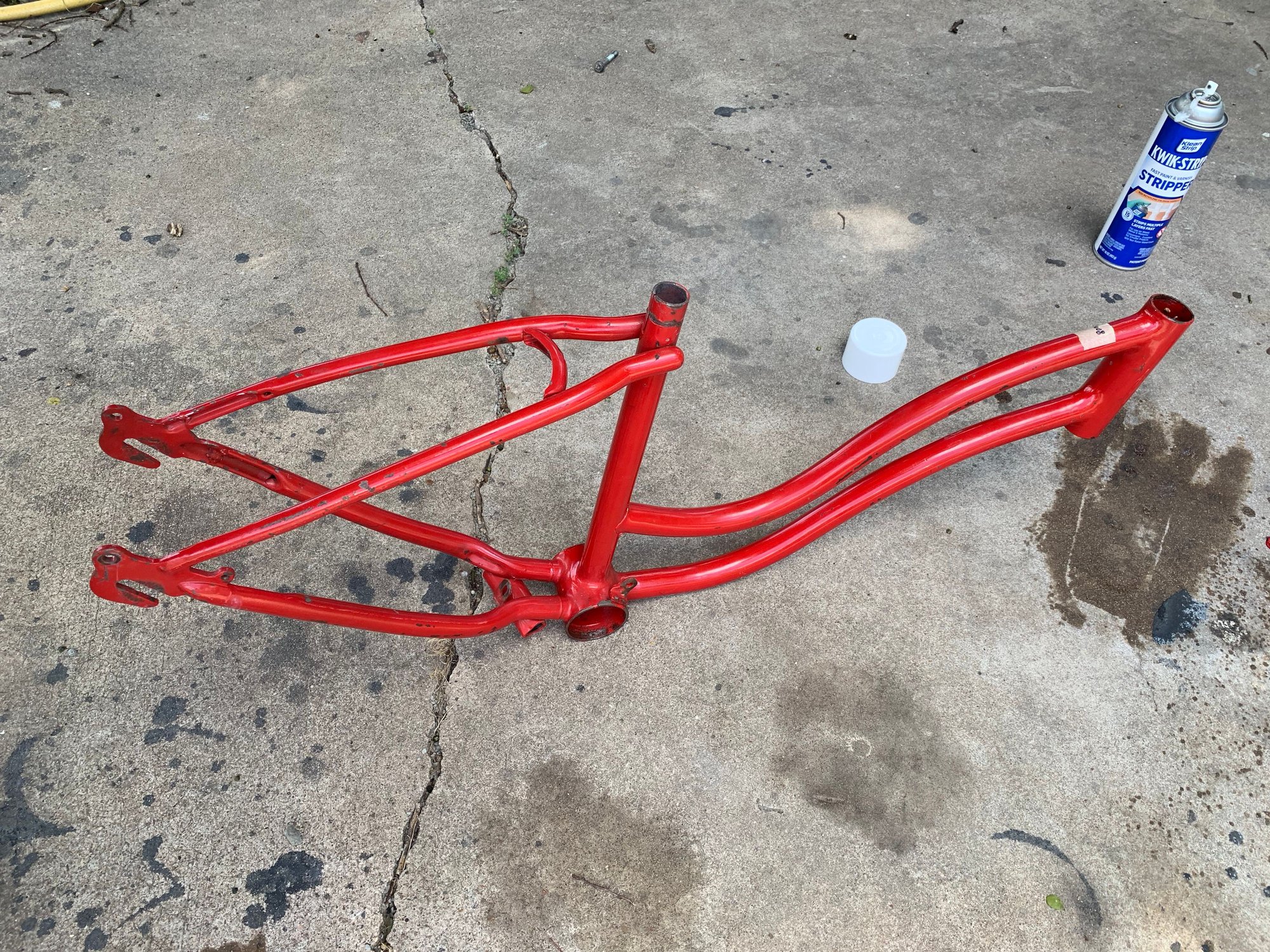

How she looked from factory with the green paint.
Frame as bought
By end of summer this is what it should look like.

Old 06-21-19, 01:21 PM
Sp1990
Posts: 63
Quoted: 12 Post(s)
Liked 7 Times in 6 Posts

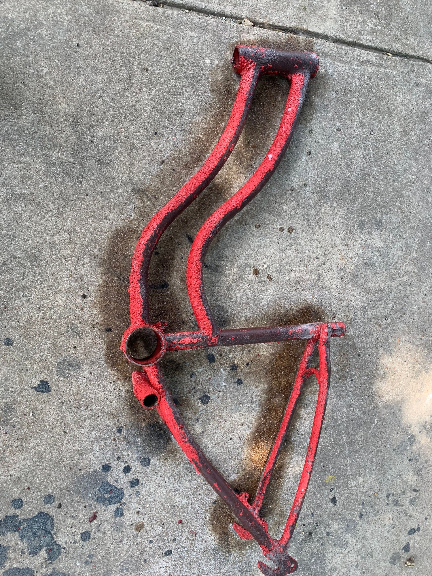

After chemically stripping paint, next to sand it down smooth. Apparently whoever did the red repaint stripped all green original paint off. Only a little original green on forks.
