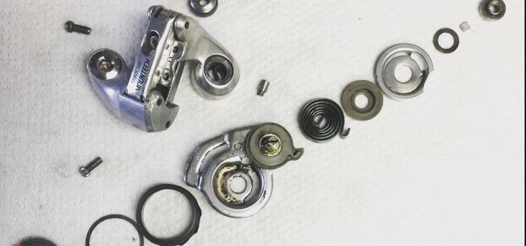

If you’ve got that first generation Mountech- the one with the upper pulley built into the unit- find something else to replace it with- there’s a gazillion other derailleurs out there that don’t present the possibility of catastrophic failure like these do.
I am a few posts shy of being able to post pics. Is there a way of identifying how the upper pulley is "built into" the unit?
Google “Mountech.”
The ones with the block lettering have the upper pulley captive in the arm. Those are bad.
The ones with the script lettering have a standard upper pulley system. Those aren’t quite as bad- not quite “good” though. I had one with the huge 13T lower pulley. I wanted to love it because it was so quirky weird/cool. But it just didn’t shift “Suntour” well. IMO- the triple pivot idea was totally unnecessary with the slant parallelogram. And ask yourself what you need a spring loaded, captive pulley for... I have one of the Suntour triple pulley derailleur that shifts GREAT. Much better concept - but SIS was about to steal the show.
BTW- If you’re wondering what’s so bad about the design - there’s no way to service or even know you need to service the upper pulley unless you do that ^.
And then dirt and grit get in there, and then the pulley seizes, and the derailleur goes into the spokes.

From my experience with a 1984 Mountech (the one with the internal spring), and having rebuilt that one early on, I wouldn't expect trouble from it unless you are mountain-biking or riding in a very dirty environment.
As bad as people say they are, mine survived years of use after my initial six months of hard off-road use, and after which I did milder riding mostly on the road, but still with many trail rides thrown in.
I consider the early rear Mountech to be disposable when the top pulley becomes very worn in terms of it's bushing freeplay, since I can't remember ever identifying a convenient source for such a replacement pulley.
My 84 Stumpjumper Sport came with a Mountech RD and Specialized hubs with Saturae rims... It came to me with a circa 1994 XT RD with a circa 1994 LX / Weinmann wheel- but most of the rest of it was stock. While I didn't ask the PO about what happened to the rear end- he did say he mostly just commuted with it.
I have the infamous Mountech it seems.
It looks clean. The bike itself seems pristine. It has the original freewheel, from what I can tell, and it is hardly worn. I will keep an eye out for the suspected mechanical failure and also keep an eye out casually for another RD
