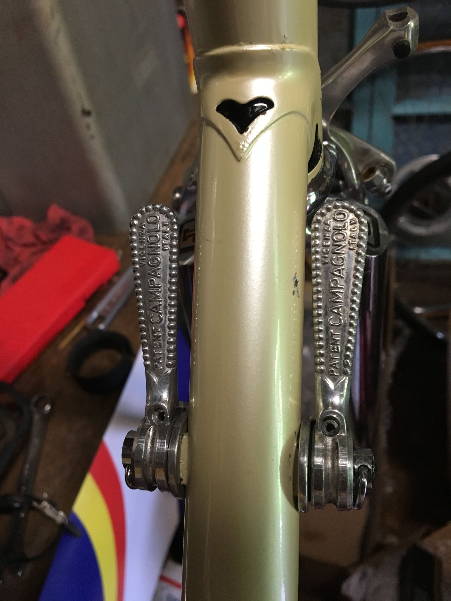

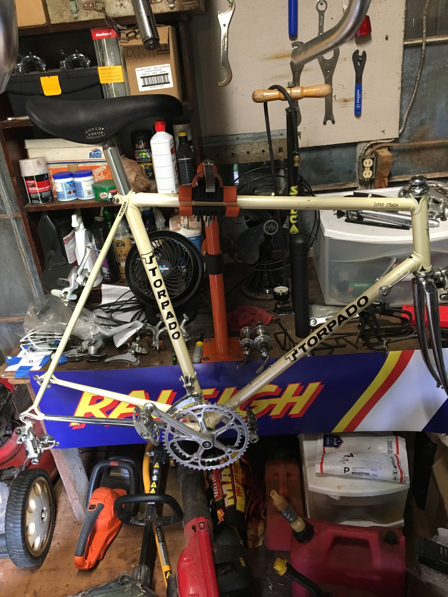

Hello all. I felt compelled on this rainy day to share my build as it creeps along.
I decided to stay in the Italian vein if I could. The components are all over the place model/period wise (some early for the frame, some late), but mostly Campagnolo so there is some cohesion.
I installed the headset today except a needed spacer, and have most of what I need to finish except time. Hopefully next weekend I can finish it up.

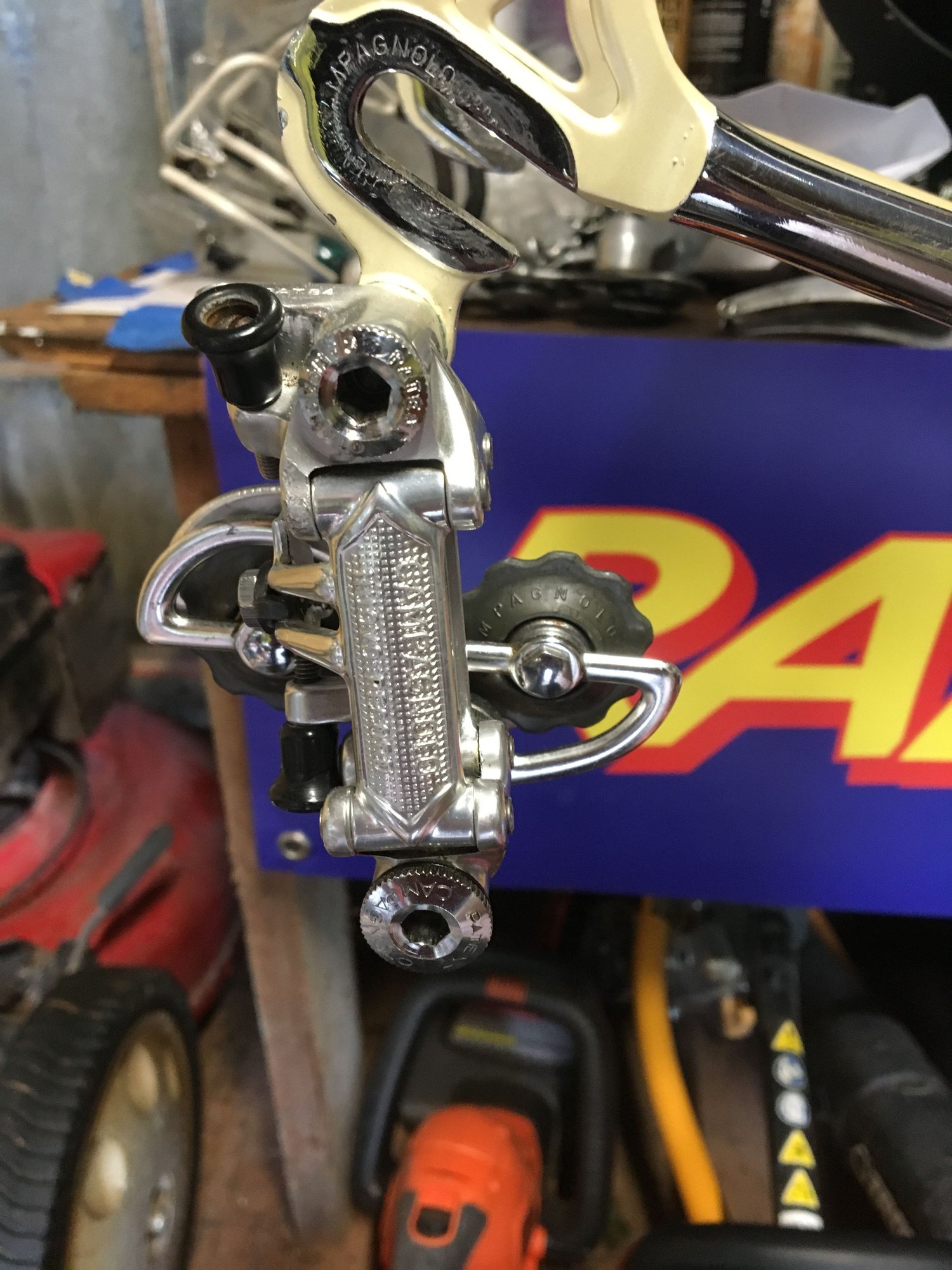

Iím not an expert on Campagnolo models, so Iím not sure of some of these, school me.
So far:
Nuevo Record RD
Record seatpost
Ofmega crank
Campy...model?
dual pivot brakes (later)
headset
front derailleur
shifters
I have a wheelset with Record high flange I was thinking of using, but havenít decided if the high flange will look out of place on this frame.

The front derailleur is a Nuovo Valentino. The levers are Record. The derailleurs and levers are OEM spec. At first, I thought the crankset was the OEM spec Ofmega Competition but then I noticed the swaged construction, so it should be a Gran Premio. You don't include a good picture of the headset but it may be the OEM Spec Ofmega (no model given). FYI, the spec tubeset during this era was Columbus Aelle R. These typically came with pantographed stem, post and chainrings.
T-Mar is offline
Thanks for the info T-Mar, I thought the levers were Record but wasnít positive.
Many of these parts are off another bike which prompted me to begin with the thought process of making it OEM, since I was partially there. But, that quickly changed to a ďwhat do I have and what can I affordĒ mentality.
I did check eBay for the pantographed components, everything I found was too rich for my blood.

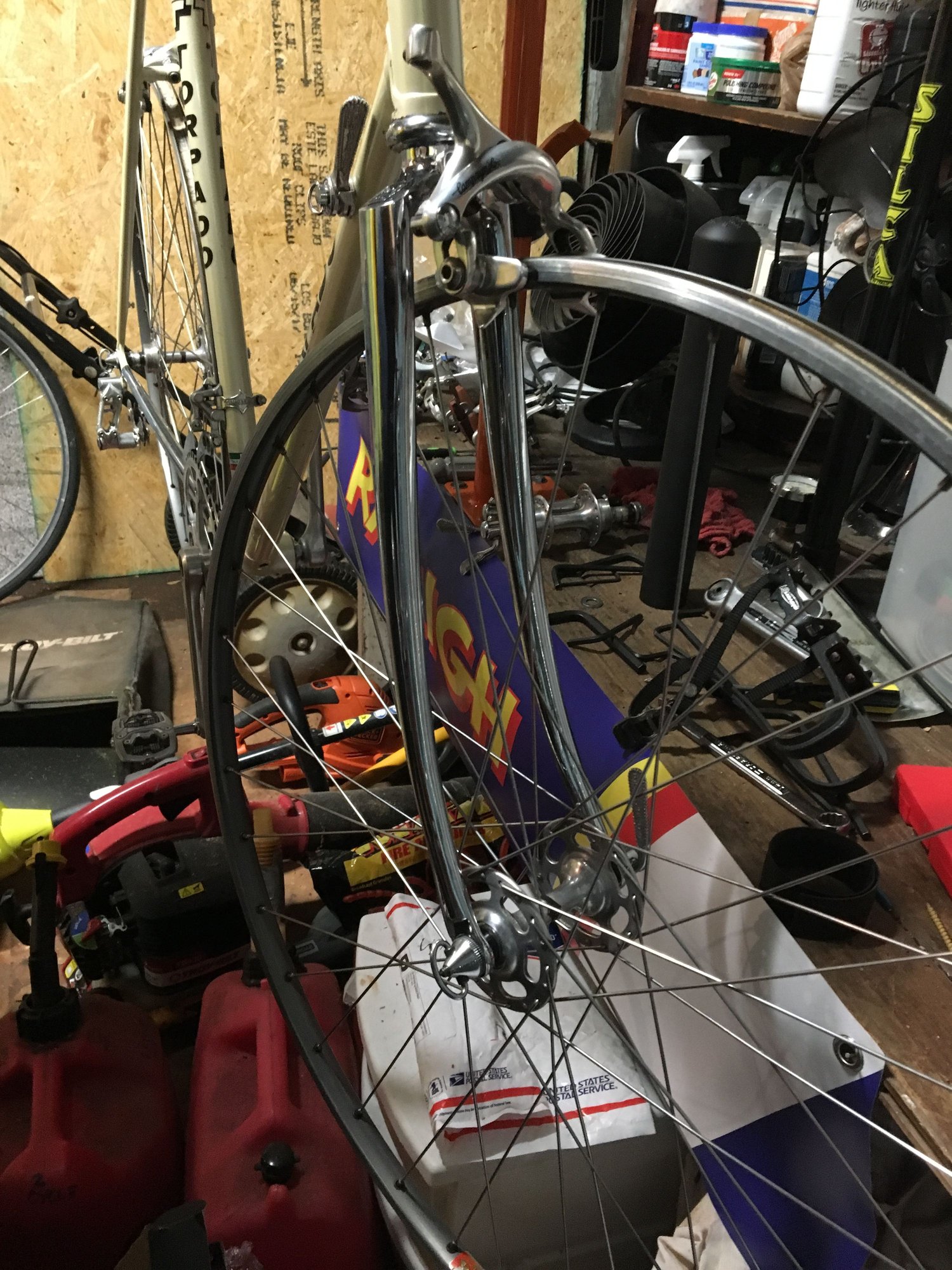

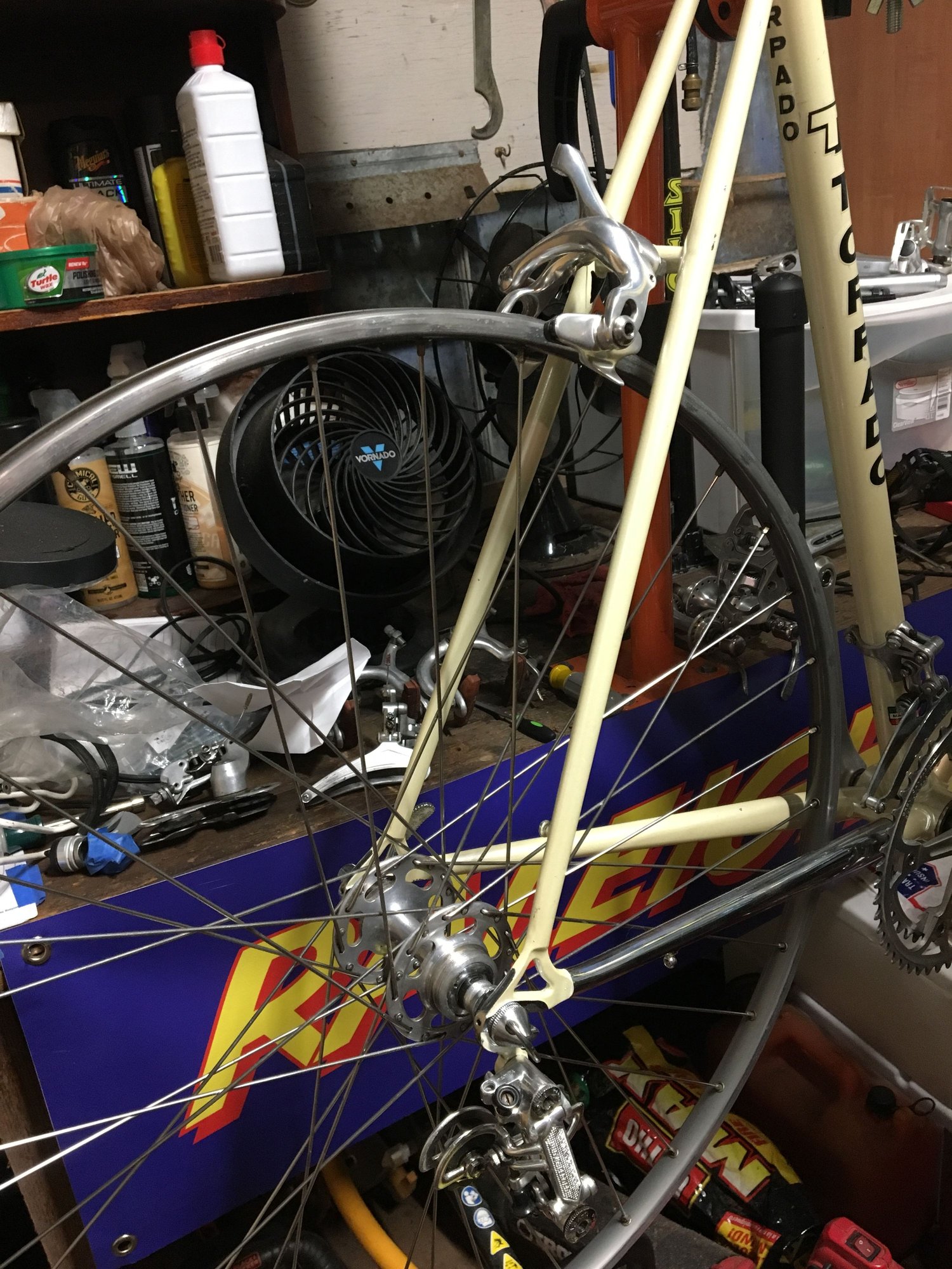

Mocked up the wheels and stem/bars. Thoughts on the high flange hubs? I donít think the look too strange...plus I just repacked with fresh grease and new bearings, so now Iím really tempted to use them on it.

I was surprised at first to see the high-flange hubs. But I think any bike running the old Campy NR drivetrain can get away with them.
Iím still on the fence. The dual pivots already look a bit out of place with everything else, the hubs donít help them. I may just roll with it until I can come up with a better option. First and foremost I just want to get this thing on the road.

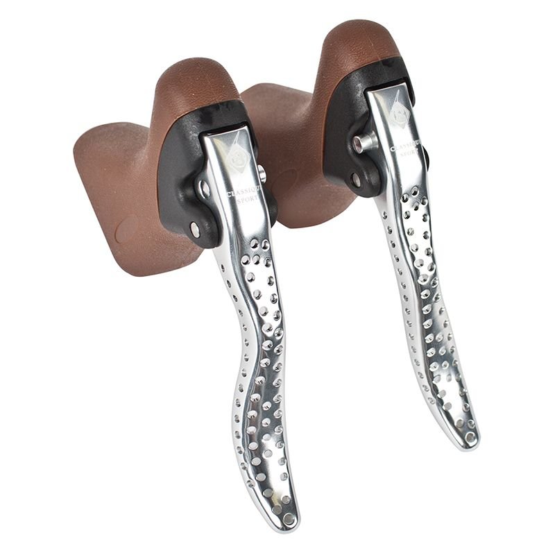

I have Origin8 Classique levers on a couple of my bikes - they are clearly made by Tektro but Tektro doesn't offer anything like them under their own name. They run about US$35.

I was going to wait until I wrapped the bars to post an update but with my schedule these days, that could be weeks from now
I took it out for a shakedown ride this past weekend, great ride! I cut the front brake housing a bit short, but it seems fine. I may resize before I wrap. 22.74 lbs as it sits now.

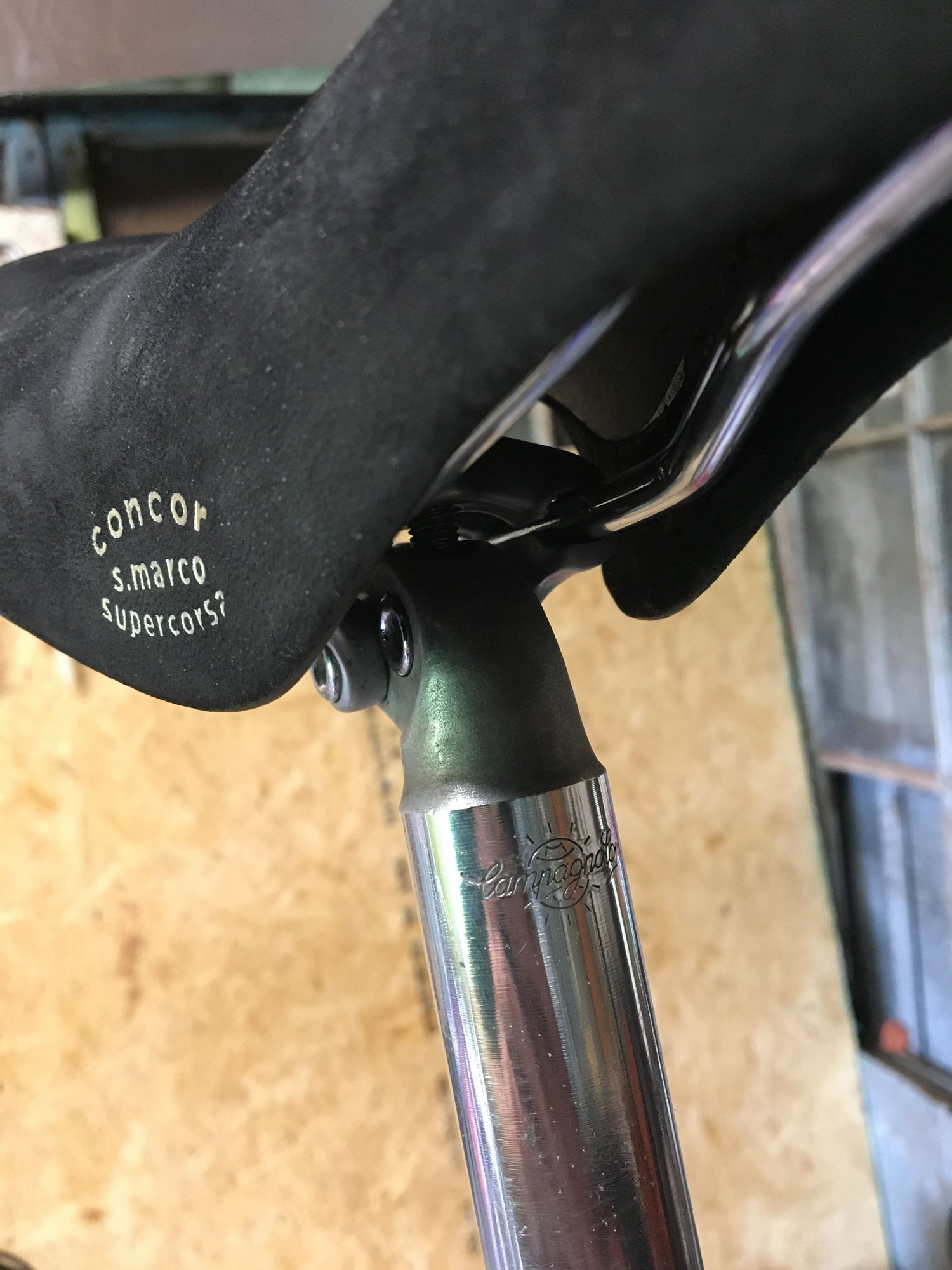

Looking great!!! I like the wheels. The cranks look very much like the originals, except the originals ofmega had a pantographed chainring with a repeated T around it.
The Stem was pantographed with Torpado and the seatpost was pantographed with the T. The original brakes on it were Universal (I forget which number) and yes, that color is amazing in the sunlight. The pearl jumps. Seeing your build reminds me of why I fell for it when I did.
