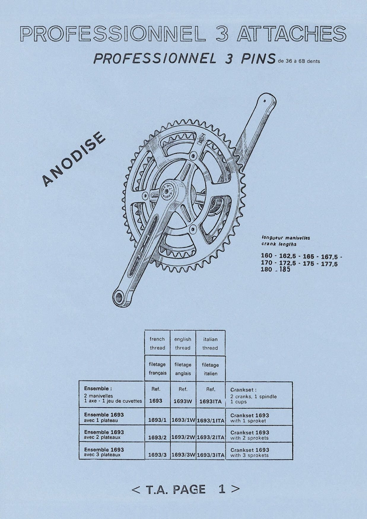

Exploring if I could fit a 36T 110bcd x 5b inner ring to convert this from a 52-42 to a 52-36? :
Original TA 52-42 Crankset
_________________________________________

No, you can't -- this crank has three holes and a 116mm bcd, so it's not compatible with the chainring you mentioned. You'll need to try a different crank, unfortunately. Cool bike, by the way...

About 10 years ago, I changed the TA "Pro 3 Attaches" chainrings on my late 60's Bertin C37 from 52-42 to 50-37.
36T was the smallest chainring TA made for these cranks and after months of searching I finally came up with a 37T.
You can probably find a 36T 116mm 3 bolt chainring but it needs to be arced to fit closely on the crank web plus the holes counter bored in the rear. These cranks take special chainring bolts with a large diameter head and a smaller diameter than standard chainring bolts. They tend to be brittle.
They break EASILY if overtightened and replacements are hard to find (been there - done that). I wouldn't trust those bolts just to hold a non fitted (non arched) chainring onto the back side of the large ring.

116bcd
Thanks.
Didn't feel I was getting an accurate bcd measurement, but it looked larger.
Completely missed my 3 vs. 5 oversight

As mentioned above, 36t is the smallest to fit but a challenge finding TA branded ring. Though chances are better finding another brand 3 bolt and modify to attach. I like the minimalist style and would certainly attempt a modified ring before changing the crank.
There are adapters 3 hole to 5 (possibly 6 as well) hole but unfortunately defeats your purpose. Those adapters are for 45 tooth.
This leads why the TA Cyclotourist cranks were and still desired today.
Also consider the Stronglight 49D and others with the 50.4 BCD, plus there's adapters for other large BCD rings.. Great options and flexibility.

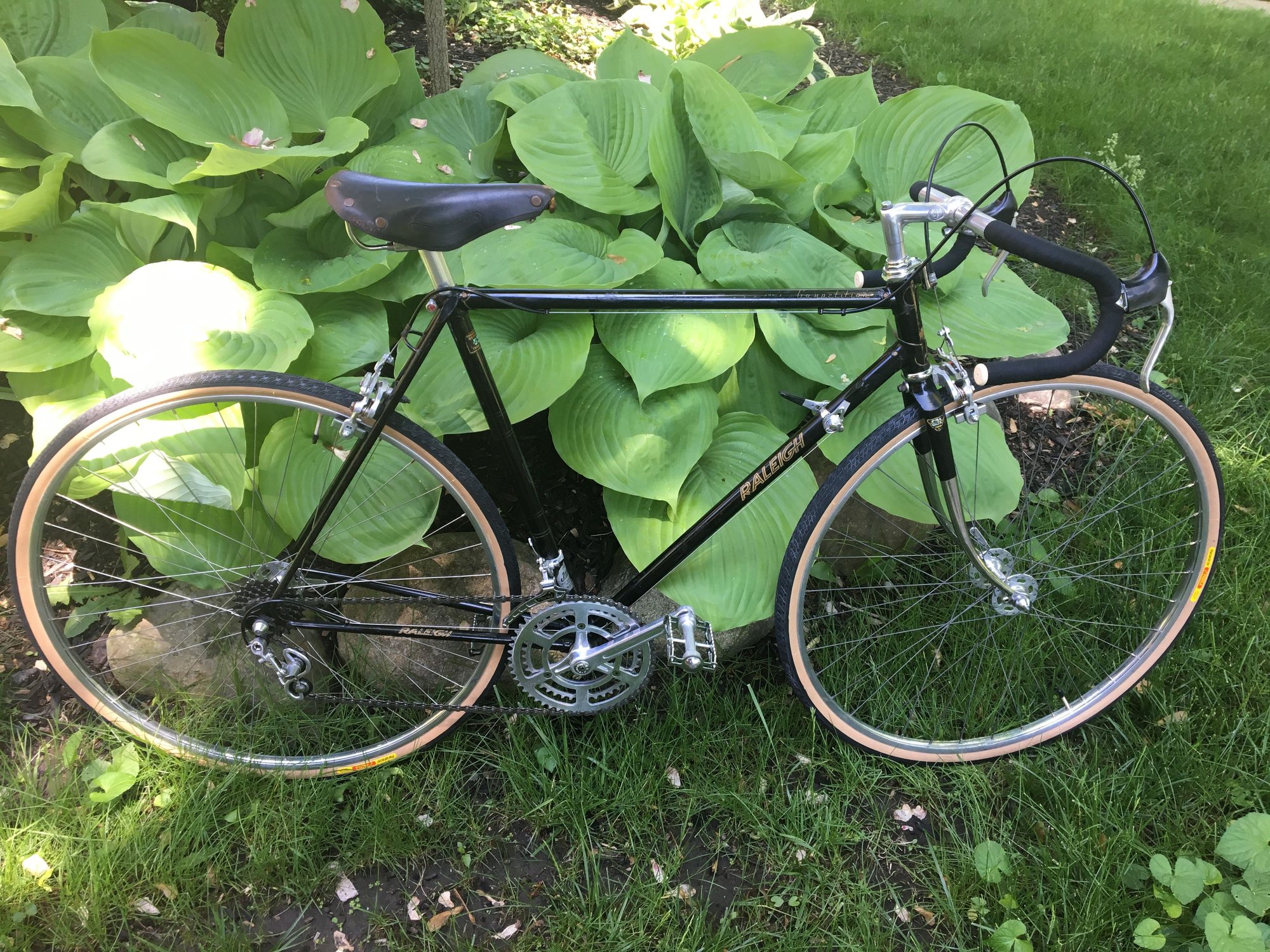

The solution to your problem is not a scarce chainring or another crankset but another bike!
Here’s my 1973 that is almost finished (thanks Roger! &#128521
Nice Jubilee RD.
Black cloth bar tape?
22.5" frame?
Very well kept specimen.
Garage queen? j/k
I'm really enjoying the ride quality of this model Raleigh.

Originally Posted by chainwhip
Nice Jubilee RD.
22.5" frame?
Garage queen? j/k
Just driven to tinker, I suppose.
I was just joking that it’s an excuse to buy another bike
i think a TA cyclo tourist would look great on your bike. Your choice but I would save the original crank in case you or next owner want to change back again.
yes mine is 22.5” , yes black Tressostar cloth tape. Found it in pretty rough shape but thanks to good people in better shape now. https://thecabe.com/forum/threads/‘7...tition.148754/

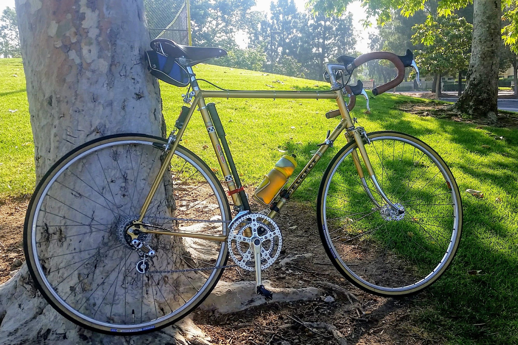

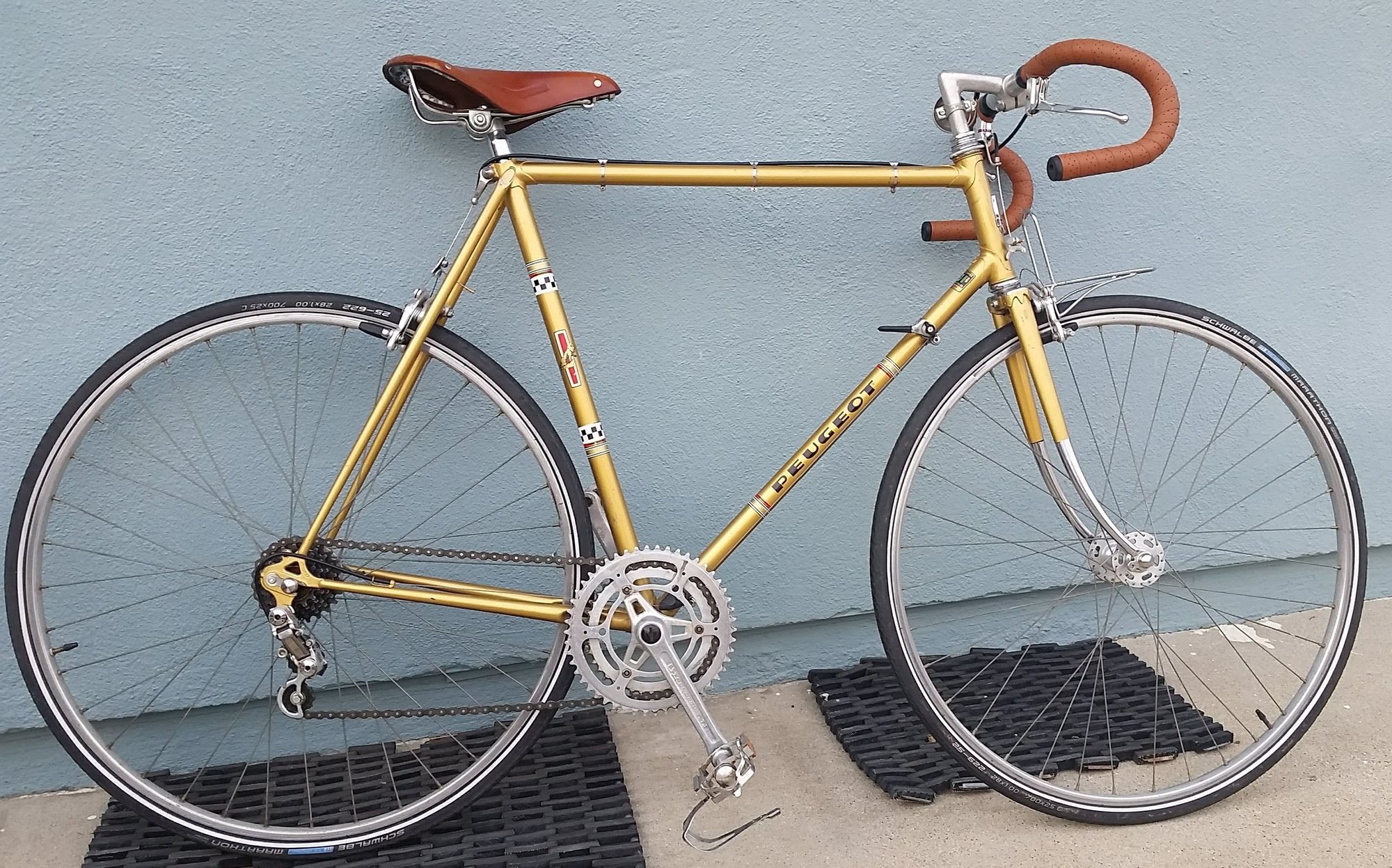

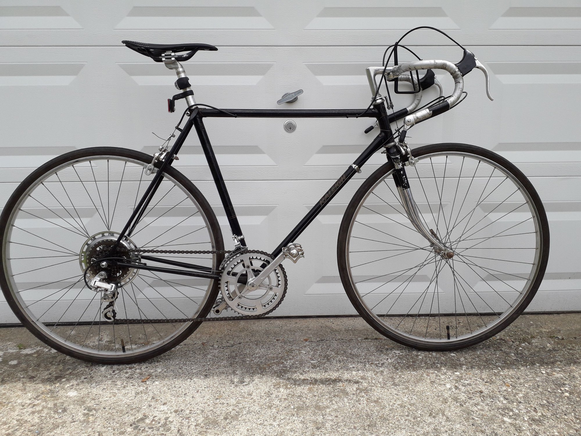

Tale of three cranks. I bought this Peugeot PR10 back in August with a Stronglight TS with a wonky pedal thread and some kind of acid etching damage on the ring (@ about 1 o'clock in below picture). I had a Sugino compact 52/34 laying around, so on it went a as an experiment. I liked the way it rode, but had several inside chain drops, even after repeatedly adjusting FD. It may have been a chain too long problem. I came across a great deal on a Stronglight 99, 52/40, which restored its Frenchness, and rides pretty well with the same 28t freewheel. I know smaller rings are available for the Stronglight 99, so I may be on the lookout for that. Lots of options, good luck with yours.
As bought, Stronglight TS (50/40 ?), broken (missing) Simplex FD, 24t freewheel.
Sugino GT compact 52/34, added Shimano Exage FD, 28t freewheel. I like the look of the Sugino crank.
Current set up, Stronglight 99, 52/40, IMO, best looking of all 3 cranks.

Beautiful TA Crank. Sell it and buy one more suitable to your needs.
Agreed, it's a lovely design. I had always thought that perhaps, having only three arms, it would be more prone to lateral flex. My wife had a set but her bike was stolen. Any chance you can live with a somewhat taller gear?
I always loved these cranks to look at. The fact that they spec'd smaller diameter bolts on a 3 arm crank though -- that is just so very French....
I wonder if the same people making titanium chainrings for these are also making replacement bolts? It would make sense. A good machinist should be able to make them, but the cost would be pretty high.
BTW it's very cool that someone loves these enough to make Ti chainrings just for these now rare oddball cranks.
