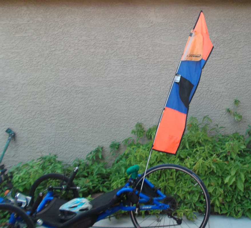

Visibility is NOT a problem with the lower trikes, don't let anybody fool you. I've ridden 7,000 miles on mine, I can think of only one close call, and that's because I wasn't paying attention.

I really get a chuckle about the comments about not being seen on a recumbent trike. It's not wise to slide up alongside a vehicle that might be turning right at a stop sign or a traffic light but that is true for any bike as well. If a driver can't see this trike he ought to turn in his drivers license and buy a white cane.
