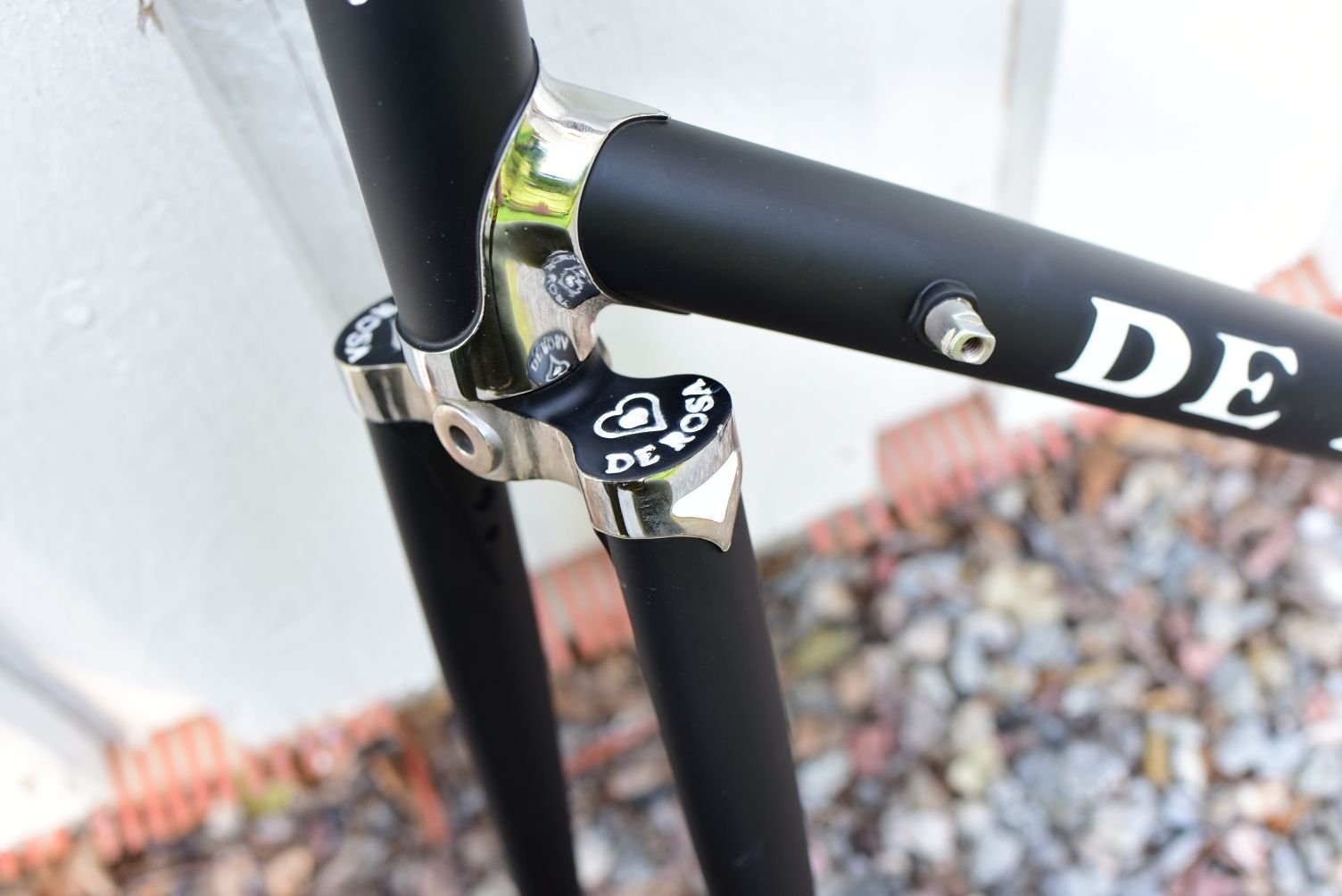

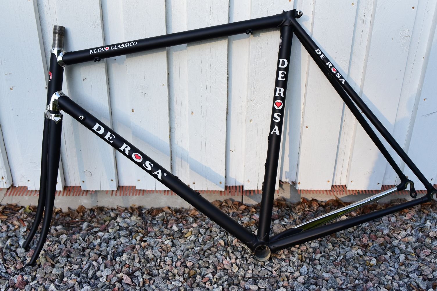

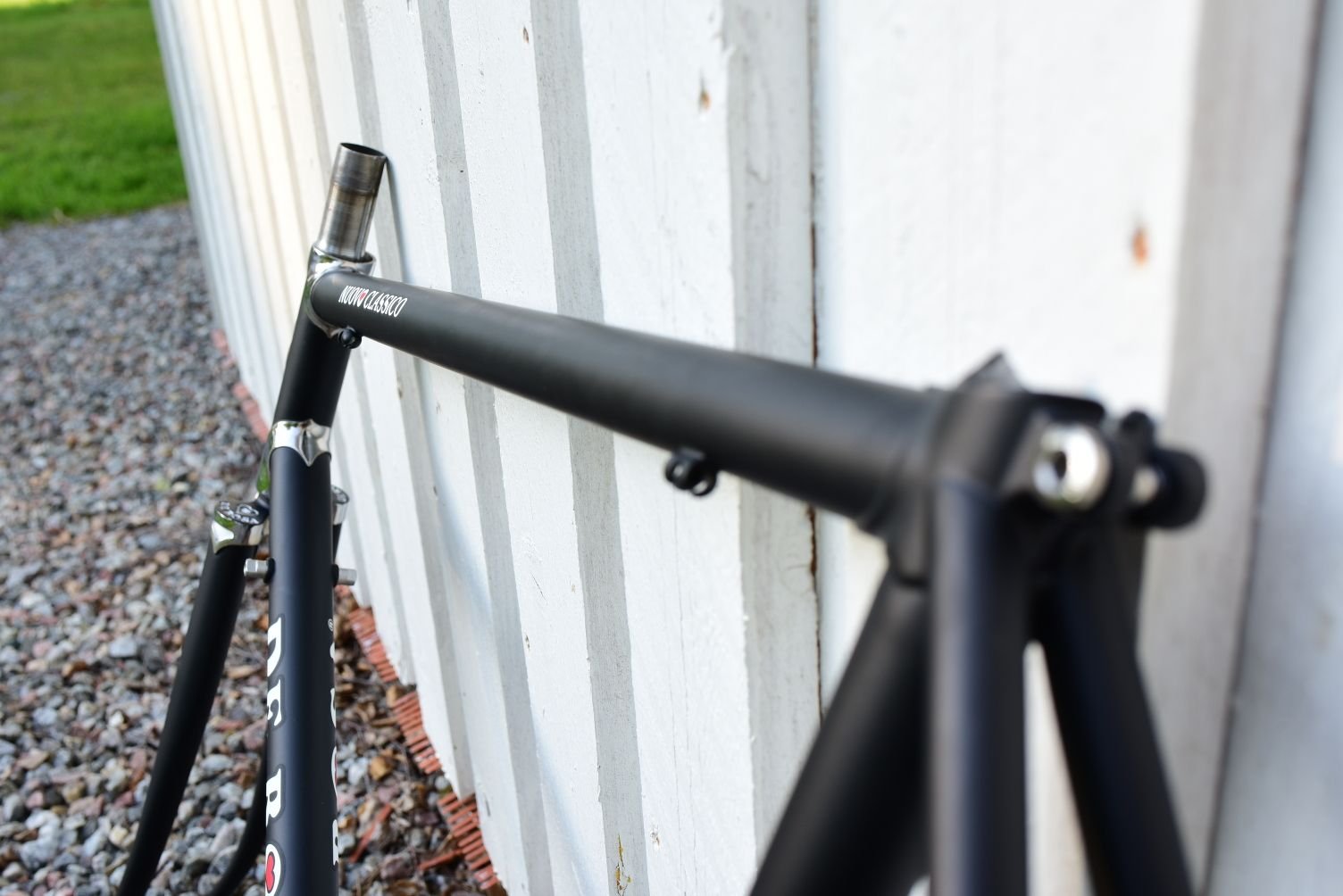

Hello fellow cyclists.
I have today recieved a frame apparatus that is made by hand in the land of italia.
its black in color. actually matte black. and the decals are clear-coated. its only the clearcoat that is matte obviously. Its not super matte. its about 50% matte if you compare to paint that you would paint your living room with. and about 7% is the mattest you can make it.
When i saw this frame i thought about that rock band mockumentary. "how much more black than that can it get"?? none more black!! heheh and its kinda like that. none more black!
so i decieded to head out into the garden and shoot some pix.
this is the last time its pretty!! because from tomorrow it will be my beater, dry weather commuter. My premium one will be the colnago still. I actually built up some wheels for the nago, and the lowly derosa will inherit the colnago shimano rs010 wheels (these are actually very good wheels, even though they are only 120€, you should check tension and adjust yourself though as always).
Yeah well the parts for this one is sub 1k€ total.
And the frame/fork was 1300€. its a 2016-2018 or so 55cm. NOS. coming from one of the derosa showrooms. Never built up.
One thing though. the paint seems to be like 100 times more durable than the colnago paint. this paint seems to be real 2 component hardening urathane/poly paint and it behaved like that when scraping it off the bb shell. the colnago seems to be jelly. pretty jelly though.
carlos danger is offline

steel is darned real and it also weighs mass. But somehow i have a feeling it will not make me any faster nor slower than the nago nor faster or slower than any plastic bike.

Nice frame! Are you gonna do something weird with it?

Allright ending the bike comedy (that phone pic though was very very funny).
I have managed to assemble the fork in the frame. And also the bb cups into the frame.
Then i lubed the inside of the frame with some industrial chain/wire spray. Since its steel and rusts. And it rusts from condensation too!
I now understand why threaded forks went away. First and foremost you need to "reem" the headtube (i simply taped sand paper on a rubber small drum sander thingy), and that would have been it pretty much for most aheadset systems, (then of course cutting the steerer to length.)
But now the fork had a cut notch in the rear that they made after the steerer was threaded, and that really messed with the threads. so i had to pull out all my needle files and go over that interface, 8cm or so worth of threads. Then the steerer needed to be cut to length very precisely since the top of the headset will rest on the top of the fork. VERY little wiggle room in length here.
I got a Record headset for it. Thinking this would be good. I mean its pretty light and all. they have steel races (cups and cones) pressed into the alu cups.
I degreased the caged ball bearings with different solvents until clean room clean. Then filled them with molykote.
I noticed a few things. The actual bearing races are not mirror polished like for example 15€ shimano hubs cups/cones are. but instead i could see faint grind marks, sure its not gonna be a problem but still, this is the most premium threaded headset i could find!
Then when assembled i found out its not really that smooth spinning. Even after all that work. I have had some cheapy ritcheys and cane creek caged ball ones that were much smoother than this, and those cost 10€, not 50! not to mention the headsets of my other bikes, the colnago branded one, cane creek s8/40/10, they were all moch smoother than this i can tell you. I now feel should have gotten the 7€ ritchey for it from crc, probably would have been better.
The headset itself also felt very flimsy and undurable. I'm thinking this will be the first headset ever i will have to periodically check and adjust just because its weak/flimsy.
ymmv i guess. I guess i learned something.
