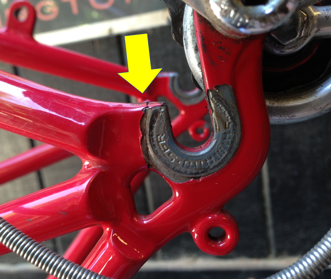

The color was nice; however, I chose it to highlight any cracks that might form. Multi-seat bicycles break if you ride them enough. Over the past 45 years of riding tandems we broke cranks, axles, freewheels, and plenty of spokes. We also had cracks develop in four sets of forks. The photo below shows the only frame break we had. That tandem frame was 39 years old at the time of the break. After a repair we rode it for another three years.

Old 04-29-19, 09:08 AM
wsa30h
tandem cyclist
Join Date: Nov 2016
Posts: 23
Quoted: 7 Post(s)
i guess that is a valid reason for that color as well.
