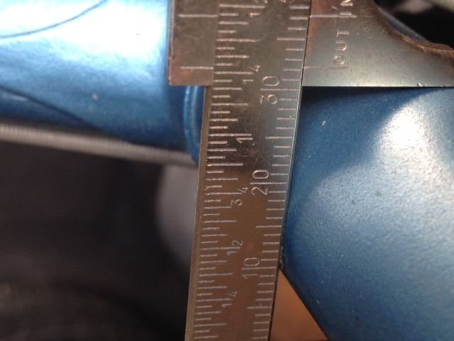

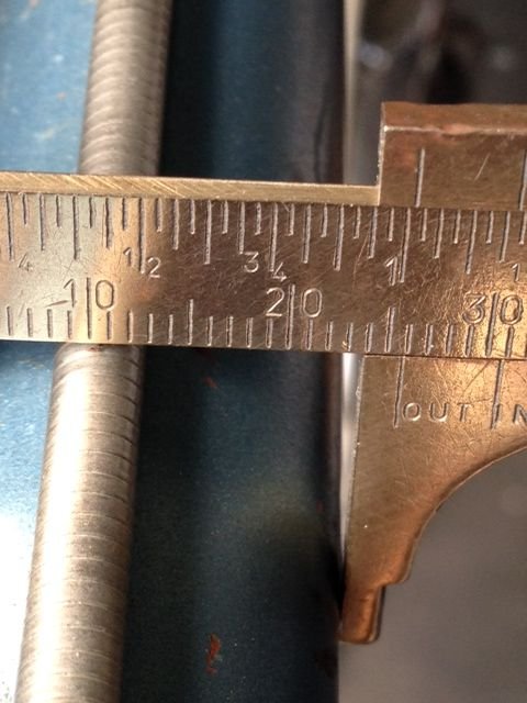

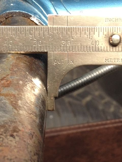

Update w/Measurements
Finally finding time to get back to the project....
Here are the measurements...
Seat post:
Top tube:
Seat Tube:
Head tube:
...and a little better detail of the seat stay details...

Hello again Ottomotion,
Thanks very much for the additional information and pictures.
The top tube and seat tube measurements are what we would expect: 26.0mm and 28.0mm.
The seat post measurement is smaller than would be expected.
As I read it it appears about 25.4mm; is this how it appears to you?
This is a size associated with hi-tensile frame tubing.
Several things can contribute to an artificially small measurement.
a) steel sheet pillars often get deformed to out of roundness
b) someone may have fitted a pillar which is too small
best to remove pillar and seat binder
see if binder ears have been pinched down
if so, gently prise them apart
examine interior of seat tube top for rust, paint or other foreign matter
when top of seat tube interior is clean take a measurement of its inside diameter
would expect that if you follow this procedure you will get a larger number, likely no smaller than 26.2mm
unfortunately this does nothing to advance an identification!
