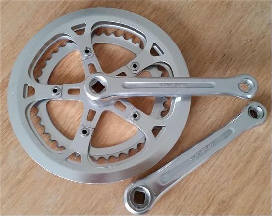

Those are fine components. The sugino AT triple is a fine and sought after triple. The cyclone derailleurs were terrific derailleurs. The lettering on them didn't last. They are often paired with suntour barcons.

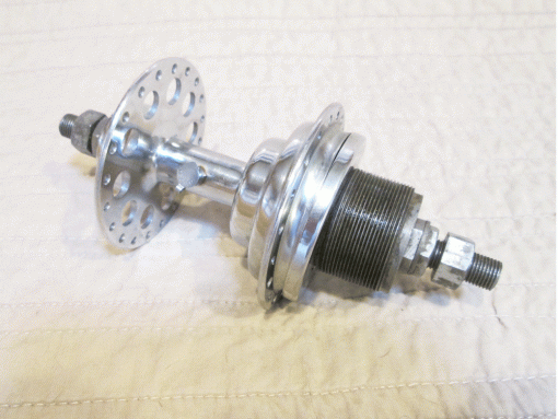

The wheels are nicely spec'd as well. Gyromaster hubs are likely cartridge bearing, https://www.bikeforums.net/classic-v...ster-hubs.html

You don't need to worry about overhauling them if they turn freely if they are cartridge bearing.

Aside from what Sheldon Brown states about the Sugino AT triple crank, what about it makes it so sought after?
I have a Shimano 600 6207 and Sugino AT crankset and they both function well. But I can't see why one is more sought after. especially since Sugino makes even bwtter cranksets offered by Rivendell
People like the sugino AT crank which is why they are sought after. That's a truism but it is what it is and that is what the OP asked about.
I like the shimano 6207 as well.
The real difference between cranks is whether they are cold forged or not and how hard the chain rings are. I don't have the data on these cranks but I think they are both cold rather than melt forged.

As Miguel said- the AT is a cold forged, 110/74 BCD, gracile and beautiful crank set- with the model stamped into the arms.
This crank was designed in the “aero” era (AT = “Aero Tour”) - as such, it has the sculpted arms and spider arms that “slice” thru the air all aero-y. This had the benefit of having Sugino’s engineers make it pleasing to look at. It also was one of the first, if not the first 110/74 triple crank sets- setting a standard. And since it was cold forged- it was among the strongest of cranks. There’s other cold forged Sugino cranks- these are just a beauty.
The 6207 crank is also very nice- I’d put money on it being cold forged as well- my understanding is Shimano bought up Takagi to get their forging technologies and equipment- but it does bear out that Sugino cranks went on the Top Of The Line tourers- and the 6207, regardless, went on the “lower” specced bikes. BTW- the 6207 is finished much nicer than any of the Takagi cranks I’ve had.
This would be a good question for @T-Mar. How long after the introduction of the Sugino AT did the Shimano 6207 come out?
IMO- the Sugino AT and their other triples based on the AT are nicer looking than any of the newer Sugino cranks- maybe it’s just the logo... I don’t know...

The Sugino AT and TAT (Triple Aero Tour) came out in 1981. The TAT's claim to fame was the introduction of the 74mm BCD allowing for a 24T granny gear. Prior to this, the smallest Sugino chainrings, without going to adapters, was 32T. However, the true brilliance was incorporating both bolt circles on the spider, allowing for a larger spider and less chainring deflection. Prior to this, triple cranksets mounted all three chairings to the same bolt circle or used the TA approach and bolted the middle and inner chainrings to the large chainring. These approaches compromised the granny gear size and/or chainring deflection.
Shimano released the FC-6207 New 600EX crankset in 1984. However, it's not really fair to compare it to a TAT, as it was a double crankset. Shimano's 6200 series triple was the FC-6206. It also used a 74mm BCD for the granny gear but was typically spec'd with a 28T, as Shimano was pushing their Biopace chainrings and this was the smallest Biopace chainring that a 74nn BCD would accommodate due to the ovoid shape. I can't recall seeing any specs as to construction but weight was comparable to the TAT, so I'm assuming it was also cold forged. So, the TAT had a smaller granny gear but the FC-6206 had Biopace.
Early 1980s Japanese grand touring bicycles were typically SunTour equipped due to several advantages. First, they shifted better, courtesy of the slant parallelogram rear derailleurs. While they shifted better at all gear ranges, it was more noticeable as the gear range got wider. Also, the SunTour wheels were more versatile If you wanted, you could get 38T. Shimano topped out at 34T. Finally, you could a 34T Ultra-6 from SunTour, so you could get an extra cog without giving up wheel strength, which is important on heavily loaded grand touring bicycles. Things would skew in Shimano's favour in 1986, when they brought out index compatible, wide range derailleurs with slant parallelograms. The mid-1980s seal failures on the SunTour Mountech rear derailleurs certainly didn't help.
Normally you'd think that with SunTour's supremacy, that Sugno cranksets would also hold the high ground in the grand touring world. However, this was not the case prior to the TAT. Many Japanese grand touring bicycles of the very late 1970s actually spec'd the SR Super Maxy Tour, simply because it could accommodate a 28T granny gear. Personally, I believe this was the real impetus behind the development of the Sugino TAT. They simply wanted to one up SR and gain market share by going 4T lower.

however, the op does indeed have a freewheel hub, as he has now mentioned it has gyromaster hubs and suntour perfect frwweheel.

I have a set of NOS Shimano 600EX 5 speed cassette hubs with a March '79 date code (DC). 5 speed freehub was oe spec for my '81 Kellogg Ross Signature Touring.

Wow cool catalog. Blast from the past. Yep, I totally forgot they started to introduce cassettes in the latter half of the EX period. My 78 Masi was Dura Ace EX equipped from the factory (very unusual at the time), but still had a conventional freewheel rear hub. It's funny the things Shimano emphasizes as being advantages. They barely hint at the improved axle strength due to the bearing placement, which to my mind is the biggest advantage.

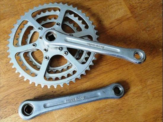

Wait, I thought Sugino made the Super Maxy crankset:

I went out and bought a Dura-Ace EX freehub as soon as they were released. I had suffered from bent axles to point where I installed Campagnolo Record track axles on my Record rear road hub. Shimnao's cassette freehub ended my woes.
SunTour had a failed attempt with a freehub (and indexed shifting) in 1969. SunTour called their product a Unit-Hub. However, it was preceded by Bayliss Wiley of England who had a Freewheel Unit Hub, as early as 1938. Reportedly, it was very popular with tourists and survived through the 1950s. There may have been even earlier cases but if so, I have yet to stumble across them.
My bad! Of course, you are correct. I meant to type SR Super Apex, not Super Maxy!
