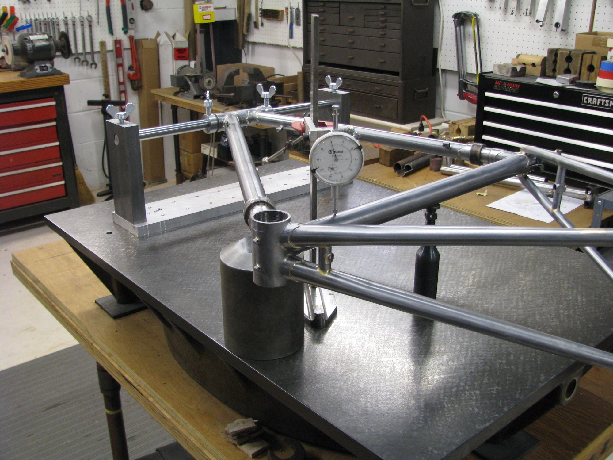

To Tangent- My headtube holding set up for the flat plate was made by Alex Meade. The two towers were about .001" different heights! Close enough for horse shoes, nuclear bombs and bike frames. I placed a .002" shim under the taller side and a .003" one under the shorter's base. Here's a shot with it, note the whipping post is just looking on. It's thinking to it's self "who does that pretty thing think it is? All shinny and useless to do any real work?" Andy

Interesting. I guess I could pull the headtube section from my Bringheli jig to do that. I'll ponder this more.
Yep, those are the pieces I'm using. Your bar appears larger diameter and you have them spread further apart and on a base but otherwise, likely the same pieces. I like the idea of a base so the uprights don't fall over on the plate.
