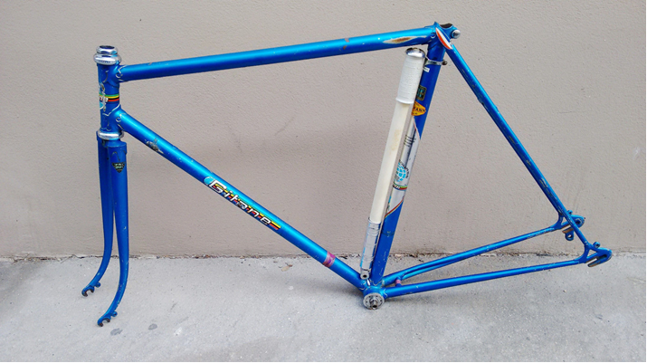

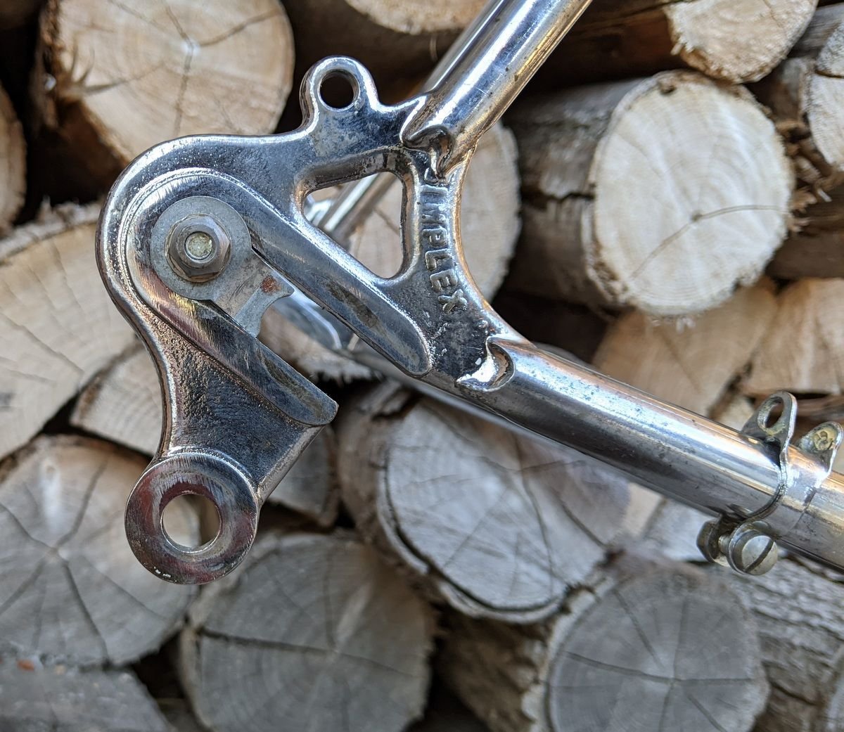

Originally Posted by orcas island
Not sure whether this claw was added later or whether this was the way it came from the factory?
The original RD would have been a SImplex Criterium that mounted to the hanger as pictured below. It appears the original Simplex hanger may have been sawn off your frame. The Cyclone with claw would be an add-on.
Well, it's certainly possible that an original hanger was sawed off. But many TdFs also came with plain dropouts (that is, no integral hanger) and a claw. If the OP removes claw that's on there now and take a photo of the bare dropout, we might be able to tell whether it's been modified or not--in the photos that have been posted so far, the claw is in the way, making it impossible to tell.

Nice find, and replacing handlebar/stem/levers shouldn't be a problem. FWIW, Simplex did make a forged rear dropout that did not have a derailleur hanger--I have one like that on a Jeunet, that came with a Simplex derailleur, and I switched to a Huret. So while yes that one was probably cut down, you can still feel authentic. NICE saddle, aren't those quite expensive all by themselves? I have a similar Gitane from a different model year--the one with the honeycomb huret dropouts--but it is otherwise very similar (fishmouth treatment at dropouts) and rides very nice....
Sawn - look at the curved edge of the hanger just starting to go down for the mech mount, at the back of the claw:

From eBane:
Yeah, it sort of looks like it was sawn. Hard to tell, though--a photo without the hanger in the way would probably provide a definite answer

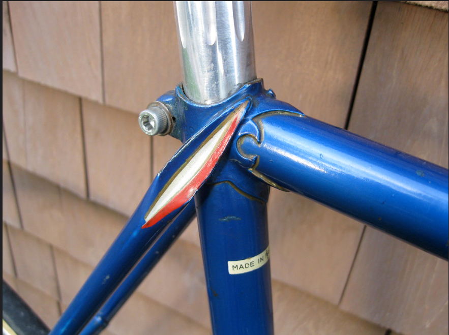

Originally Posted by jonwvara
Well, the crudely pinched-off ends of the seat stays where they're brazed to the seat lug are a little bit of a kludge, too, especially compared the the nice willow-leaf caps on the earlier models. But that's part of their charm, I guess. As everyone else has noted, they sure ride nicely.
I always find myself passing on the Gitanes with the swagged seat stay ends, nothing functionally wrong with them but when compared with the much more elegant seat stay caps seen previously, whether they are the earlier fitted cap (seemingly always tri-color) or the Carre-style willow leaf that followed, the swagging just looks expedient and cheap.
And some with Campy rear dropouts, while typically only on the SC frames, it's not exclusively true depending on the years.

Originally Posted by Markeologist
I always find myself passing on the Gitanes with the swagged seat stay ends, nothing functionally wrong wit them but when compared with the much more elegant seat stay caps seen previously, whether they are the earlier fitted cap (seemingly always tri-color) or the Carre-style willow leaf that followed, the sagging just looks expedient and cheap.
It was expedient and cheap. That was the point. For sure, the capped seat stays are beautiful. I had to buy a Lejeune frame last year because it had those caps (and because it was my size and a great frame in all other respects).
Whose face is that on the seat tube on those first two images? I don't think I've ever seen that on a Gitane.
That's Jacques Anquetil, who last rode for Gitane in 1965...thus these two frames with his face date to no later than 65. I have a CdM with the fitted cap painted in tri-color too BUT with foil decals instead and no Jacques. I figure my frame is 1966...maybe 67.

...there is also an earlier style of swagged seat stay finish seen on Gitanes and Geminianis (both MICMO brands prior to 1966) where the metal flap after swag was cut was crimped and a diamond-shaped finish was created that emulated the higher end fitted cap pretty well. I've seen them in tri-color as well as with a pin-stripe design. They are a bit better looking than the later swagged finish where the remaining metal flap after swag was cut was simply folder over and brazed shut.
...there is also an earlier style of swagged seat stay finish seen on Gitanes and Geminianis (both MICMO brands prior to 1966) where the metal flap after swag was cut was crimped and a diamond-shaped finish was created that emulated the higher end fitted cap pretty well. I've seen then in tri-color as well as with a pin-stripe design. They are a bit better looking than the later swagged finish where the remaining metal flap after swag was cut was simply folder over and brazed shut.
Wow, learning a lot about pre-bike-boom Gitanes here....
From eBane:
That's the money shot there, corner of hacked off hanger.
I know a guy who could fix that.
Yes, agreed.
