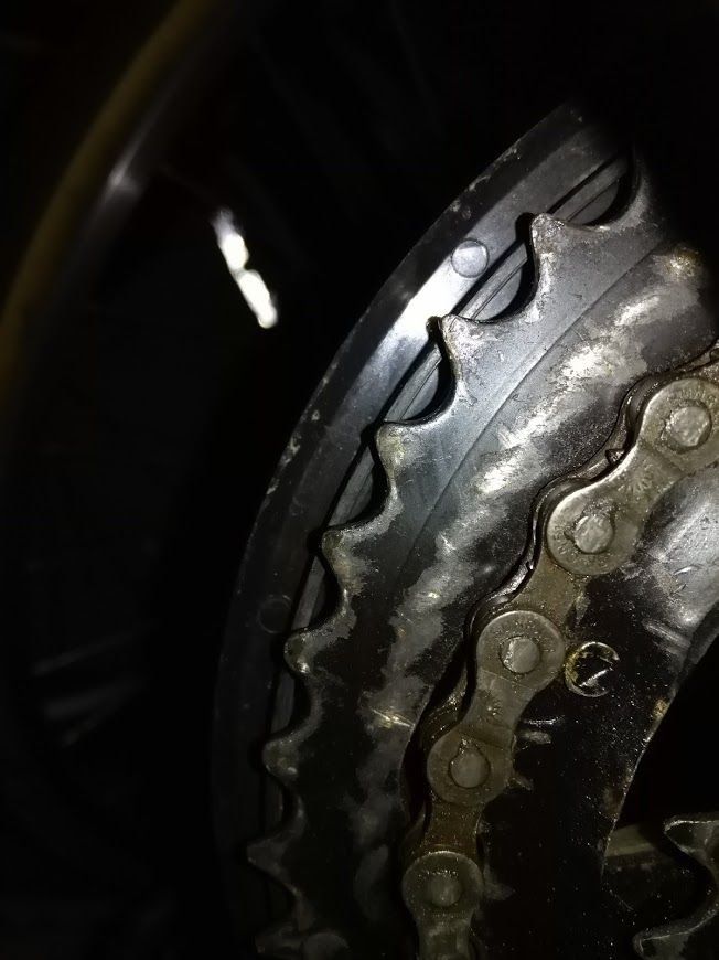

I have a 21 speed low end MTB (Mongoose/MGX S20) which serves my needs perfectly but now the chain slips when I am in the largest chain ring and climbing a slight incline. I thought that the chain was stretched and reduced it by 1 link and it made a very small but negligible improvement. Am I looking for a new crankset? I measured the chain and the pics are attached. In 6" there seems to be exactly 12 links to/from the edge of the pins. The middle and smaller chain rings work fine. The teeth on the large rig do look worn.

Chainrings have to be seriously worn before they will cause skipping. Yours doesn't look that bad to me yet. The teeth look real pointy when badly worn.
Since you've been messing with the chain, I'd check for a tight link if, for no other reason, it doesn't cost anything.

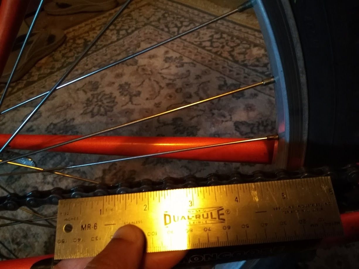

I checked the chain for stiff links and there are none. The chain length seems to be correct too, there are 12 links in exactly 6 inches indicating not much stretch.

Looking at the last picture, your measurement looks like it is stretched. Your zero is not nearly on center with the pin, nor is the 6, or pin edge to pin edge. A new chain is relatively cheap. I'd also say that your chainrings ARE worn. Just replace the big ring.

Edit: you normally measure 24 pins across 12" to get a more accurate measurement of chain wear. You can see (again, if I'm interpreting your photo correctly) significant wear across only 6". It looks like 12 of your chain pins measure about 6-1/16" or so (or maybe even 6-1/8"). 24 pins would probably measure between 12-1/8" and 12-1/4", which is way beyond the acceptable measurement. Bike Radar (below) says that any chain with a measurement of longer than 12-1/16" should be replaced, and anything beyond 12-1/8" is worn to death (their words), and a new cassette or freewheel is likely needed as well.

2. 6" is not long enough to determine wear, especially if the chain is not under tension. 12" is the norm.
