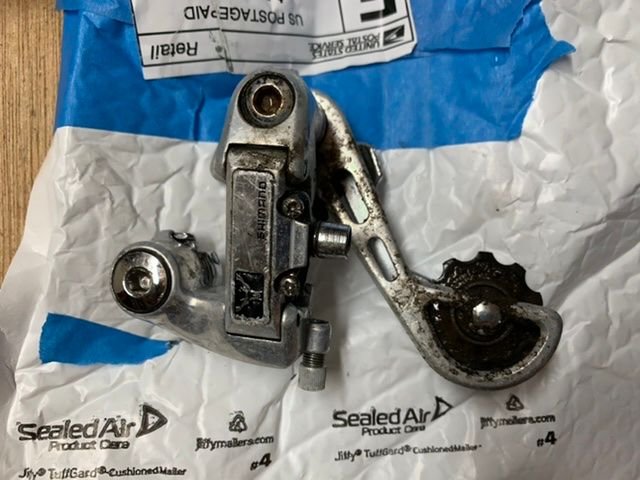

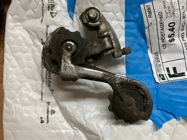

Recently, I bought a Shimano Deerhead rear derailleur from cog_nate , priced very attractively because it was a dirty mess. Here’s what it looked like upon arrival:

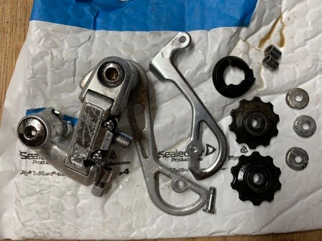

Certainly better, but still needing more Ultrasonic time. I disassembled the pulleys and gave it all another couple of 30-min rounds of cleaning:
I then reassembled, lubricated any of the threaded parts and sprayed some WD 40 into the spring housing to displace water, and ended up touching up the faceplate with some black paint as the soaking removed that finish. Then a final polish with some Simichrome:
It’s not NOS but more than acceptable to my standards, perfect in terms of functionality, and one of my favorite high-capacity friction RDs. Thanks, Nate!
