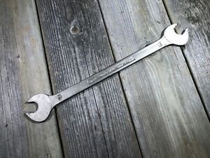

I use a 15mm wrench that I thinned down a bit with the bench grinder.
Originally Posted by notmyke View Post
I just recently took a 15mm open-end combination wrench out of a set (VW does not make use of 15mm fasteners - so it will not be missed ), and put it onto my grinding wheel to narrow the head from about 7mm thick down to maybe half that. Tested on a set of old Look pedals and some SPDs - works like a charm. Total cost: $0.02 (in electricity, I'm guessing).
Same here, it allows for a wider bite on the pedal axle. Mine's from a long reach wrench set, so my 15mm is 11" long. So far, so good.

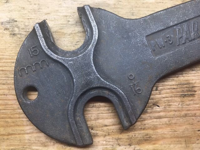

My PW-3 is Thicker
Originally Posted by enock111 View Post
My personal favorite is the Park Tool PW-4. I made this video going through and demonstrating every Park Tool pedal wrench ever made. Check it out and let me know what you think. https://www.youtube.com/watch?v=MVKBemXxbHM
My PW-3 looks different from yours, and from the current version. Note how the areas around the openings are thicker. Anyone else have a PW-3 like mine?
