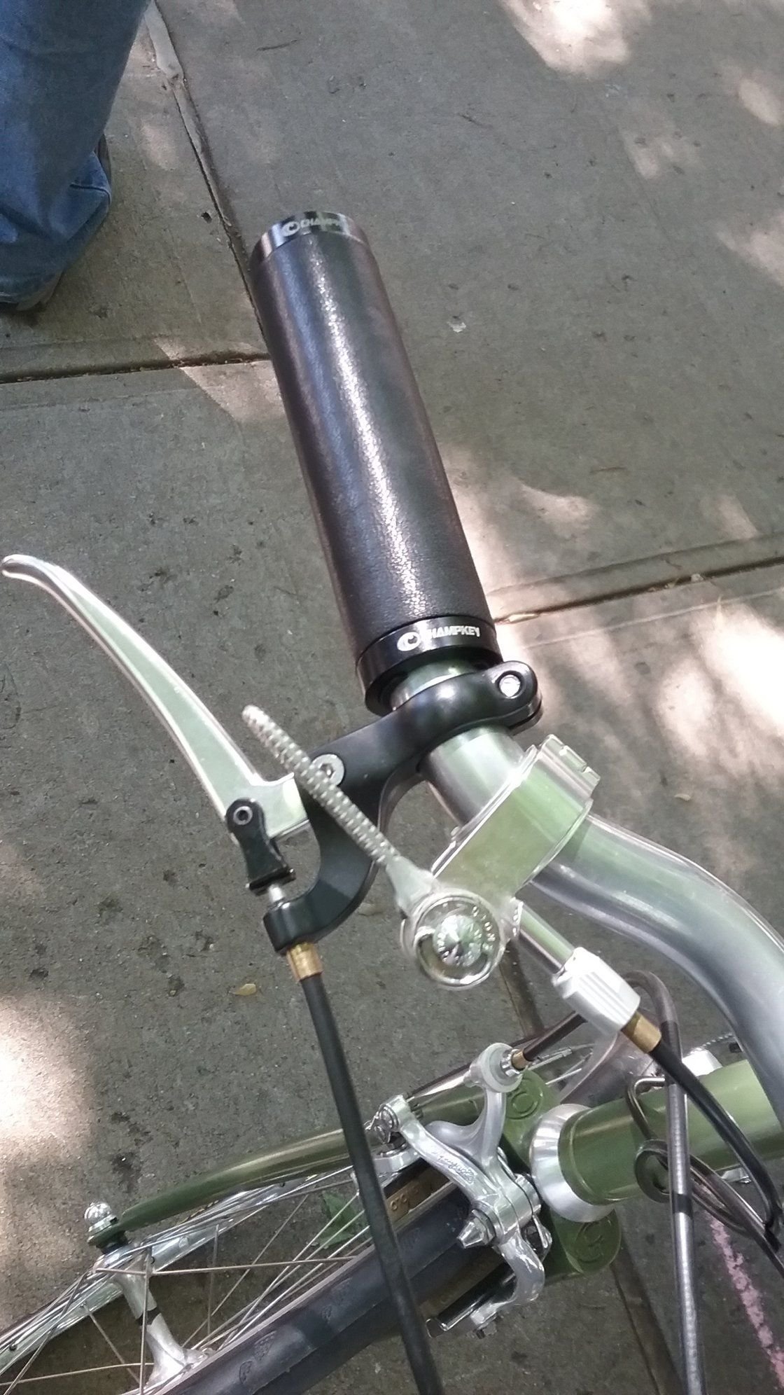

And I couldn't post photos until my 10th post so here they are!
The end result!

SkinGriz
Live not by lies.
Join Date: Nov 2020
Posts: 1,306
Bikes: BigBox bikes.
Quoted: 860 Post(s)
Liked 784 Times in 582 Posts
Looks great!
What bars are those?

Looks great. Im
trying to convert my Merlin to commuter

is that bike light? I love the bars and wonder how they would work on my trek 700.

The bike belongs to @hellopizza, however, a Lemond Buenos Aires with 853 tubing should be pretty nice.

Originally Posted by SkinGriz
Looks great!
They're Wald 867. I believe they call them their "touring" bars.
