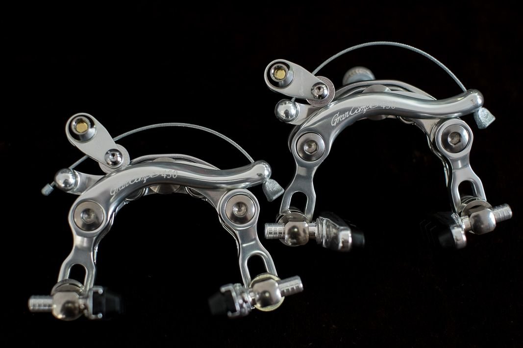

https://www.ebay.com/itm/Dia-Compe-G...ePsMvT-lp-nU_g
the pad holder and brakes pas seem to be like shimano model.

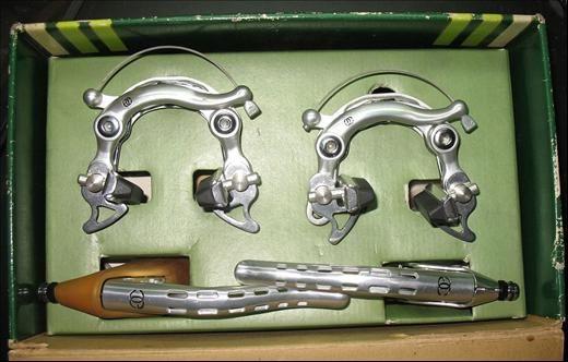

brooklyn6640-
Your link looks to be a newer, reissued version of the brakeset. My experience is with the older, 1980s version shown here:
The ad you referenced is a newer version which looks similar but may be different in details like brake post diameter and brake pad size.
