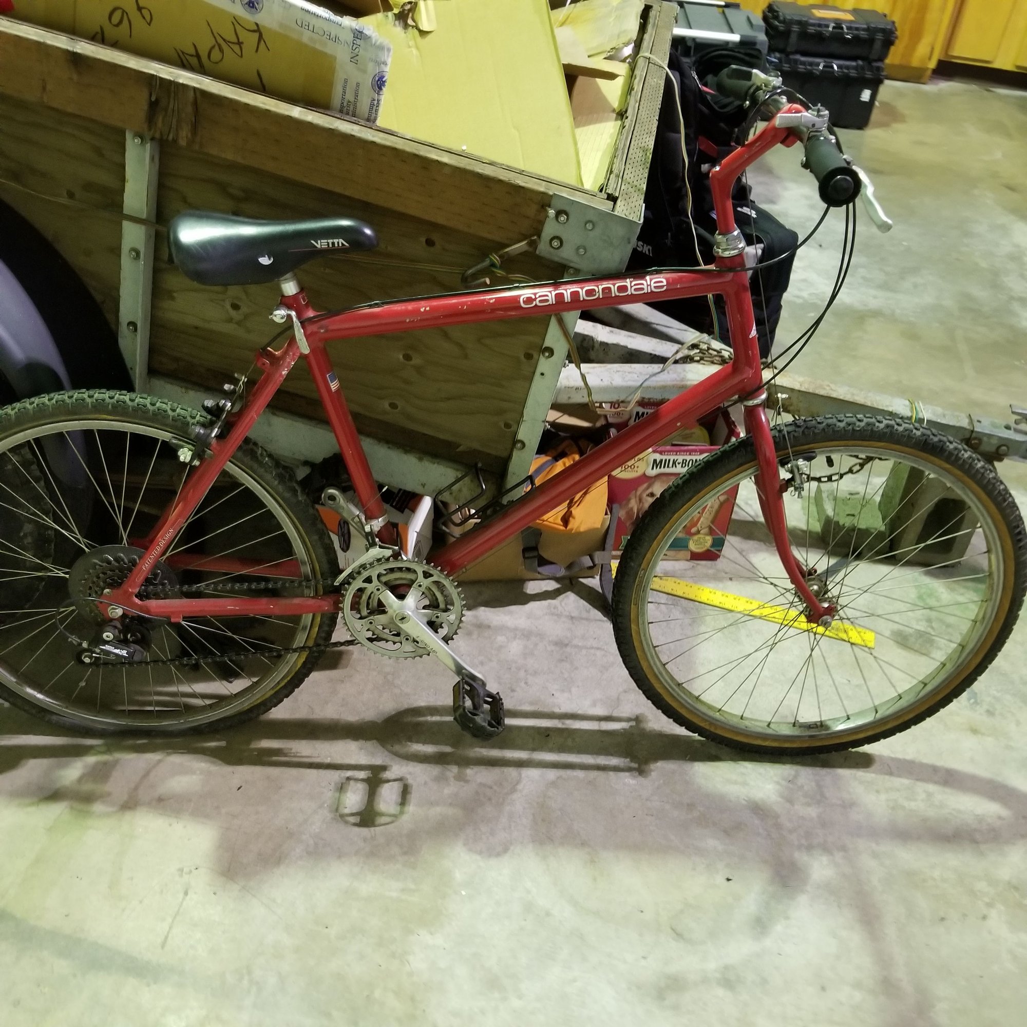

Picked this up for 10 whole dollars at a garage sale.
I was a teenager once, not that long ago in fact, and I or possibly friends may have seen this as a good idea. I was and kids still are stupid sometimes (I dont know but I can only assume this was a group of 12-16 yrs olds) Haha
So they put a skateboard on it as a dumb unusable rack, I'll just take that off and see how it rides.

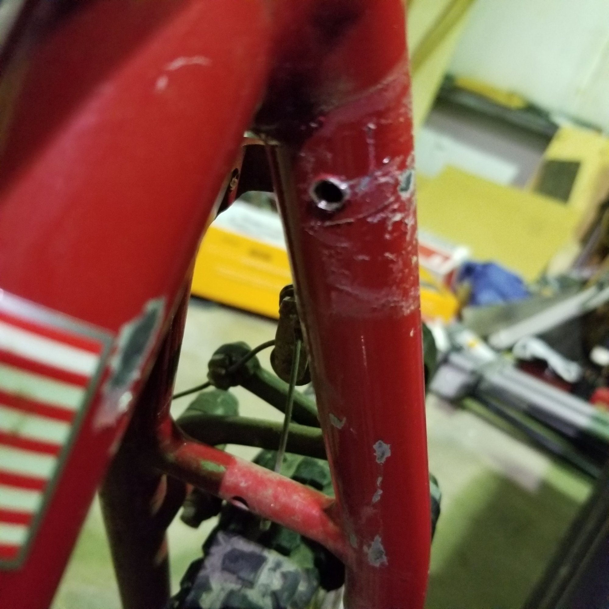

They put metal screws into the seat stays! Just drilled straight into the frame. One of them isnt even straight it went in at an angle and left a jagged wonky hole.
So that was disappointing...
I dont quite think this thing is structurally sound anymore...
I know an old SM(?) Cannondale MTB isnt anything to special but I was hoping to ride it around a bit as I really enjoyed an 84 24/26 I had for a bit.
I did notice that it has Suntour Accushift derailurs and index shifters. I really like the set of suntour thumbies I have, how are these? I have an MTB that may take this wheel or gear cassete so I could try it out.
It's a shame because I think it could've been a fun ride, maybe a beater commuter for the winter.

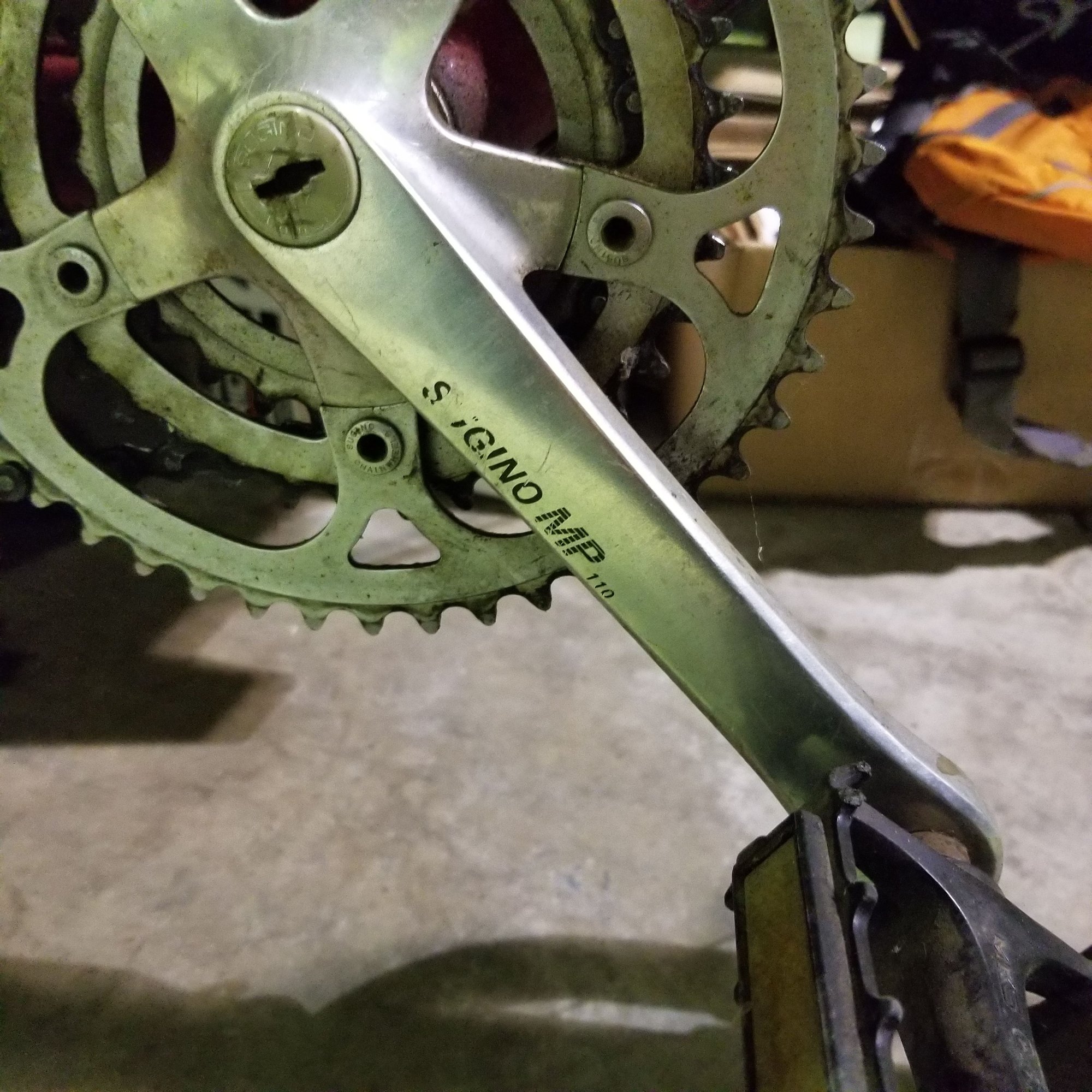

The journey cost me 10 bucks and I got some nice(?) shifters a sugino crank and a very red very tall quill out of it.

I'd just ride it, personally. I have an 87 Cannondale SM400. Those frames are so overbuilt, I think it would take more than some youth's misguided ingenuity to destroy it.

Options ride it as a winter beater, what do you have to lose? ok maybe the rear triangle will buckle but I doubt it. Or strip the parts scrap the frame and you still have $10 decently spent you could always donate what you don't need to your local bike co-op.

I'd just part it out and recycle the frame. You'll get your money back with the fork if you sell it. I would obsess over the damage too much to be comfortable riding it.

Layer aluminum beer can strips around the damage with 2 part epoxy, touch up the paint and ride the bejeezus out of it. What could happen?

I'd 100% ride that as-is. Fantastic find, if it's got to have one thing wrong with it, it's better that than say, a trashed rear wheel or missing that color-matched stem. Color me jealous - I've got a hair-brained idea that a 24/26er would make the perfect commuter.

I would probably ride it too, but I am a small guy and it would see mostly road use.
I would fill the holes with Bondo or something, and touch them up. Eventually you would more or less forget about them.

I don't see those holes as a likely trouble spot myself, and the rear triangle won't "buckle" because of the holes.
Yeah, maybe after years of riding this a crack might form at one of the holes, but as likely some crack will have started somewhere else imo.
They used pretty thick tubing on these, needlessly thick almost everywhere, just so that the welding would be less likely to compromise the tubing.
If you are still worried about the drilled tubing, just inject structural epoxy in the hole to fill the last inch of the tube inside. I've done this to repair a carbon chainstay that had suffered an impact with resultant contusion (soft spot), I put JB Weld in a syringe and filled the lower end of the chainstay and it's stronger than new.

Put the rack back on with the same screws. That should button it up.

I was hoping lots of people would say "dont stress it, probably be fine." Because that's what I've been telling myself the more I look at it Haha
Were gonna give it a shot and see how it rides. Worst case ive got some nice spare parts. Best case I've got a gem of a winter beater.
I'll consider it an experiment, we wll see if the welds or the holes give first Haha
