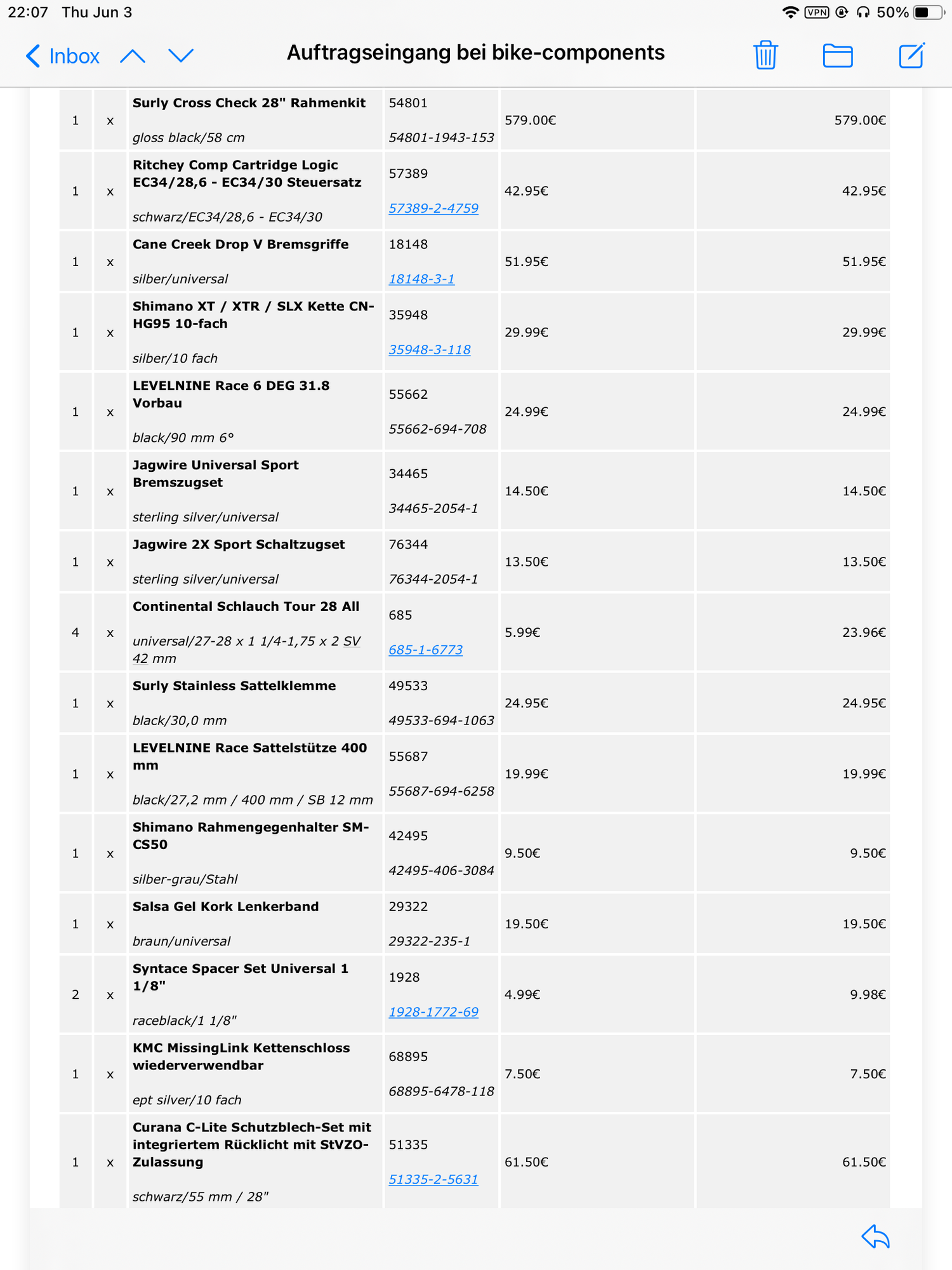

Looks like Surly finally got some frames flowing to Europe again after being out of stock for the last eight or so months so I ordered a frame a fixings this morning​​​​​. Are there any gotcha’s or Surlyism’s I need to worry about before Monday?

the frame will be here Monday and is there anything special I need to look out for?

It’s getting a full 10 speed XT group to include the hubs which are 135.

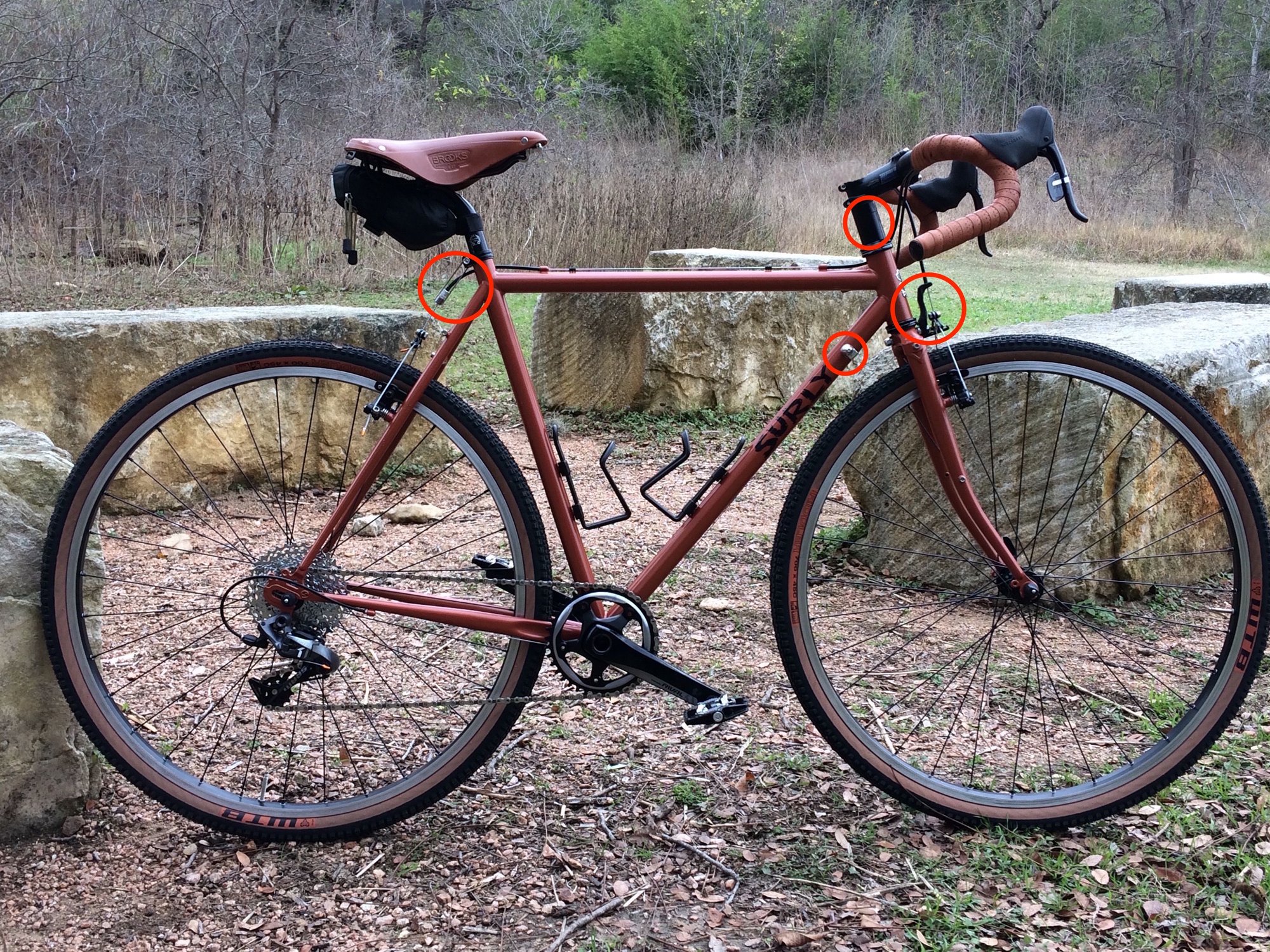

Oh, and you'll want to get a couple of those things that cover the downtube shifter bosses, and brake cable guides front and rear if you're using cantilevers.
I ordered the down tube cable stops in the initial order I plan on running a set of XT V brakes with salmons like I do on my Bruce Gordon.

Originally Posted by Rolla
Don't cut the steerer tube until you've ridden the bike a lot with various spacers and stems; Cross Check head tubes are notoriously short.
You might want to order a Hurdy Gurdy tensioner to keep the rear wheel from pulling forward under load.
Decals are on top of the paint, so you can scrape any/all of them off if you want a cleaner look.
This right here. Hopefully your steerer doesn't come pre-cut (I assume that's only on full builds, right?). They can be "hard to fit", but I love mine even though I keep messing with the fit, years down the road. And I recently put a Hurdy Gurdy on my ss 'Check--an excellent little gizmo--makes tensioning super easy.
EDIT: glad you kept the steerer long! I wish I could find a Cuba Libre brown CC fork, uncut, for mine--I'd buy it in a heartbeat.
