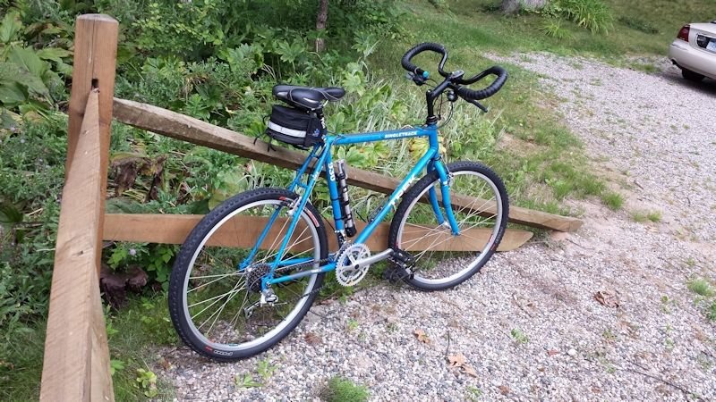

As has been pointed out, it's a '92. Here's mine.
That bike and others like it are a very flexible platform. When I took this picture I had trekking bars, but later converted to drop bars. These make respectable touring frames, but because of the higher bottom bracket it's not going to be as stable under really heavy loads as a purpose-built touring bike does.
Grouchy Old man
That does look heavy. I have a steel shogun frame, that needs stripping and painting. Thanks for the answer. That helps me better understand things.
