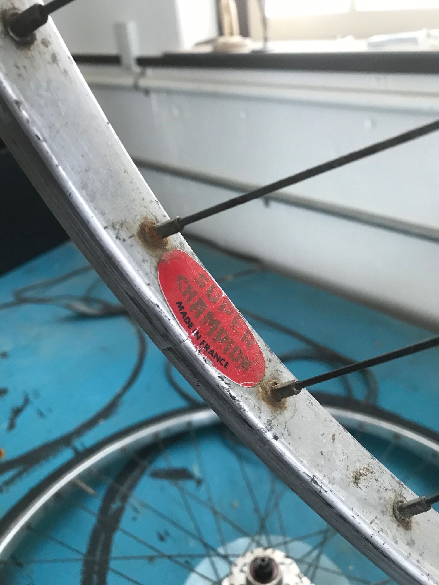

On the way home from riding a 200K with Rudi in New Jersey I picked this bike up. The owner said that he bought in used from the original owner in around 1972 or 73 and made some adjustments. This was in Queens, NY but he really didn't know much about it except that he rode it for a bit in NYC around that time period then put it away until now. I haven't seen much LeJeune related info online but from what I gather it may be a Pro from the late 60s-early 70s. The original tubular wheelset was replaced with a bolt-on set and the bars were replaced with upright bars. Simplex Criterium derailleurs, Stronglight 93 crank, Mafac Racer brakes and 531 fork sticker. I will update this thread as the project slowly progresses and any and all info that other members may have is appreciated.
Untitled by irishbx4th, on Flickr

Cool bike. This was on eBay, right? I saw it and was tempted but the seller didn't want to ship and I have my share of French bike projects.
I'm glad you got it. This will be a fun build. Signing up.

Maybe a LeJeune 101. This catalog may help. Lejeune catalog (1971-1972)
Page 2 is maybe of interest to you. 3rd bike.
@CV-6 may still have a copy of this catalog, can't hurt to check.
Also see, starting here, scrolling right: https://www.flickr.com/photos/cv-6en...n/photostream/
Specifically of interest, note this page: https://www.flickr.com/photos/cv-6en...n/photostream/

Have a Lejeune Nr. 101 which I believe to date from the 1973-74 time.
Interesting to see the differences. Fittings on mine are the same save for the chainset. It is fitted with T.A. Trois Attachees.
Lugset is the same Prugnat 62/d.
It has a Vagner flat top crown and different transfers. Finish is red flambouyant rather than opaque.
Look forward to reading the observations of our favourite aircraft carrier...

I would call it a Pro, at the earliest 72. It is pretty much the same as the first Lejeune I bought in 72/73. Derailleurs, brakes, crank all match. Mine has the more colorful "Championat du Monde" decals and the fork crown is different. Yours would likely have had Pivo bars and stem. Normandy Luxe hubs and Super Champion tubular rims. It will ride nice.

greg3rd48 -
It looks like one of the Carre workshop frames built for Lejeune. Very good basis for a restoration.
OK so I may be close on my identification. I am not sure how stock I am going to go with this build but I will definitely keep the Mafacs and the Stronglight 93. I will probably swap out the Simplex and store them due to the fear of Delrin. I need bars, brake levers, stem and wheelset but that will either come from my parts bins temporarily or I will have to wait. I am glad that I bit on this one.

Remove the seat binding bolt kludge- underneath may be room for a socket head cap screw ( of slightly smaller head diameter than an 8mm standard socket head metric screw )
and if so, probably bunged up threads on the other end. If that is the case, a helicoil is you friend. if you do not want to buy the tooling, source a machine shop that rebuilds import cars or motorcycle engines.
A bolt mounted in a drill motor and run against a grinding wheel should get you to the diameter you need if you don't know someone with a lathe. If you have access to a lathe, add a small chamfer to the outer end of the bolt head- as original.
I think 73-74 the Simplex rear mechanism usually has a date code on the cage.

Here they are. Even have a dork disc included. Skewers do not match. Rims are Rigida 13-19. Schrader valves.

Thanks very much for writing back!
These red labels launched 1973 so if bicycle determined to be that late they would be plausible.
Also the red label hubset from @jetboy.
If bicycle determined to be as late as 1973 the Maillard 700 would be an option as well.
