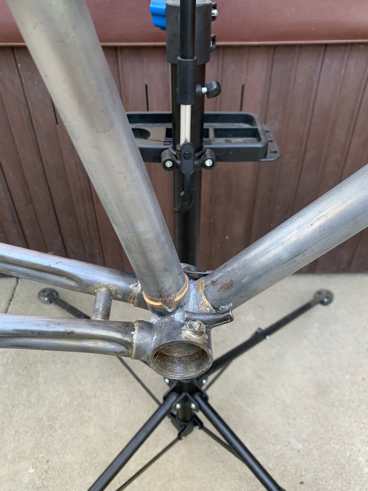

Below is the frame in the condition that I got it. You can see that the frame was straight but also that it had plenty of rust.

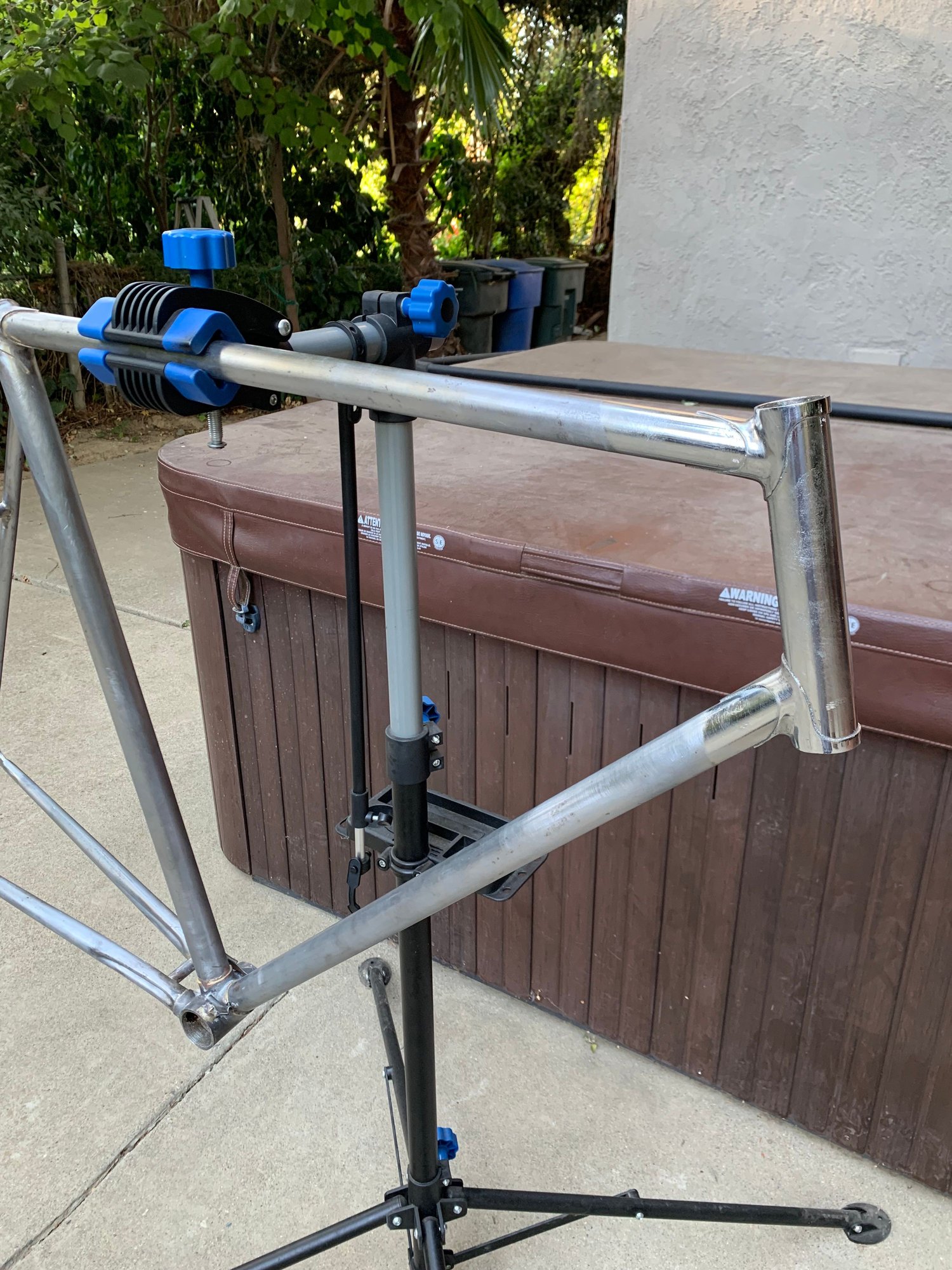

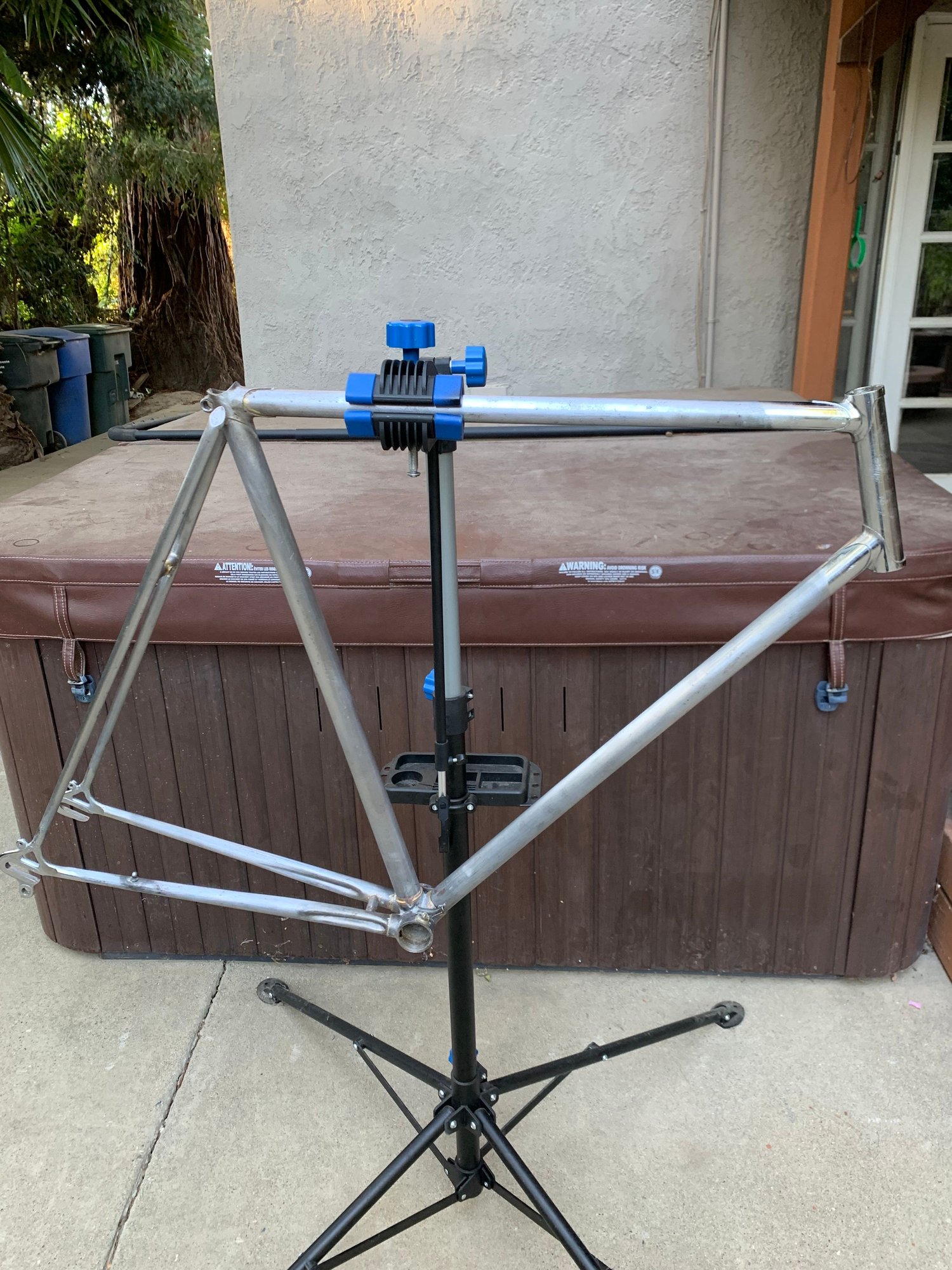

Here it is after I stripped the original paint. The frame cleaned up beautifully! No more rust!!

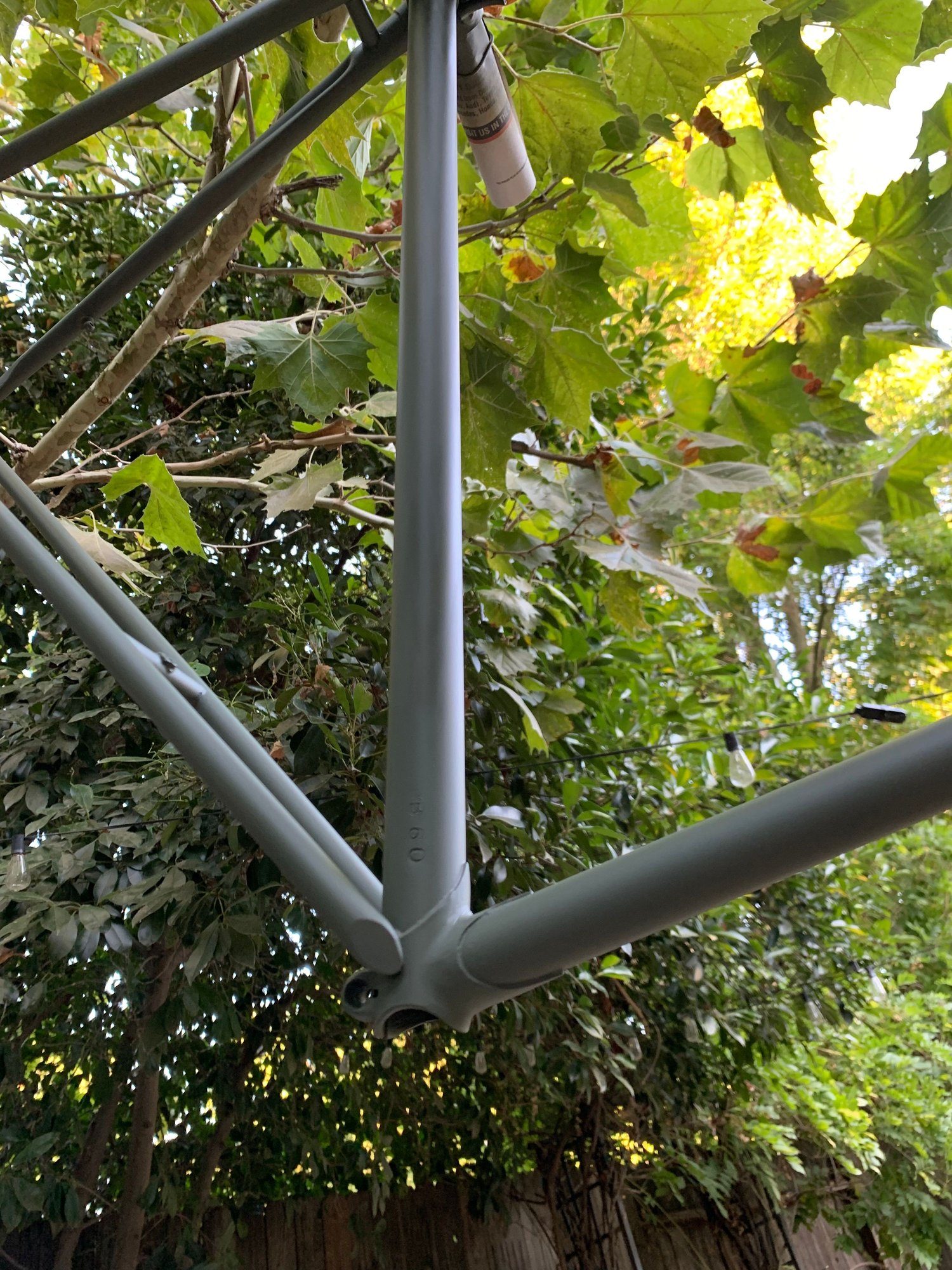

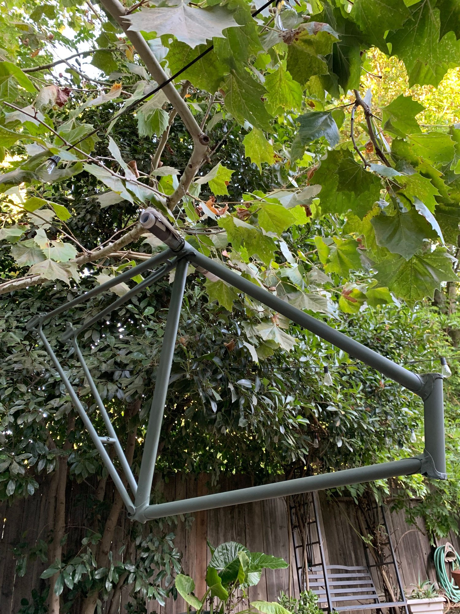

It is now in primer, and I will be putting on its first layer of paint this weekend. I am going with an orange and white paint scheme, and I have purchased the proper decals. More on that later...

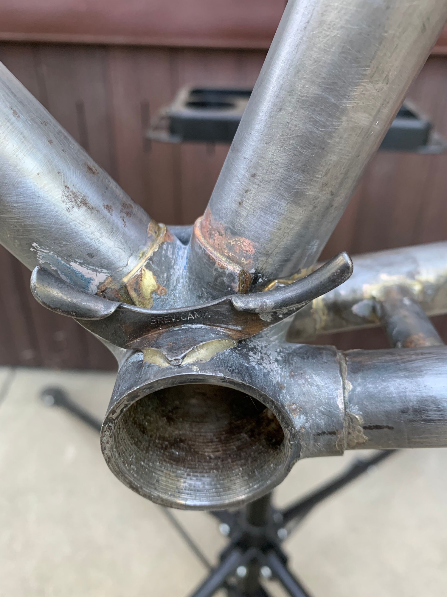

A few more pics of the workmanship on the lugs and Campagnolo bits. Awesome!! As you can see in the pics, the headset lugs and dropouts were originally chromed. I will make sure to keep those elements in the final product. Let me know what you all think!

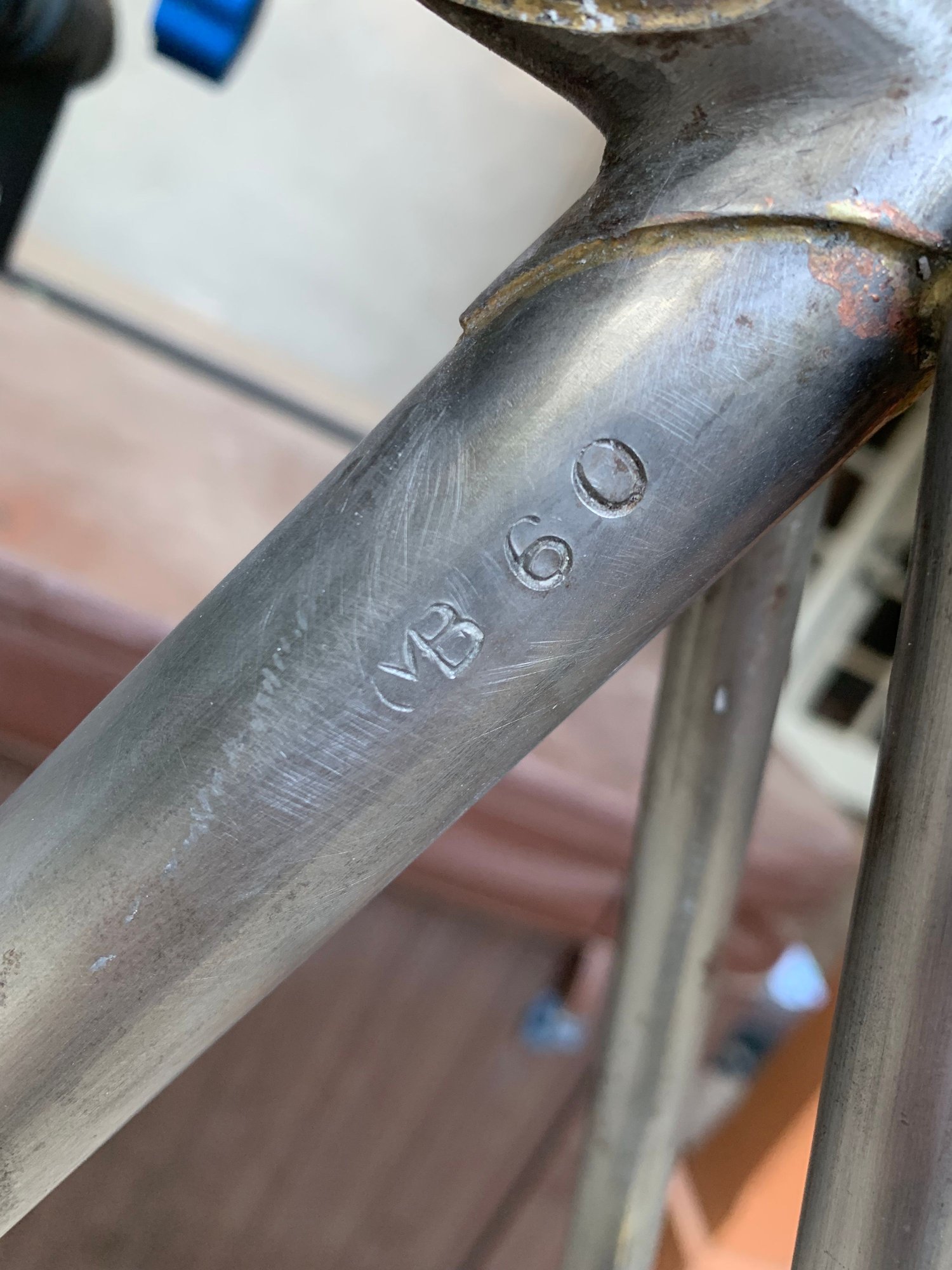

Hi Mad Honk, I will not be making any frame adjustments. It will remain in its original form, frame-wise.
Hi Lascauxcaveman, I see what you did there... But his name was actually Vizzini... My family and I love that film!
Hi juvela, yes, I am excited to complete this project. You can now clearly see the oval MB mark next to the 60 on the seat tube, just how we deduced in my prior thread. Again, I am not going for period correct originality, so please take it easy on me. I will do it justice though - it will look original, and it will be ridden.

Some pics of the frame with primer. I’ll post pics of the first layer of paint in a few days.

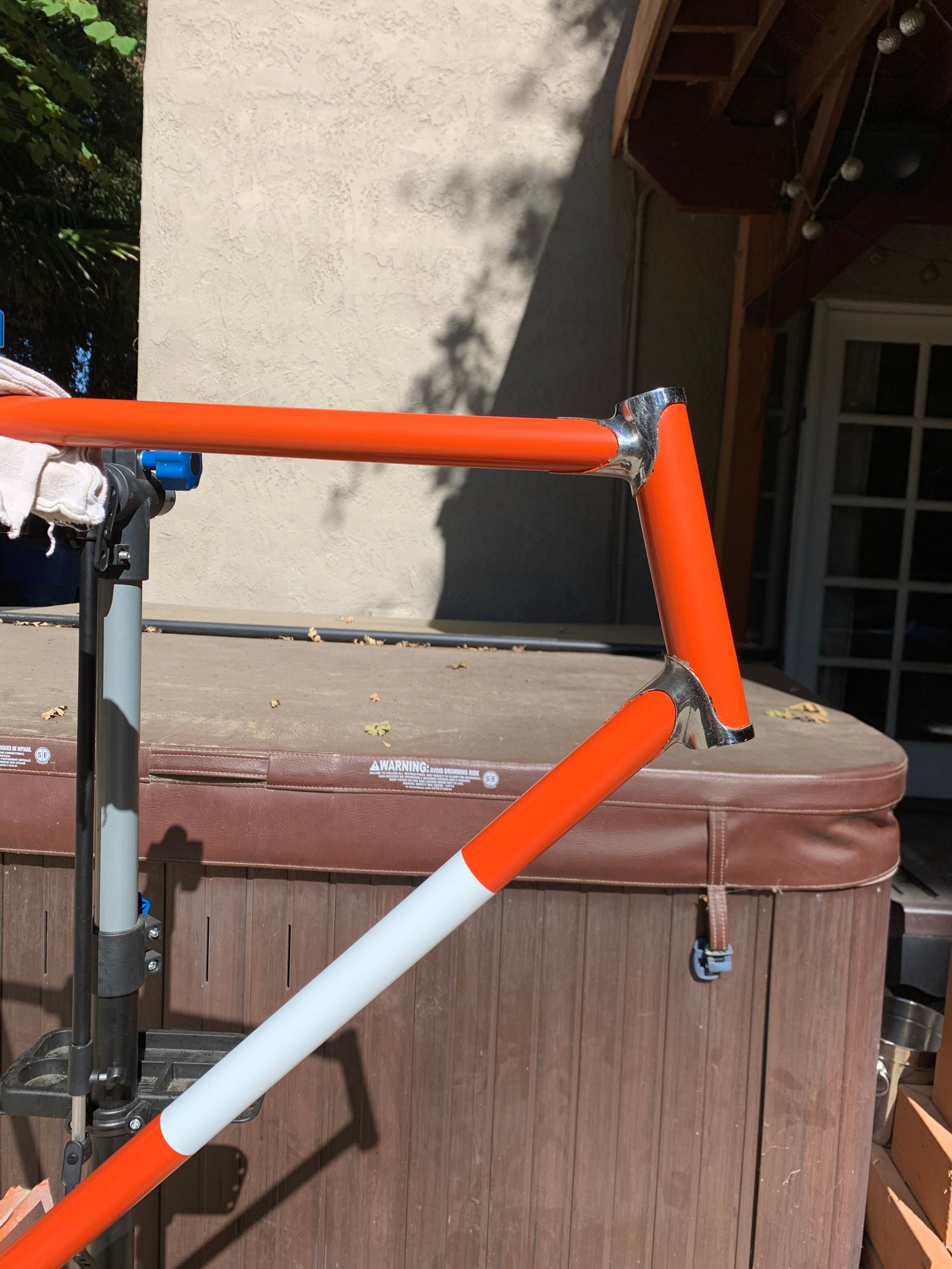

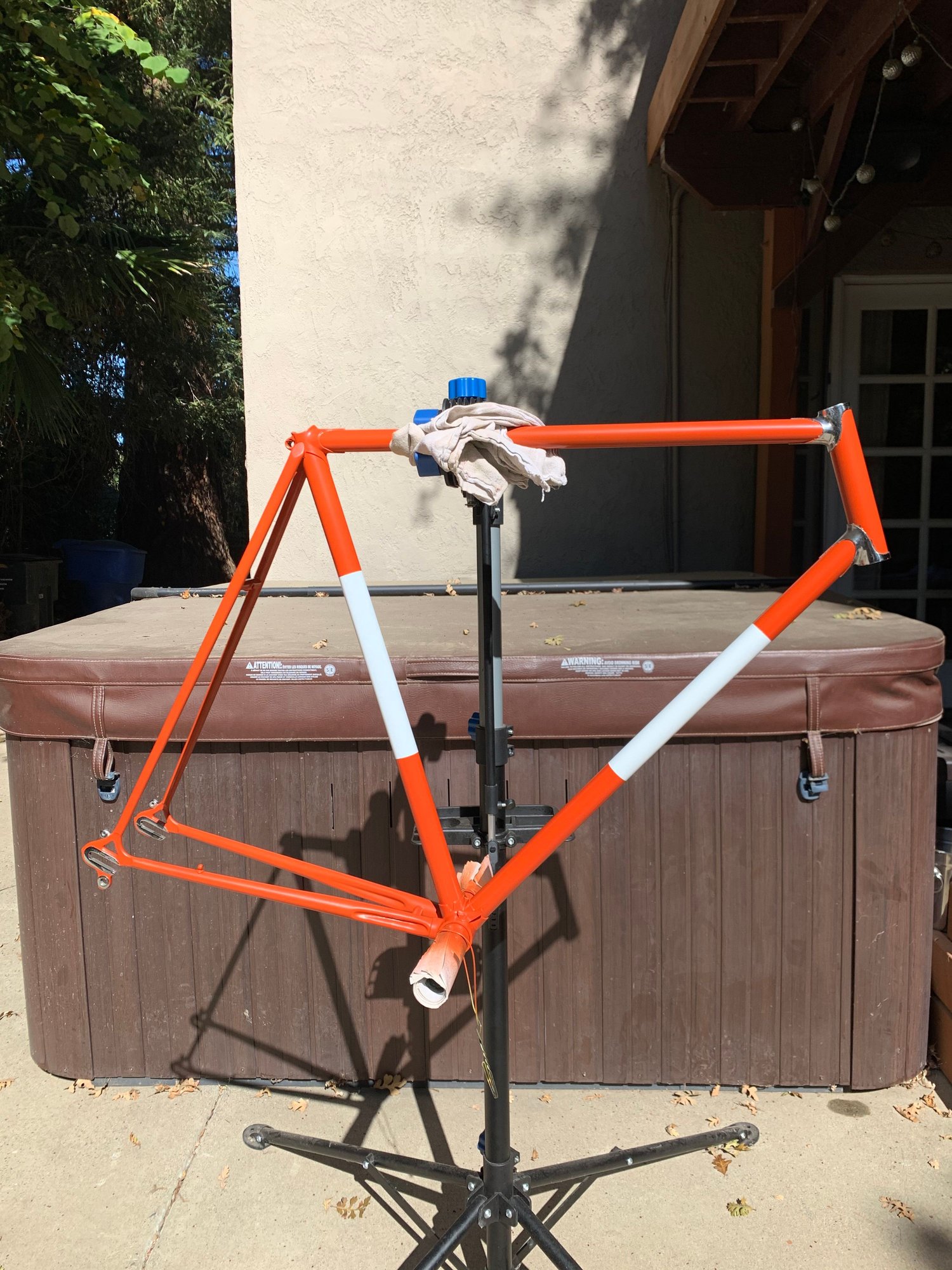

Primer and white sections done. On to orange...

So before BF members point this out, I will come clean on one small error: I taped the white downtube section too low on the tube. I did lay down a thin layer of orange paint already and just today noticed this error on my part. This is a learning experience for me. No worries, I can correct it still. I’m loving the process of spotting and fixing issues as they come up. Pics of fixed & painted frame coming soon.

One minor surgery you might have performed whilst she were yet in bare metal was to reform the seat binder ears.
Their outer faces could be returned to flat by working with a blunt punch from the backside.
Some brass could be floated into the interior by way of reinforcement.
...or perhaps you have done this and it is not visible in the latest images...

Thank you for the suggestions. Actually, it is more in the way the photo is reflecting the light & shadow on the seat binder ears. They are pretty flat and take a binder bolt just fine. I did do some dremel tool work on other parts of the frame (leftover braze material) and sanded it all smooth.
And an update: I fixed my white downtube section over the weekend, so now it sits higher up as it should. I had to sand down some orange paint, respray in white, and readjust the section. I am now on my 3rd coat of orange, with one more coat coming for good measure (with sanding in between every coat). Once the paint cures, decals will go on, and then a clear coat.

Some pics of the frame drying in the rafters. One or two more coats of orange and it will be ready for reassembly.

the orange you selected is an unusual one
it expresses a hint of milkiness and brown
in some angles/lights it almost looks to be vectoring toward coral
expect it would look nice with trim bits in the marrone family
will look forward to seeing how it turns out for you
wish to salute all of the care you are taking

Thanks juvela. I used DupliColor Engine Enamel with Ceramic, in Hemi Orange. And the white is DupliColor Chevrolet White. Here are some recent pics. The chrome lugs & dropouts turned out great.

The combination of the additional coats of colour and the bright sun make it appear "orangier" (word?) than in the last update.
