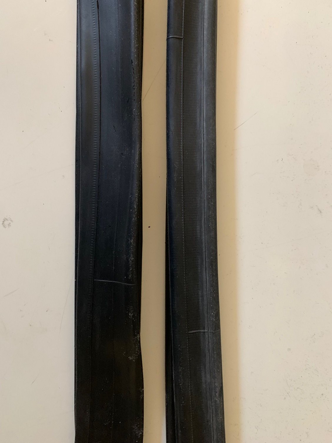

Maybe one day we will learn that 700x18-25 tubes are exactly the same thing as 700x23-28 tubes, just like two week contact lenses are the same as daily disposable contact lenses.

Never inflated, but to be fair I have no idea if they are the same brand (or at least same factory). It has been a long time since I took those out of their boxes and put them in their respective bikes' seat bags. Their stems look identical, but that's all I can tell.
