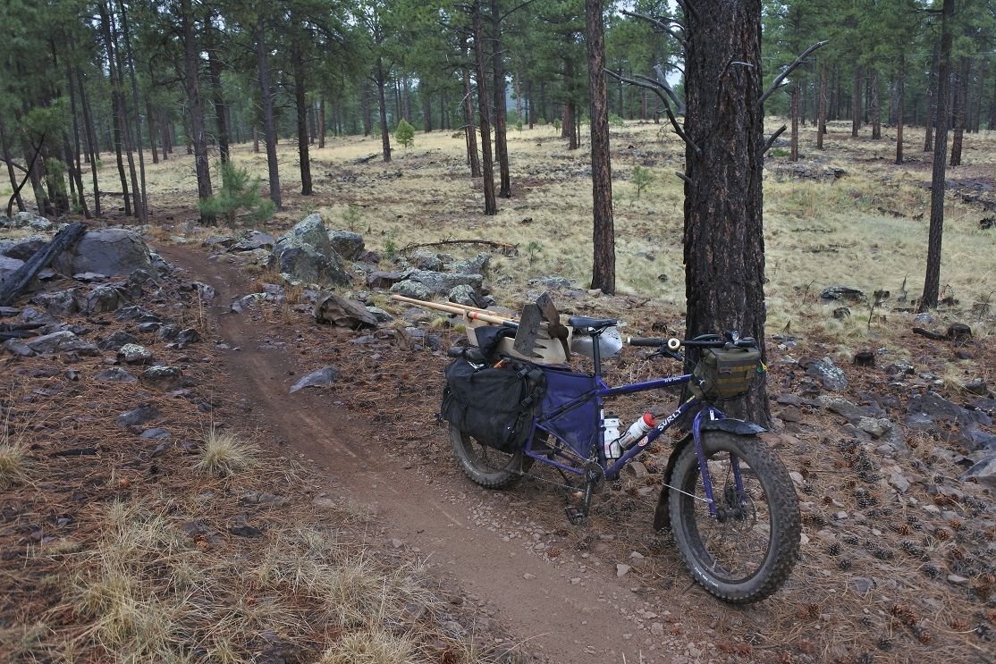

I own both, and ride them both regularly!
I currently have the Big Dummy set up with a 29" front wheel and a 26" rear, both with Schwalbe Big Apples, 2.35". It is more of my "road" cargo bike. It's my around town grocery getter, utility hauler, tourer, and commuter. Before I got the BFD, it also saw plenty of time on dirt, collecting wood, hauling trail tools, and camping. I've had it over 8 years, and it is my most reliable bike.
The BFD is mostly the stock setup from Surly, with Jones H bars replacing the stock bars. It is my off-road RV and trail maintenance tool hauler now, and more and more a fun alternative to a "short" mountain bike if I know I want to take singletrack home from the store. It is also my winter cargo bike. I've had it almost a year, and have yet to have a problem with it yet.
As far as cargo goes, they are almost equally capable. The BFD is noticeably stiffer with heavier loads, I think I would trust it with more weight than the BD. But, we are talking about 150+ pound loads. But, if you load either one poorly, you pay the price with poor handling, just like any bike. If you are looking at hauling loads off road, the BFD adds a lot of peace of mind. The big tires soak up a lot of bump, cushioning you and the cargo. I've found the BFD handles any bumpy trails when loaded better than the BD, though the BD does just fine on smoother gravel, and has seen plenty of singletrack before I got the BFD. Both have been airborne a few times now, though the BFD handles loaded landings better than the BD.
The BD will always roll faster and be less fatiguing, loaded or not, but if you air up the tires on a BFD, it isn't much slower. I typically keep 10PSI front and 15 rear, unless I'm hauling anything heavy. even aired up, the ride is noticeably smoother on the BFD. The BFD has the same "weird" handling characteristics as a normal fatbike, though they are a tad muted by the long wheelbase.
Overall, by the sound of it, and in my opinion, a Big Dummy would do you just fine. It'll easily haul everything you want to carry, it can handle a fair bit of offroad, and it'll last forever if you take care of it. It uses pretty standard parts, and is about 10 pounds lighter. However, keep in mind, you can build a fat wheelset and a 29" wheelset for the BFD, which, combined with a stronger frame, makes it much more versatile. It'll do everything a Big Dummy does, and then some. Fatbike parts are getting more common. Plus, while a Big Dummy gets some attention, the Fat Dummy takes it to a whole new level!
If I had to chose one? I would pick the BFD. If I broke the frame on my Big Dummy, I would probably rebuild it around a BFD frame, with 29" wheels.
Hope that helps!

Bottom bracket height is a tad taller on the BFD than the Big Dummy, which makes sense, considering its intention. Standover height is similar between the two, with the Big Dummy being an XL and the BFD a large. With the exception of the fat tires, and the Big Dummy being set up with a Rohloff, I have them set up similarly, and sometimes can't tell a difference between the two, fit wise. The BFD is set up to take an internal dropper seatpost, which given its taller bottom bracket height, is something I'm considering doing.
The bags and platform/deck sit higher on the BFD by 3 inches or so, and sit further forward in relation to the rear axle by 1.5 inches. So, you lose some stability with a higher center of gravity, but get it back with it being further forward between the wheels. I've had over 30 pounds of trail tools on the deck on single track, and didn't have a problem.
I'm car free, so the BFD sees about 50/50 road and dirt. If I know I'm going to be doing a lot of pavement pounding with it, I'll throw some extra air in the tires, or adjust as I go, as I keep a pump with me. I've found 12-15 PSI front and rear is a reasonable compromise for good dirt traction and reasonable rolling resistance. With the tires up around 18 PSI, it rolls pretty quick and handles sharp, though you lose some traction, float, and suspension compared to lower pressures, just like any fatbike. I will say, it handles dirt better than the Big Dummy, even with the tires pumped up hard, and it does even better with some weight on the back wheel! I've actually gotten so used to riding the BFD on dirt, I have a hard time going back to a "normal" mountain bike.
Yeah, if I had to choose just one, even if I were doing mostly pavement I would have to pick the BFD, as I feel it's a more versatile, stronger frame. (My Big Dummy is an older one, but I've ridden a new style with a load, it doesn't feel much different.) But I've got some sentimental attachment to the Big Dummy, and won't let it go, and it makes a great roadie cargo bike.
