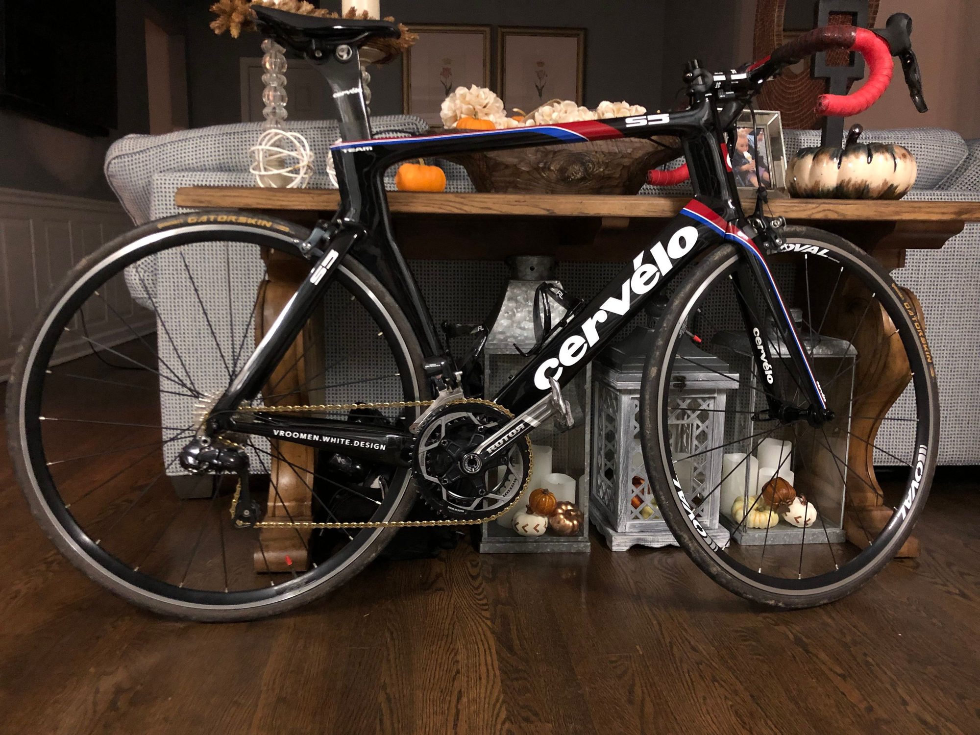

Hi -
I've been searching around but haven't found any conclusive information. Maybe I'm looking in the wrong places?
Everyone claims that Conti tires run large. Additionally, I own a 2012 S5 which all owners will know was made for 23 width tires.
However, I am currently running 25mm Gatorskins on them. They're old and worn, but they fit perfect. No rubbing (anymore). I also have brand new cheap Conti Ultrasports in a 23 that I use on the trainer, and those don't even come remotely close to rubbing.
Are GP4000s a good amount taller than Gators? Definitely don't want another set of lead tires.

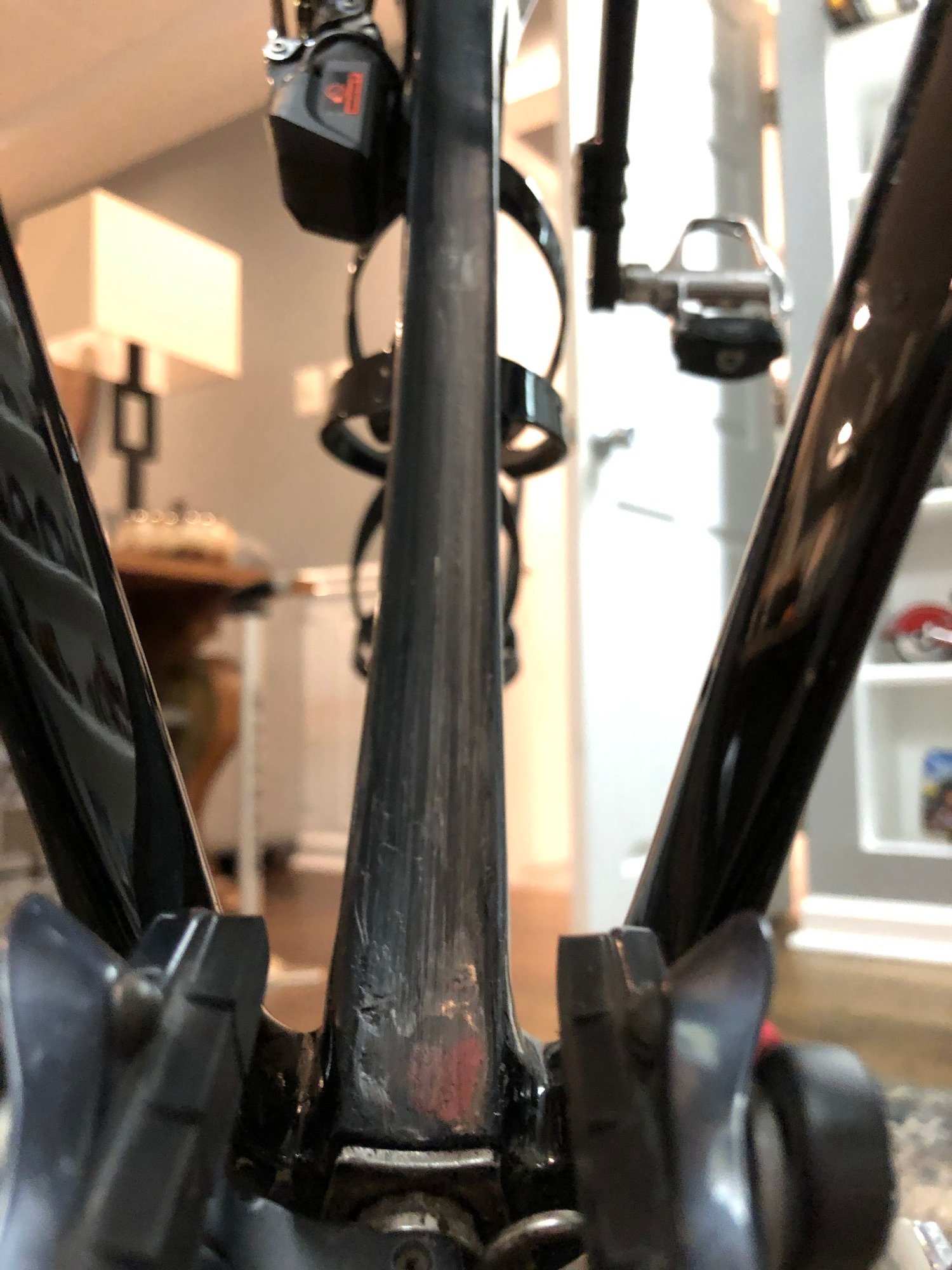

Wow....that is close!

Decided to just give it a shot. GP4000s are most definitely taller than Gatorskins. I tried the 25mm and they would have fit, but it was even closer than this. Way too close for my liking. I got 23mm's instead, since they'll fit more like a 25mm anyway.

uh are those chunks of CF missing from the seat stay?

Figured someone would mention it. Yeah, probably. Its fine. The inner arches get chewed up all the time. At least if they actually get ridden.
