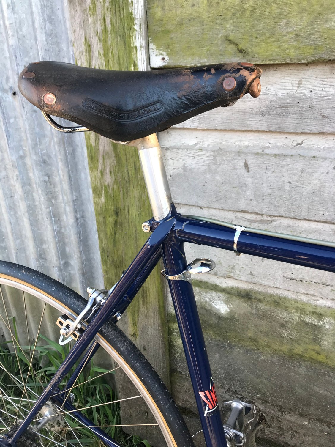

no touch ups coming and the seat looks more ragged than it is, so I will keep treating it, but not add more color back into it.
there are lots of pretty Singers out there, so I will keep the old scars on this one, especially since it was literally rescued from the garbage and that is a significant part of the history of the bike. I took the rusty chrome off as it was functionally lacking and possibly had structural issues as well.
Sounds good, I get it, great rescue.

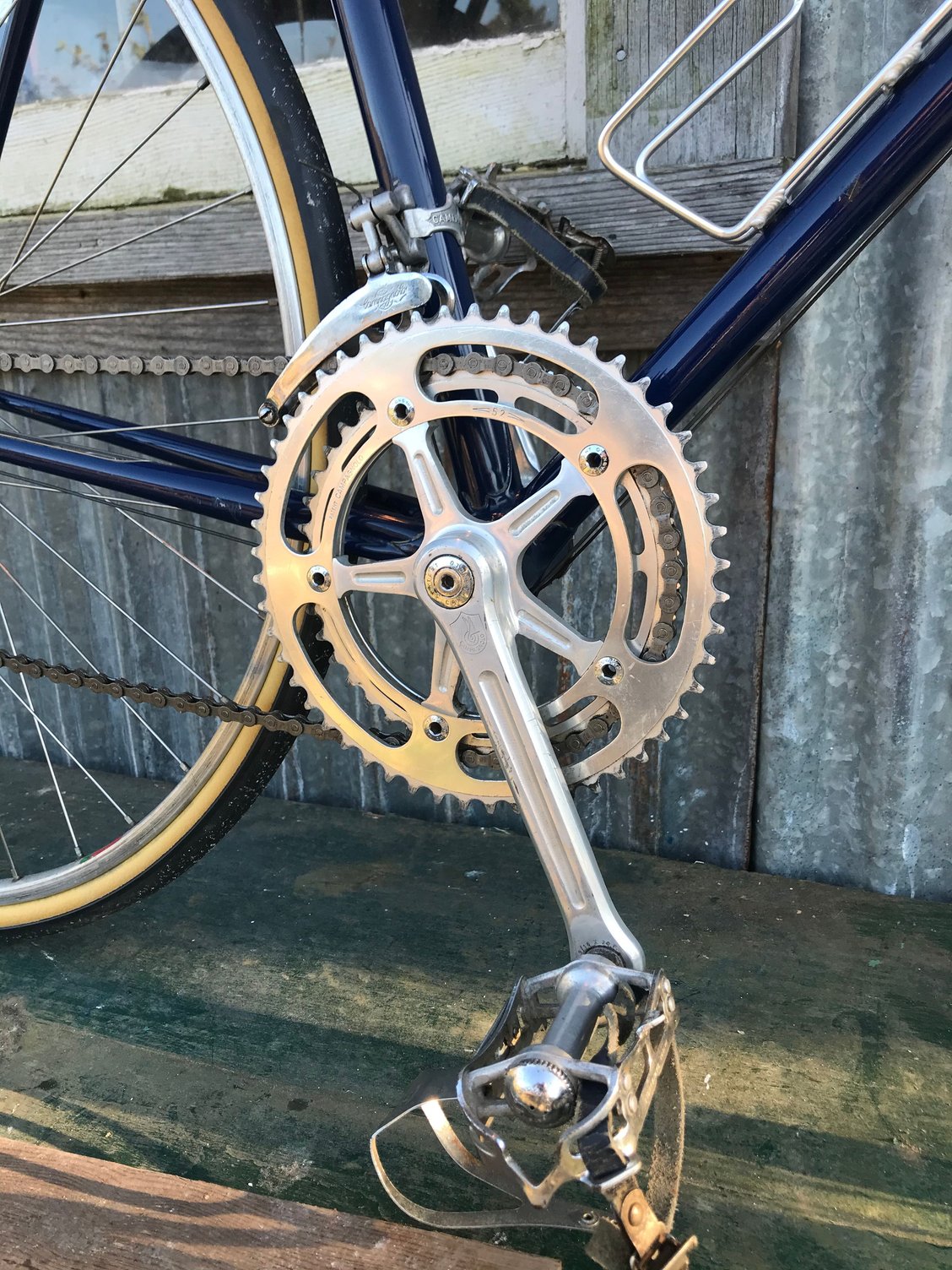

I love it!
But better check your rear derailleur, the chain is not on the first pulley!
bumped off during photos, but already back on!😊

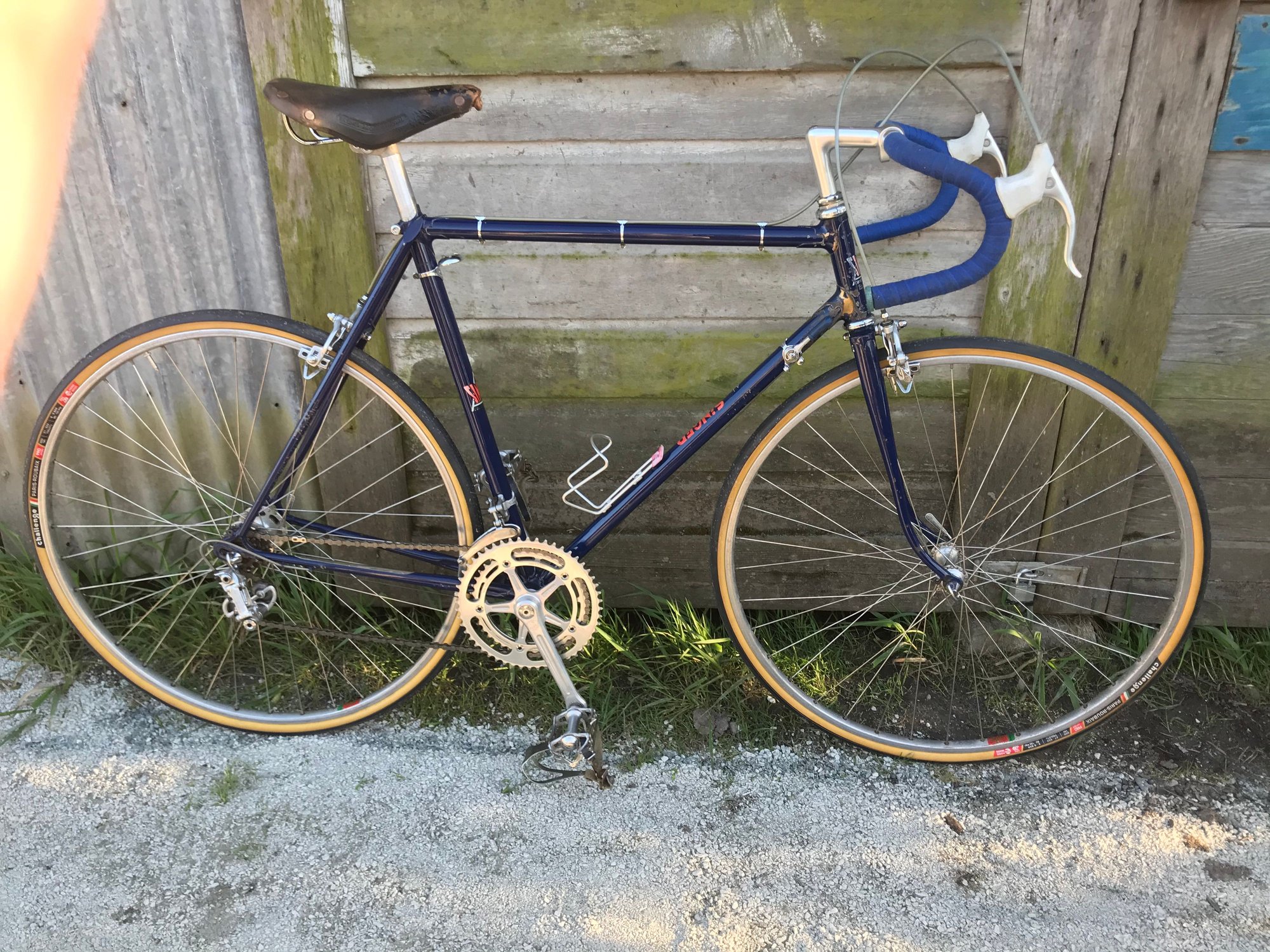

Update:
I have this now done to where I want it. Totally broken down, rubbed out, waxed and then rebuilt. I replaced the rustiest Campagnolo bits, added better tires, new bar tape and called it good. I even kept the original cable housing. The frame is 1976, so the hoods are probably from the 1980’s, but I left them alone.
It looks great! I really appreciate your approach to leaving imperfections as a testament to the history of the bike. How's it ride?

The bike looks great. It looks fast, too. Is it? What's it weigh, just for grins? Or maybe I missed that.

Great questions! I don't know a lot about constucteur bikes, but some of the reported weights were surprisingly low for vintage bikes. wawine , are you able to report on this?

I have not put it on the scale, but surprisingly, it doesn’t feel all that light. However, it may be the wheels. I am used to tubs and these are clinchers with Paris Roubaix 27’s

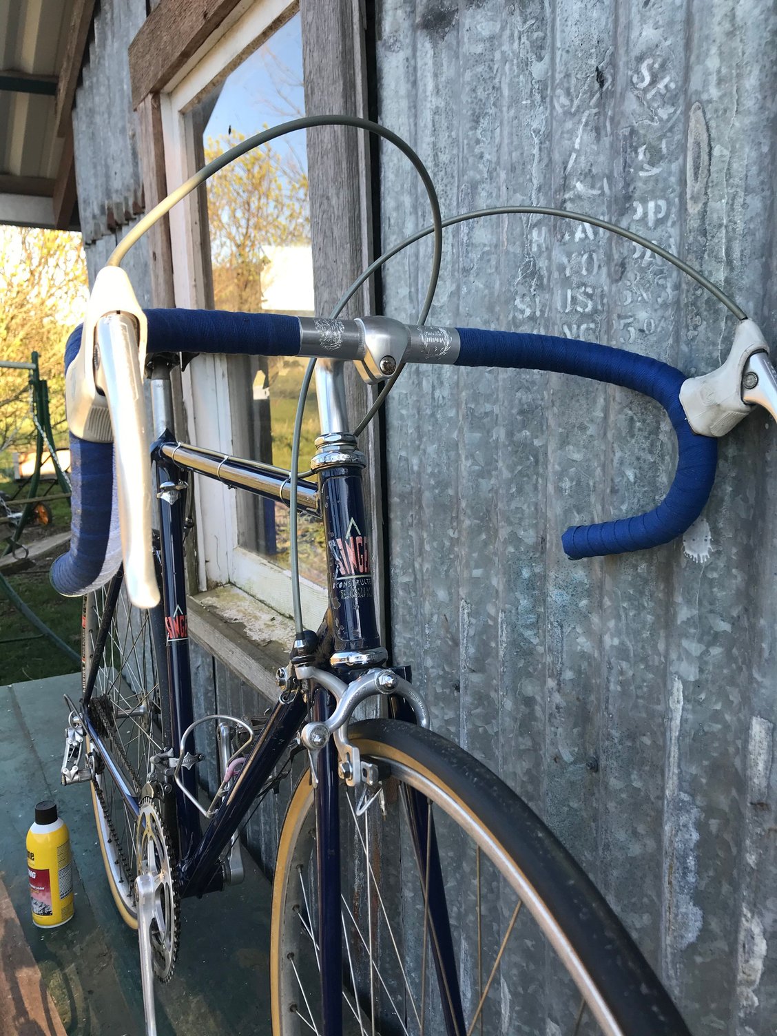

Clinchers add mass. No question.
I will be contrarian, the bike appears well, needs fenders.
look at the room under the front brake caliper, the position of the brake blocks.
Fenders.
I have seen mid 70's Singer race bikes, this is not.
Heck, you are in a region where fenders are even sensible.

Ok, Olivier was not running the show 45+ years ago though.
Look at the position of the brake pads on the front brake, the room above the tire, which is not a typical 22-23mm race tire of the 1970's,

The paint damage around the head lugs showing filleted brass raises a question I am curious about. Can someone more familiar with Singers tell me if the lugs on this frame were made from 2 pieces of tube and filleted together? Or was the brass added to smooth out the curve between the 2 sockets of an already made lug?
Pretty sure Singer did both at different times, so hard to tell without a hacksaw.

I see repechage point about the fenders. While it wasn't the fashion to put fenders on race bikes in the US, the 700C "Sportif" with fenders was a common style in France. A competition bike designed for long rides where weather is unpredictable and comfort is somewhat important. Still considered a race bike but designed for more than just crits.
The fender mounting braze-ons on the bike indicate it was designed to be able to take fenders.
just about every bike ever made with Campagnolo 1010A dropouts at that time, had fender eyelets, as they were part of the forging itself. If a frame maker had these in his shop, he would have to take them off, but why would you? Down the road, someone may want to put fenders on the bike. However, the presence of these, doesn’t mean the bike was intended for fenders at the time it was sold.
Seattle frame builder Angel Rodriguez, who had worked at Singer before this frame was made, ordered this in 1976 for likely a well heeled client. As confirmed by Olivier, who likely actually brazed this frame, it was built as a racing frame, for the US market, where Campagnolo was the rage, and shipped bare.
If Angel, who had worked at Singer, wanted the classic French style Singer with fenders, he would have ordered it that way. Instead, this is an ‘Italian’ style frame, with Campagnolo dropouts, Campagnolo cable clips on the top tube, a peg on the down tube to lock into Campagnolo band on shifters, with the intent to build an entirely Campagnolo racing bike for the US market.
When found, this is exactly as it was, with no fenders. In the US in those days, nobody used fenders on racing bikes and many didn’t on touring bikes either. I have a 1971 Cinelli with full Spence Wolf Alpine components, with the original receipt, from the original owner. It has these same dropouts but was never fitted with fenders. My 1971 Masi has these dropouts, was sold new in Vancouver but never had fenders. There are lots of stories about Cinellis being delivered to the US in the 1960’s with fenders, and the first thing that happened, was that they were discarded.
Olivier at Singer shipped a bare ‘racing’ frame to a former worker at the shop, with no fenders, to be built up with Campagnolo when it arrived. This has been confirmed directly from him.
I find the bike, 40+ years later, built exactly this way, with no indication it was ever built any other way, and no fenders were ever mounted.
For some reason, people want to continue to keep telling me it is not built ‘correctly’.
WTF?

You can bet that if a Singer left the shop with fender eyelets, it was designed and tested to be able to have a fender mounted. The fact that your Raleigh can't mount fenders despite having braze-ons is more of a reflection of bike-boom Raleigh's poor design and quality control. It's a little silly to try to argue that it's good practice to add a fender braze-ons but make it impractical or impossible for the rider to use them.
Check out the pictures posted of the bike. Look at the gap between the fork crown and front tire. Look at the fact that the brake posts are at the bottom of their adjustment to reach the rims. As @repechage already mentioned, the clearances are clearly designed to allow use of a fender. Whether the owner adds the fenders or not is their choice. But to argue that the bike was 100% intended to go fenderless by the builder is clearly wrong considering the frame's features.
