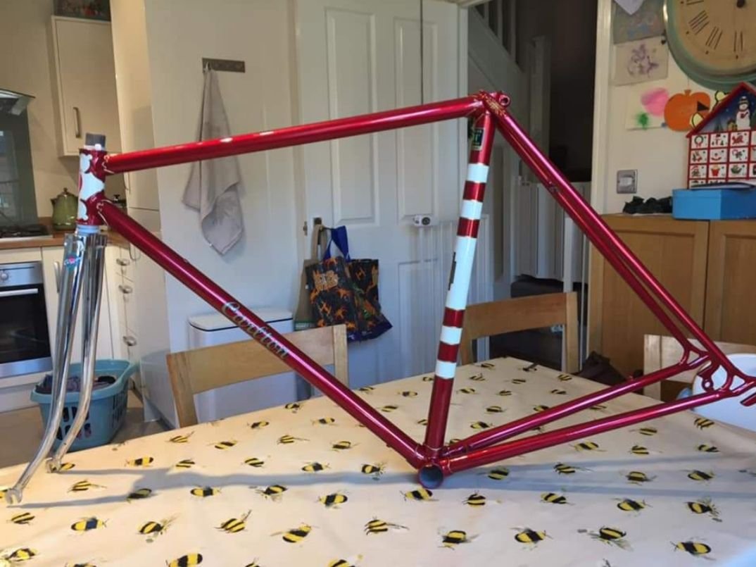

I peruse the "Carlton Cycles of Worksop" facebook group. Whoever is doing the Carlton refurbs in England does top notch work.
