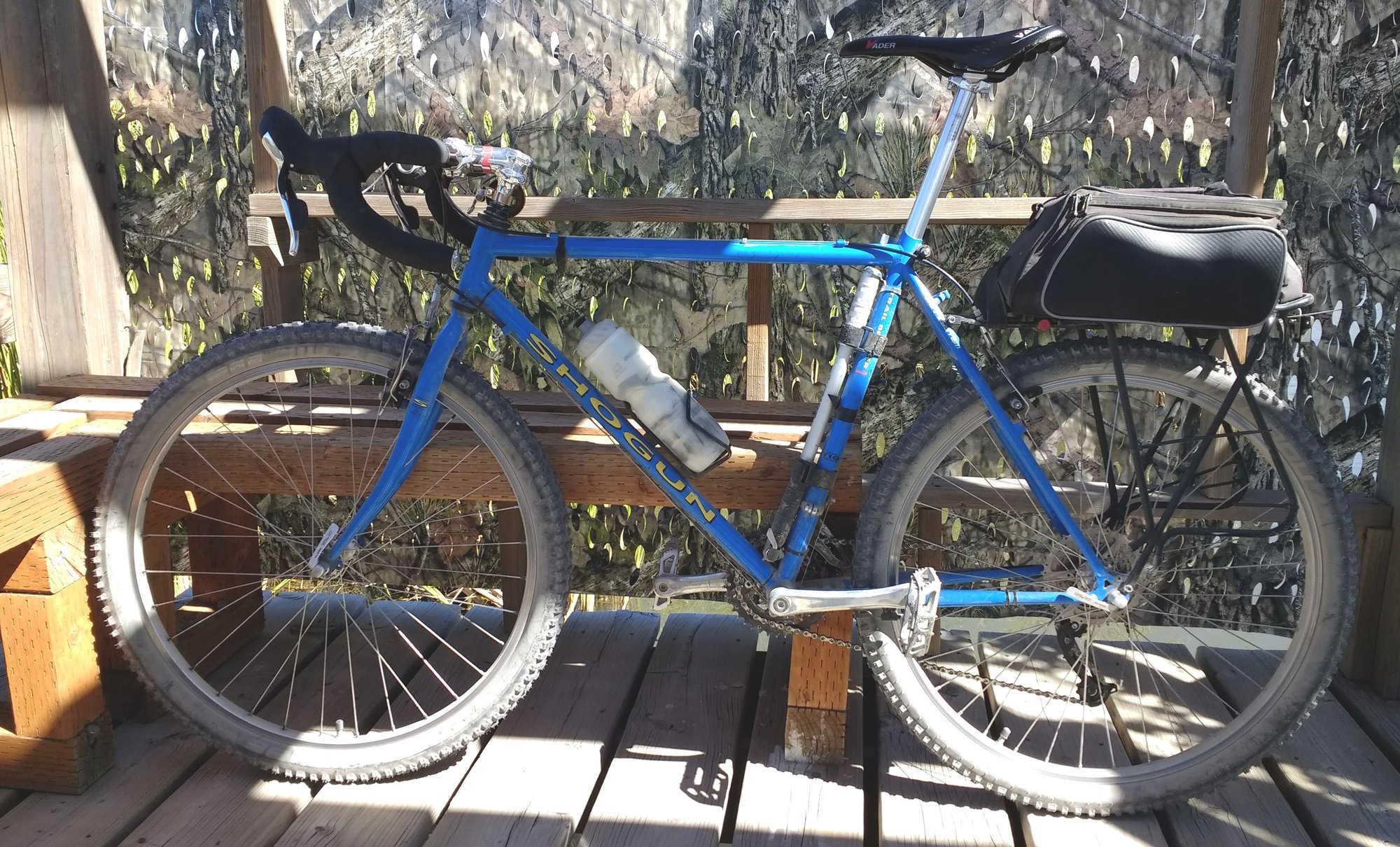

I've done the same thing. Eventually I discovered the love of extreme bar drop. Now Iove having my bars 170mm below the saddle. I would have never believed this could be comfortable until I tried it with what I then considered a too-small frame. I had this small framed bike and just experimented with increasing bar drop after I saw professional cyclists who ride all day every day in this radically aero position. I shocked to discover how much I love it. It's counter-intuitive but lowering the bars relieves pressure on my arms and hands. Previously I was having discomfort from shoulder, neck, and back pain, hand and arm numbness.
I believe that bicycle fit is often a psychological hurdle. People just have erroneous beliefs about what positions can be comfortable, and that riding upright is somehow better than riding aero. I'm sure my setup looks torturous to other people, but to me it feels terrific.
Even my mountain bike has to be set up this way. I've quit tweaking my riding position after doing this.

That's a rad MTB setup. Why not use MTB bars and shifters?
I agree with the drop issue. I run slammed -17° stems and wish my legs were longer so I'd have more drop. So much more comfortable to have lots of drop.

If you had pain and numbness in your hands/arm, it sounds a lot more like the problem was/is the saddle being too far forward. (In the photo, it appears the tip of saddle is only 2-3cm behind BB. My hands/arms would be a wreck in that position, too!)
You're right. I have put a shorter stem on and moved by saddle backward since this photo was taken. Setback is around 70mm now.
I just prefer drop bars. Having my wrists parallel to the frame is more comfortable, and the extra drop is fantastic on steep climbs, or when riding long distance at fast speed on the flats. This bike was inspired by Jackie Phelan and John Tomac who pioneered professional racing drop-bar mountain bikes.
Initially I had bar-end shifters but I kept bumping them with my knees. I've been pleased with these Microshift brifters but people with small hands tend to dislike them because they require a long distance sideways throw for shifts.
