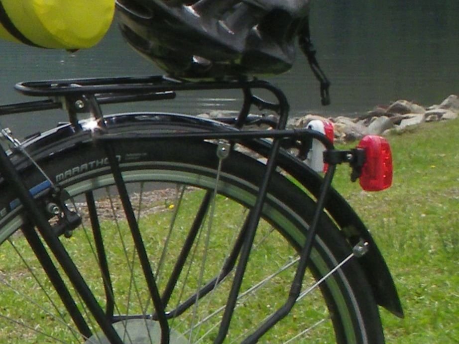

Logo is a good rack, but do not start welding on it because I think it was heat treated.
Planet Bike Superflash light comes with a seat stay mount bracket that is smaller diameter than the seatpost bracket. I also wrapped a bit of inner tube rubber strip around the rack before I put the bracket on the rack as the seatstay bracket was a bit bigger than the Logo tubing diameter. In the photo I have two taillight, one is not a Planet Bike, but I am mainly focusing on the light mounts with this photo.
Planet Bike makes several different lights that have the name Superflash, I suggest the plain Superflash or the Stealth version.
https://www.planetbike.com/store/sup...ight-1066.html
These lights have a very bright but very focused light to the rear, they put almost all the light directly behind you. But some of their other models are not that tightly focused, that is why I am specifically recommending that one light. That is an advantage but it is also a disadvantage that your light has to be carefully aimed straight back to be effective. I prefer lights that take AAA batteries, thus my recommendation has that bias. I use NiMH batteries in it.
The logo can also be used to mount a taillight that uses the standard 50mm bolt spacing if you want one taillight in the center.

Four of the touring bikes in our family have the Superflash rear lights. Planet Bike sells an adapter with 50 mm bolt spacing for the Superflash. It fits our Tubus Cargo Classic and Evo rear racks.
This wouldnt work for a trip because my rackpack would be in the way, but then Ive never taken a rear flasher on a trip before because I never (well, nearly never) ride at night. I do have a reflector on the rear rack mount thing, and the panniers reflect, but its good to know this adapter is available.
