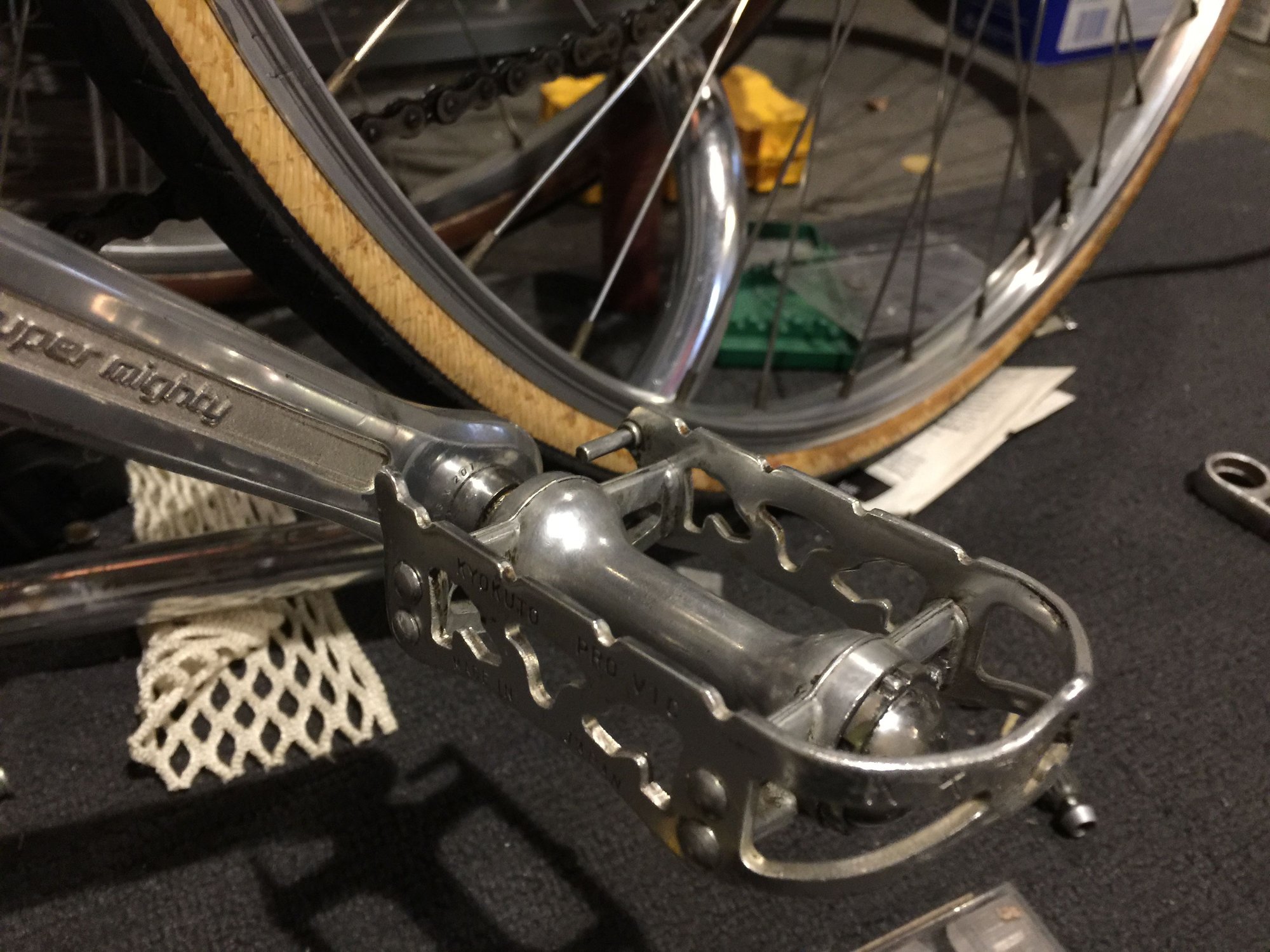

Here's thepedals Iput on my Nishiki, the Kyokuto Pro Vic. These were a pick up from an Austro Daimler last summer.

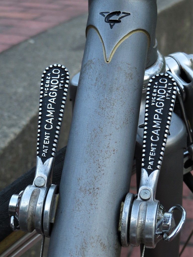

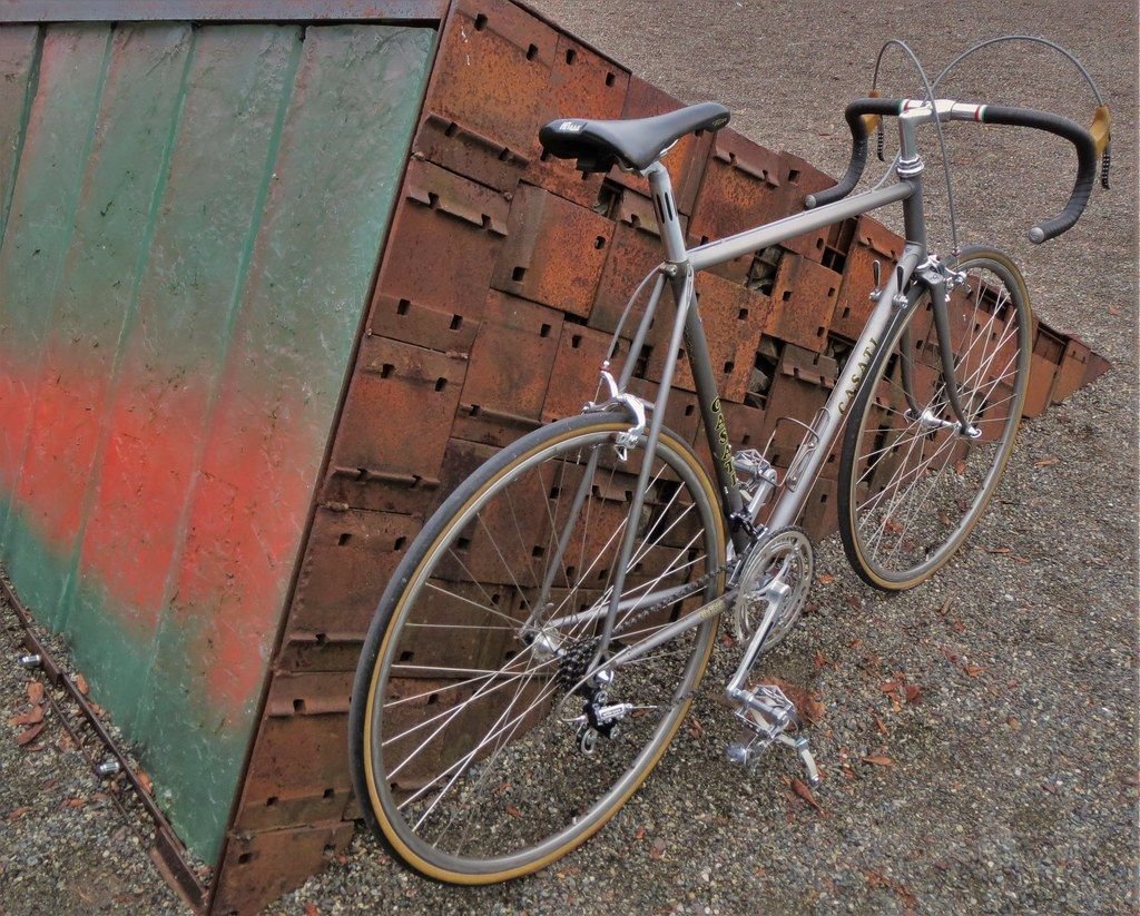

My "new" camera arrived at my building on Sunday but I didn't find out about it until today. And today was dry! So, ride and pictures were both on the agenda today.
Downtown Redmond:
I never knew this sculpture had a lighting feature:
I used to use Flites exclusively. Sold them all off bar one, and I decided to give it a go today. Pleasantly surprised at the comfort, so it may stay:

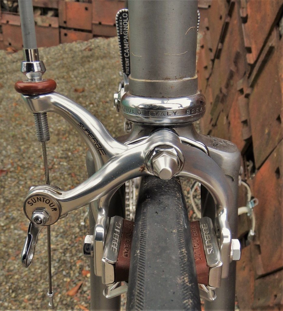

Superbe brakes worked well, good feel, but maybe a little more flexible than their Campy counterpart:
Beautifully-made Superbe caliper:

Suntour Cyclone rear derailleur. I'd cleaned up a small scratched area at the upper pivot, but I see my Sharpie touch-up didn't hold up to handling the derailleur during installation. I'll add some Tamiya semi-gloss black acrylic paint to give it some more longevity:
Super-clean, both front and rear. Both worked well, and if I were to compare, the rear shifted a bit quicker since I didn't have to overshift that little bit as per normal with a Campy NR or SR. But really, not so's one would notice. It works well, as do both Campy units. Perfectly happy with the performance of all my drivetrains, this one included:
After over a year riding this bike with only a thin, matte clearcoat finish, there are some small rust blooms taking shape on the top of the BB shell and along the top/bottom of the chainstays, too. I like the look and hope it keeps going:
Light rust blooming on the fork legs, too. Campy hubs with curved track QR levers:
Yup, Campy shift levers moving Suntour derailleurs. Just like back in the day!
Another beautiful Superbe caliper graces the front of the bike:
Suntour calipers operated by Campy levers:

Shout out to jreeves for the Elph camera with which I shot these photos - thanks! Finally, a camera that works as it should with no glitches, at a very nice price
Also thanks to WGB for the derailleur set and shnibop for the crankset. In a weird twist, the camera, front and rear derailleur set and the crankset all cost the same amount of money, although they came from three different Forum-ites
For now, the bike is in it's definitive form until the Sugino Mighty crankset arrives and is re-threaded. I'll then swap the Barellis over to that crank, mount it and give it a whirl. I'll leave the Campy BB in - I don't think that will matter one way or the other. I only did a quick 25 miles to determine that everything is functional (the brakes squeal a bit, so I need to sandpaper the blocks a little tonight to start the quieting process...), and it is. I can't really say it's any more/less fun now than in its previous guise. I know the controversial bit will be the 3-arm crankset, and okay, it doesn't really "go with" the bike, but why not? In use, it's plenty stiff enough - I came out of the saddle for a few jumps and the drivetrain went immediately to work, no flex in the crank, just power to the rear wheel. It felt very sprightly in the 42/15 combo, just sprinting away from a dead stop. I could leave this setup as it is and be perfectly happy.
But I am hoping to hear back from another forum member who got in touch with me about long- and medium-cage Cyclone derailleurs. I've been thinking down the road about expanding this bike's gearing. He has derailleurs and a few freewheels that might just fit the bill.

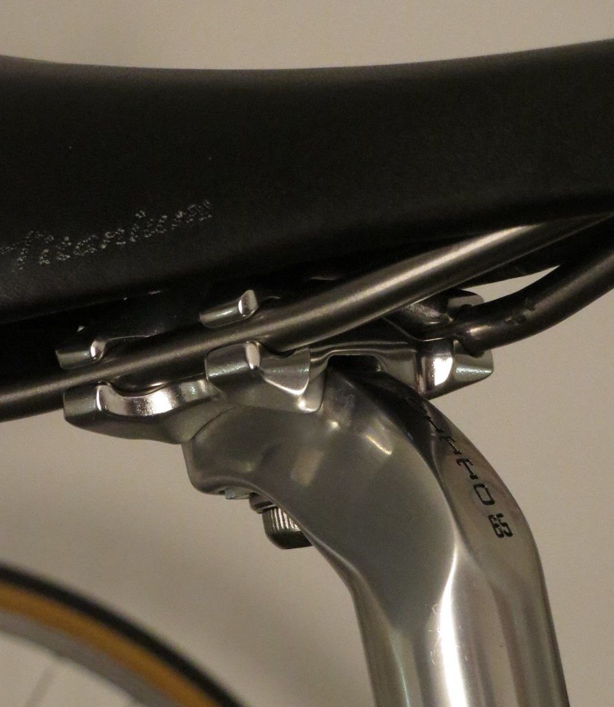

I got the Nitto S-65 on Saturday and installed it Sunday. Hopefully riding tomorrow; the rain has stopped, just waiting for the stuff already on the ground to dry up.
A few pics. The post is absolutely beautiful with a nice satin finish on the shaft and very cleanly finished cradles on top. Hard to believe this was less than $50 shipped:
Saddle is very clean. So far it agrees with my posterior over 25 miles of pavement:
Such a shame to leave beautiful workmanship like this hidden away under a coat of paint!

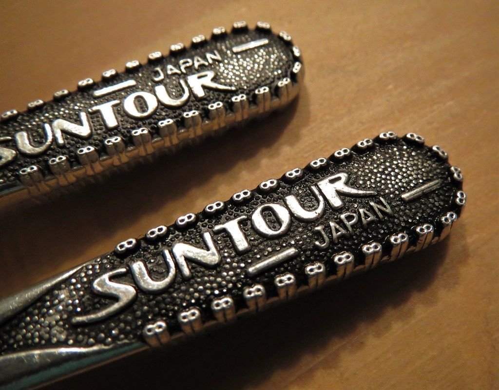

Slowly but surely, the march of new parts continues:
These are about 1/4" longer than Campy's levers, and are a bit bulkier around the pivot as well, but don't they look cool? I found these the other day and fell instantly in love with that old school logo! I did a dab of distressing tonight with some decanted Tamiya spray and a small sponge. The lettering really pops now:
Does anybody else see a chain? That has to be deliberate

I've never seen those shift levers before, and I like them very much. That lettering, and the detail around the edge are excellent. Is there a Cyclone or Superbe out there with lettering to match?

I'm jealous. What does "distressing ... with some decanted Tamiya spray" mean? Sounds like some sort of cocktail.
I normally personalize my bikes by painting in component features like fluting and engravings with a highlight color. In the case of the Casati, it's black. I build models in my other hobby and have a lot of Tamiya paints for that. I get a great consistency out of this paint from spraying some of it into a cup and letting it gas off for a couple minutes before using it with a paintbrush or toothpick. The gear levers in the pic used to be bare alloy; I added the black, then distressed it by rubbing some of the paint away with a bit of sponge during the drying process.
Similar treatment (though not distressed) on the Campy levers this Suntour pair will replace:
Aren't they cool? There are a number of them on Ebay right now, in various stages of completeness. They seem to go pretty cheap - these were only $3! And yeah, the detail on them is what got me, too. They didn't come with any hardware, but I suspected that Campy nylon washers and such would fit and sure enough, they do. ID of the lever pivot is perfect for a Campy braze-on boss. I'll mount them with Campy hardware
Thanks again for the S-65 suggestion. It really looks the part; hopefully that clamp holds pretty tight!
