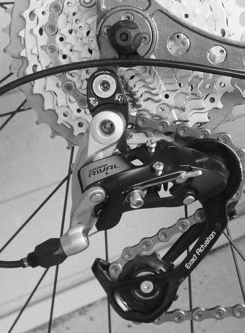

Big cog capacity has to do with where the top pulley sits relative to the cassette. I just checked the specs on that particular derailleur,. It's only rated for a 36t big cog. I'm thinking you are going to need a Wolf Tooth or something similar to space the derailleur away from that 42 cog.

With a 10 speed Sram RD you most likely won't have a problem running a 11-42, Shimano is the one that is iffy. I have a 10 speed Sram bike setup with a Sunrace 11-42 right now which I did no modifications too.

Are any of the 10 speed RDs rated to handle a 42? I'm not going to look up specs but I don't think so. The one I'm running is an old as dirt X0 non-clutched mountain 10 speed which I'm am 99% sure is rated to max out at 36. Again the Sram 10 speed mountain RDs will generally work fine rated for it or not with a 42. Generally doesn't mean always it means most of the time. OP won't know for sure though until OP tries it. If OP is one of the really unlucky few that it won't work for then you can always go the roadlink route.
